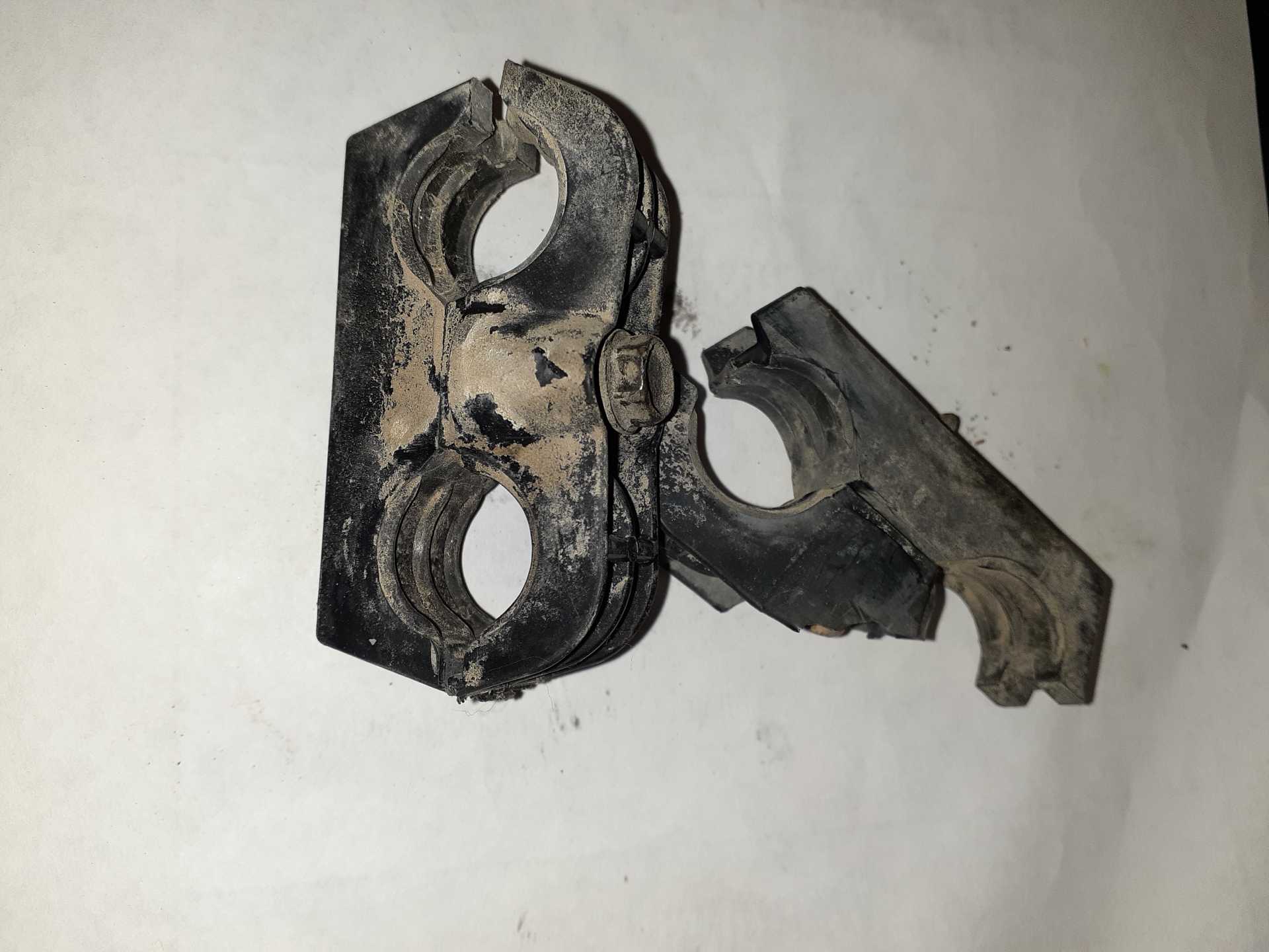

 Any one know where I can get new ones? They are the heater tube mounting brackets. Thanks Daryl
Will
JUL 10, 04:08 PM
I'd love to know the PN... But there are any number of dual tube clamps on the market.

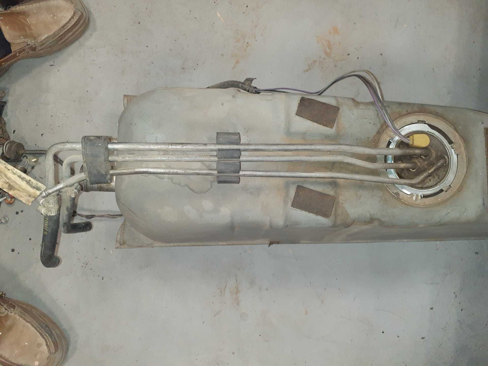

 Time for the stupid question of the day, from top to bottom in this photo, which hose connections are for what? I am assuming they are fuel feed to engine, fuel return to tank , and vent, although not necessarily in that order. Thanks, Daryl
fieroguru
JUL 12, 01:06 PM
Large (3/8") is fuel supply to filter. Medium (5/16") is fuel return from fuel rail Small (1/4") is the vent tube to expansion or charcoal canister.

The double clamp is the fuel line single clamped hose is return the one without a hose is your vent. I just did a fuel pump on my car and drove it for the first time since September. I am sooo happy.
