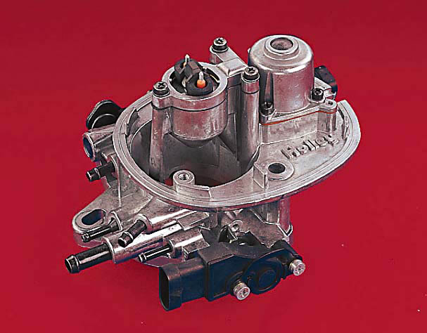

| quote | Originally posted by Yellow-88: Would cooler fuel increase the rate of evaporative cooling? Or maybe just cool the body a bit? At what point along the air flow is the fuel injected on the TBI? Is there a venturi in it? I forgot.
Well, every liquid transfers heat. Obviously not the transfer of coldness, but the shedding of heat. The injector on the TBI Fieros sits directly above the throttle body, and injects directly into it vertically as the air passes around it.
This is a picture of a Holley TBI replacement unit for the 2.5 Fiero (and CFI F-bodies and Corvettes). It's 95% identical to the stock one in the Fiero, it just has a larger bore and throttle plate. Otherwise, it's intentionally designed to be identical. It was just the first image that came up.
