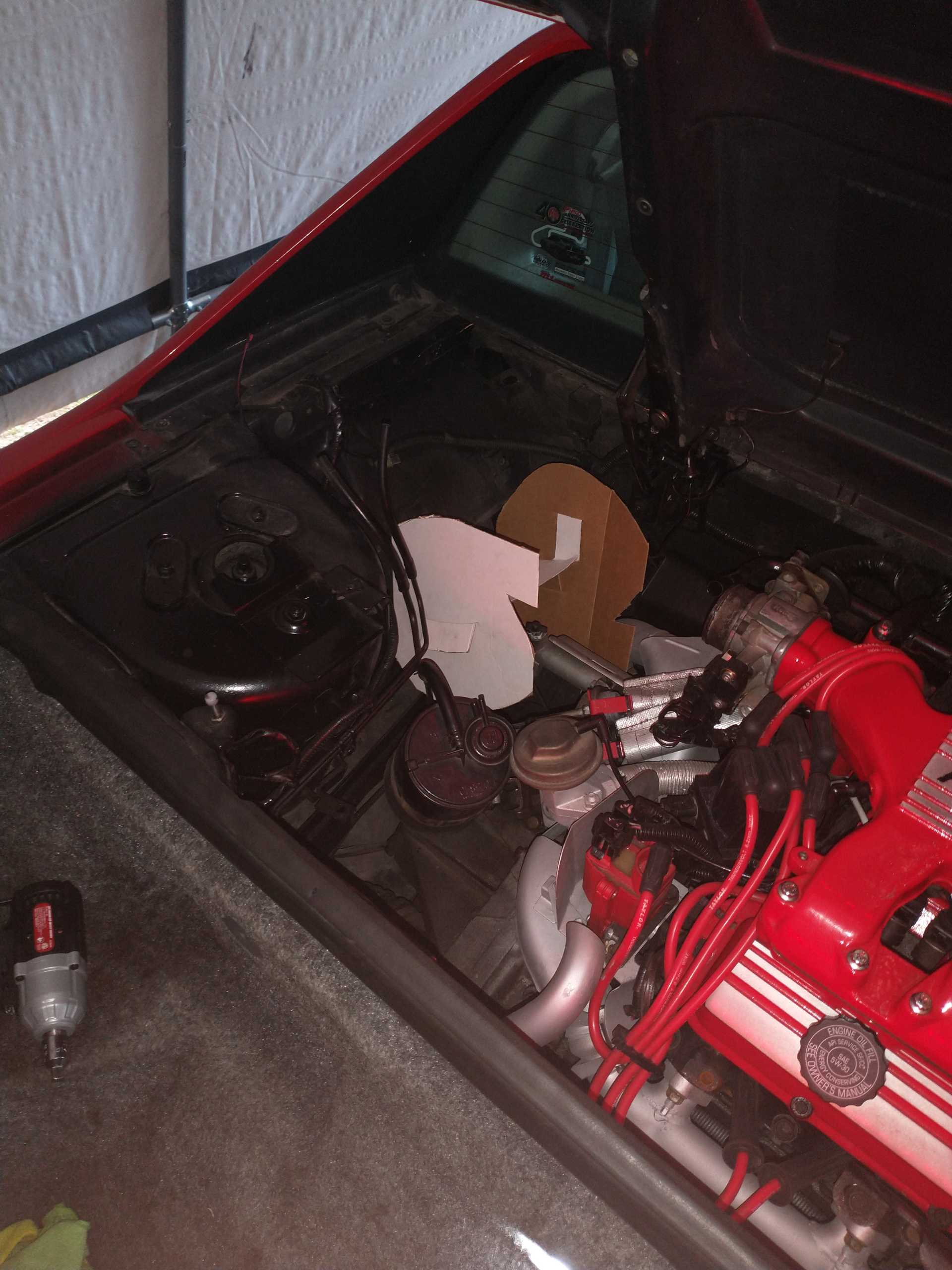

I think I understand what kind of turbo placement you're thinking of, sort of beneath the LH decklid grille. The LH decklid spring may present some challenges. The slave cylinder may come close to the turbine; the slave cylinder should be well-protected.

Yeah, the slave will be fairly close, if not protruding between the 2 halves a little bit, I have a few inches between it and the decklid spring (which is more to the side) to get it fine tuned.
