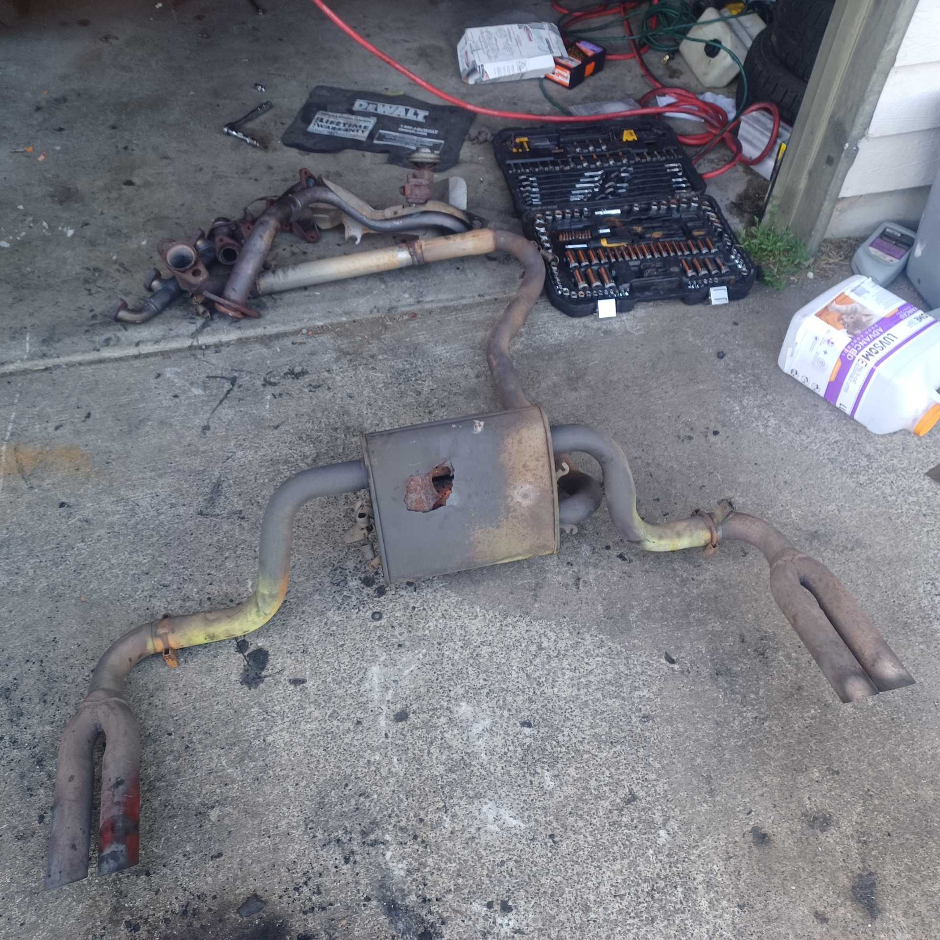

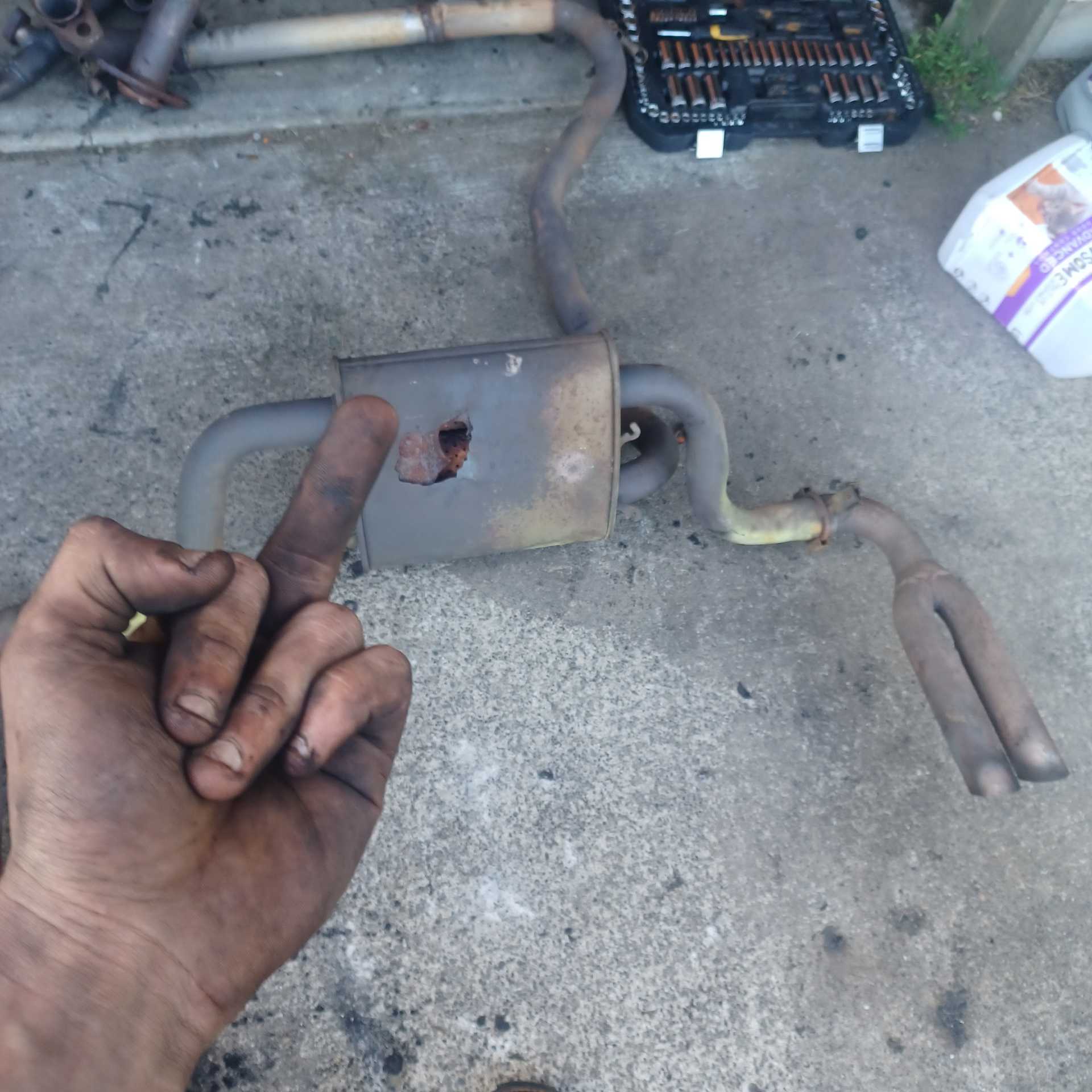

it set another code 22. also surging like a carb out of gas when held at one throttle position. more importantly I did figure how where the exhaust leak was. or rather it decided to make itself very known at 3 am last night with a hellacious backfire and some oil burning off the rear header as I guess it finally got pretty hot. got quite a few cuts and rust in my eyes and some interesting chunks of heat shield. hence the French sign language
