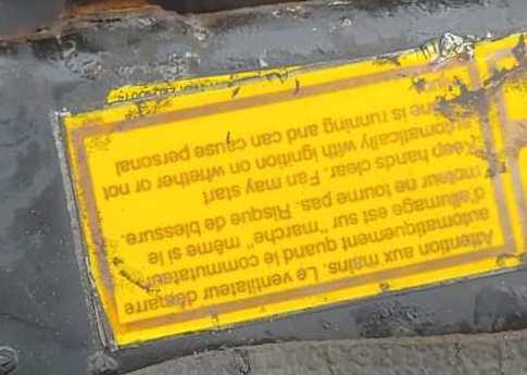

I just noticed the text on the bracket is in both French and English strengthening my suspicion that my Fiero originally came from Canada. 😁

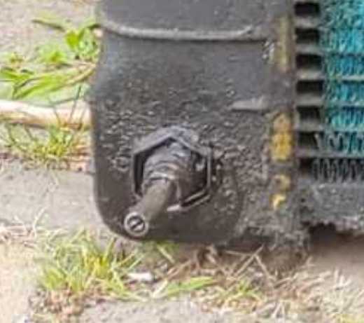

Looking at the picture of my old radiator, I notice something weird. If I look at the bottom transmission line (the one that was apparently broken off because it had a piece of tubing on it), it looks like there's something inside the line:
I wonder what that is? My car is parked about 8 miles from my place so I can't really have a look until I'll work on it again.
