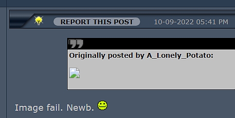

Look again, your eyes decieve you in your advanced years.
Nope, sorry... captured forever.
Seeing that now newly re-posted image , my concern would be if the wiring harness for the sensor was extended in a proper fashion. If there's added resistance in the splices for example, that might be throwing readings of the IAT sensor off.
