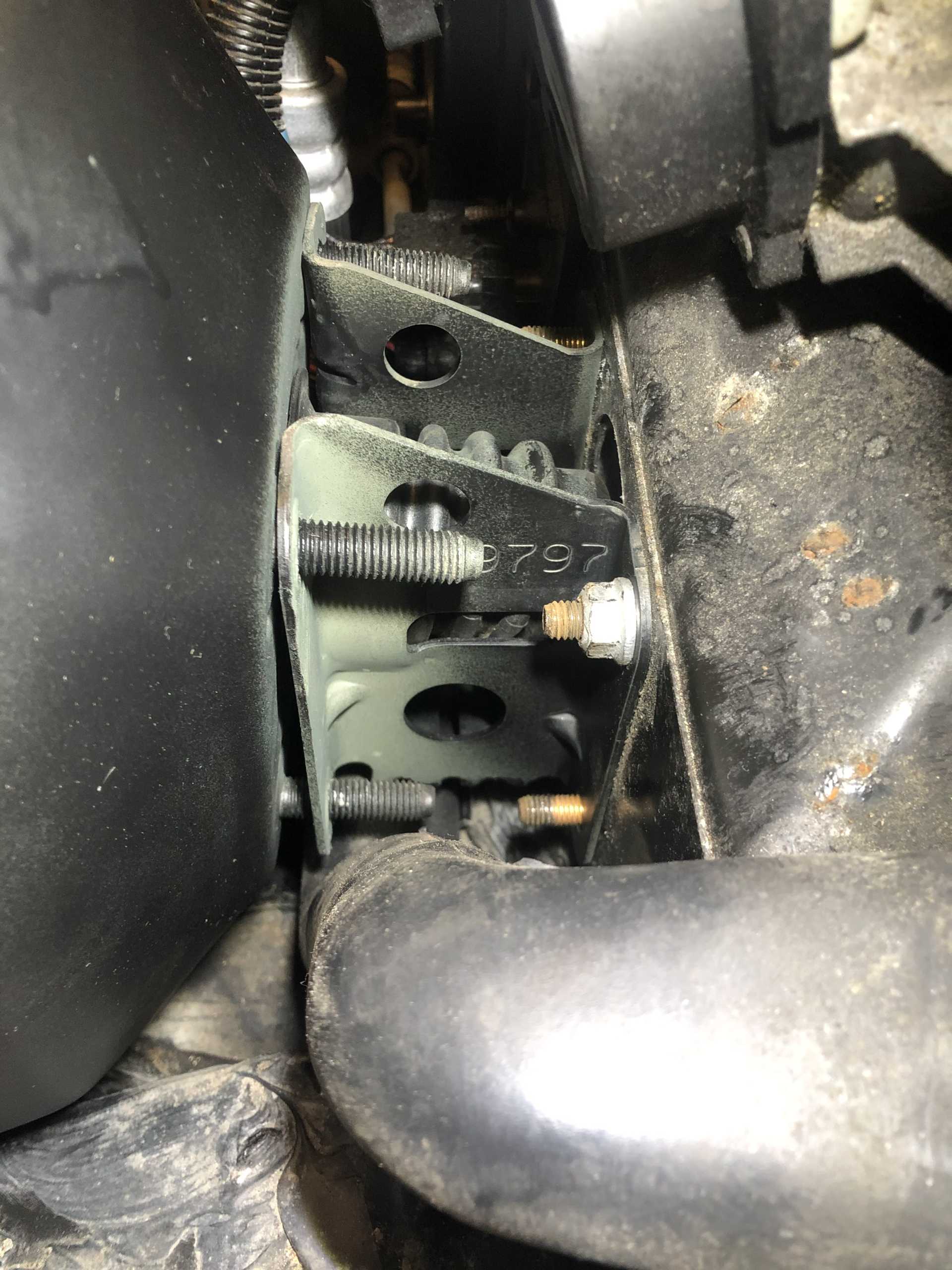

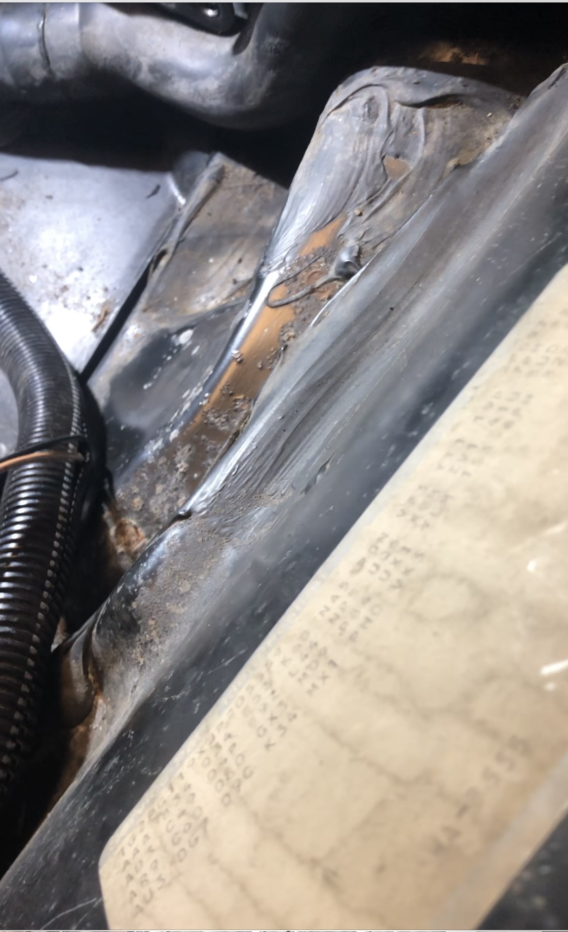

jelly2m8
AUG 21, 06:28 PM
| quote | Originally posted by Vintage-Nut:
Really?
The major drawback to me which requires "percussive adjustment" or "massaging" of the sheet metal (hammer) to make a depression in the steel inner fender for this larger booster to fit.
I didn't want to modify the frame..... |
Your not really modifying the frame, It's just a subtle reshaping of one small area that if you don't go too crazy it's not really even noticeable with the Booster not even in place. It's not an area that shows from the underside. I too did not want to ' beat on my chassis', I looked at several options, angling the booster, off setting it inboard but both of those options left the same issues, incorrect pushrod angle and it was alot of work for zero gain.
10.4in booster in place before subtle modification Notice the gap at the bottom of the bracket.
The modification done to allow booster to seat properly
Booster mounted.
