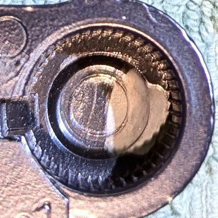

Dorman on top, GM original part on bottom. the Dorman (for whatever dumb reasoning) appears to have shallow recessed slots, which basically makes the majority of the visible surface area flat and incapable of gripping onto the splined post. i doubt these would work on the Chevy trucks either. when i installed these they simply shook loose and fell off. the GM originals have pronounced raised teeth, allowing them to grip onto the splined posts really well. when i installed these, they firmly walked onto the post and required medium effort to dislodge again. the GMs also come with J hook design and can lock upward (with your hood up) just like the Dormans.

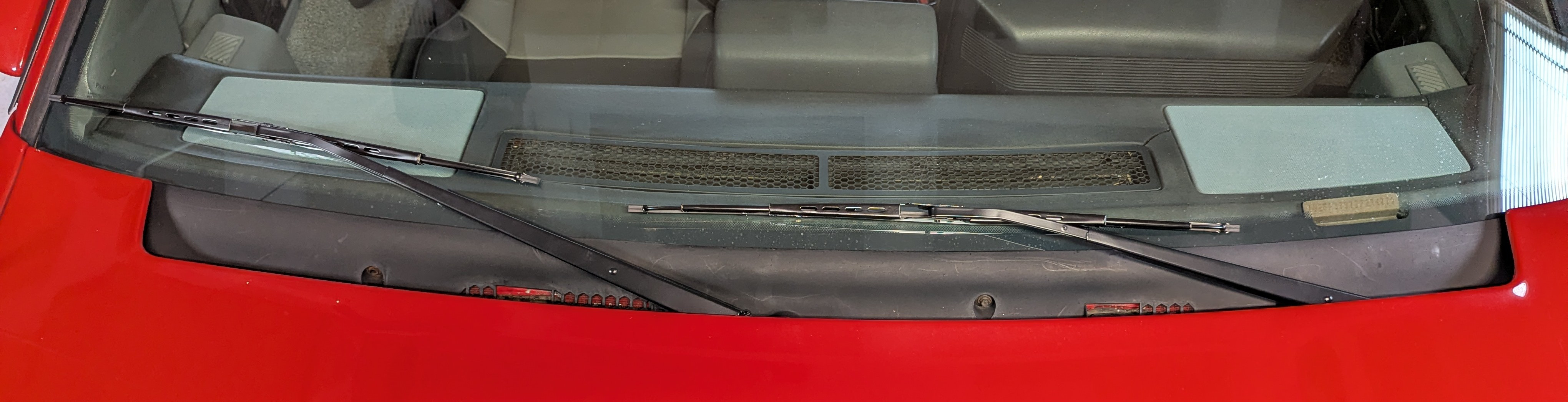

here's the full view of how they sit, the passenger and driver installed accordingly. the passenger sits a tad high, but when i rotated 1 spline, it was into the plastic cowl... i don't really care since they actually work.

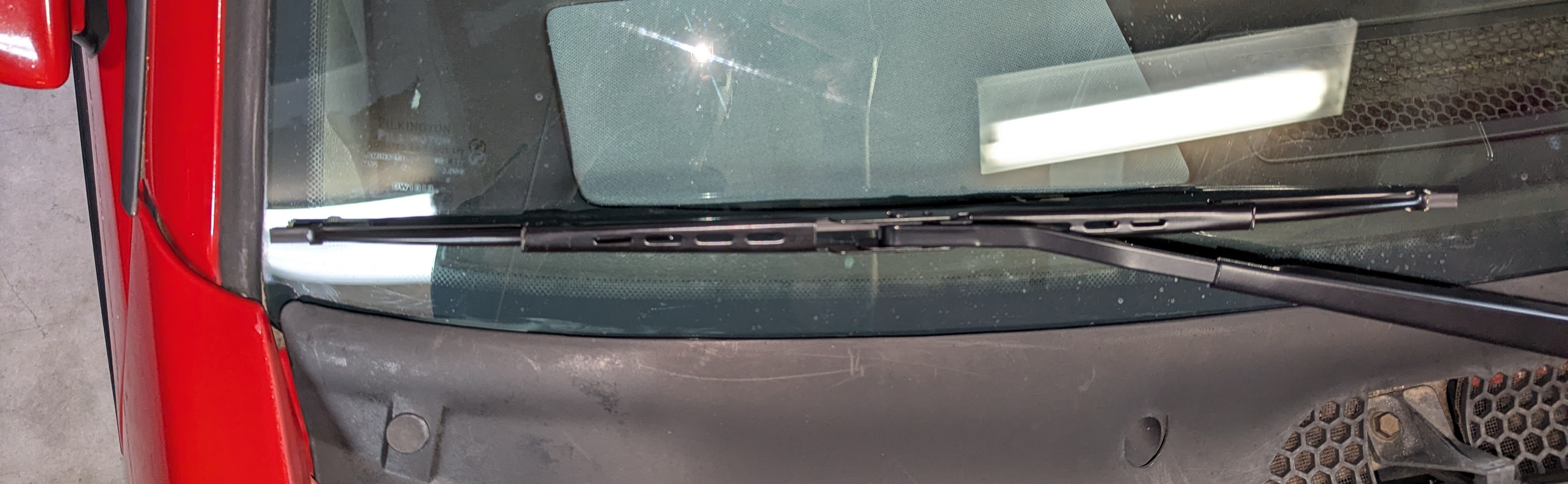

driver side alignment with a 21" blade (this could actually fit a 22", but ymmv).

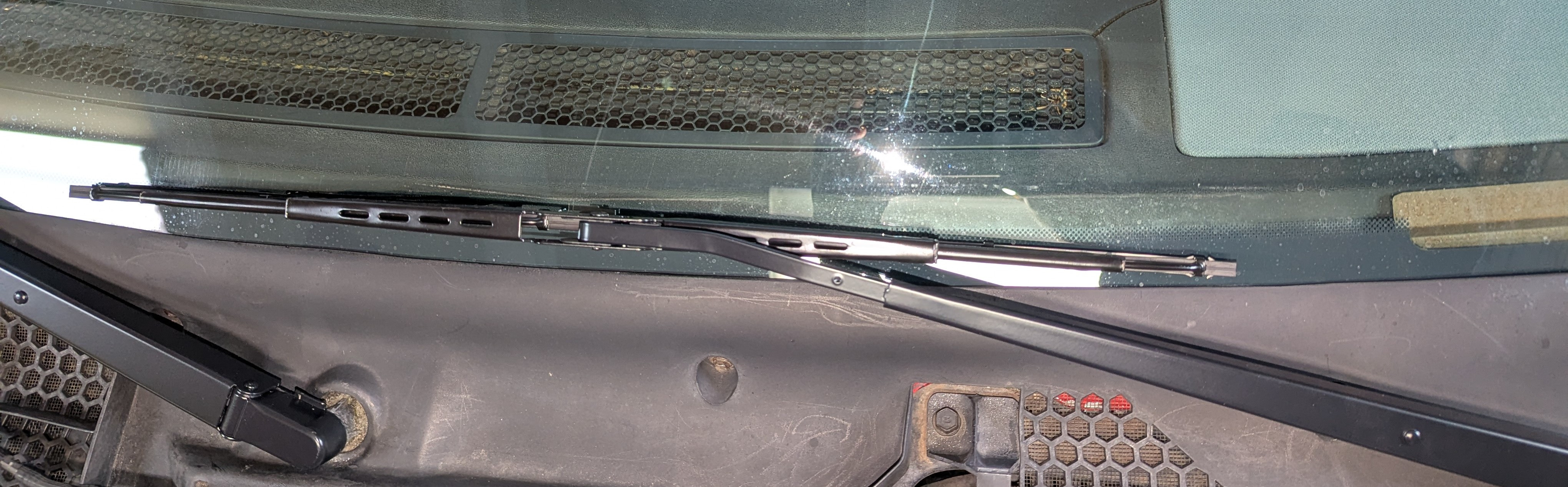

and the passenger side alignment with a 19" blade (this is like 1/8" away from the molding).
