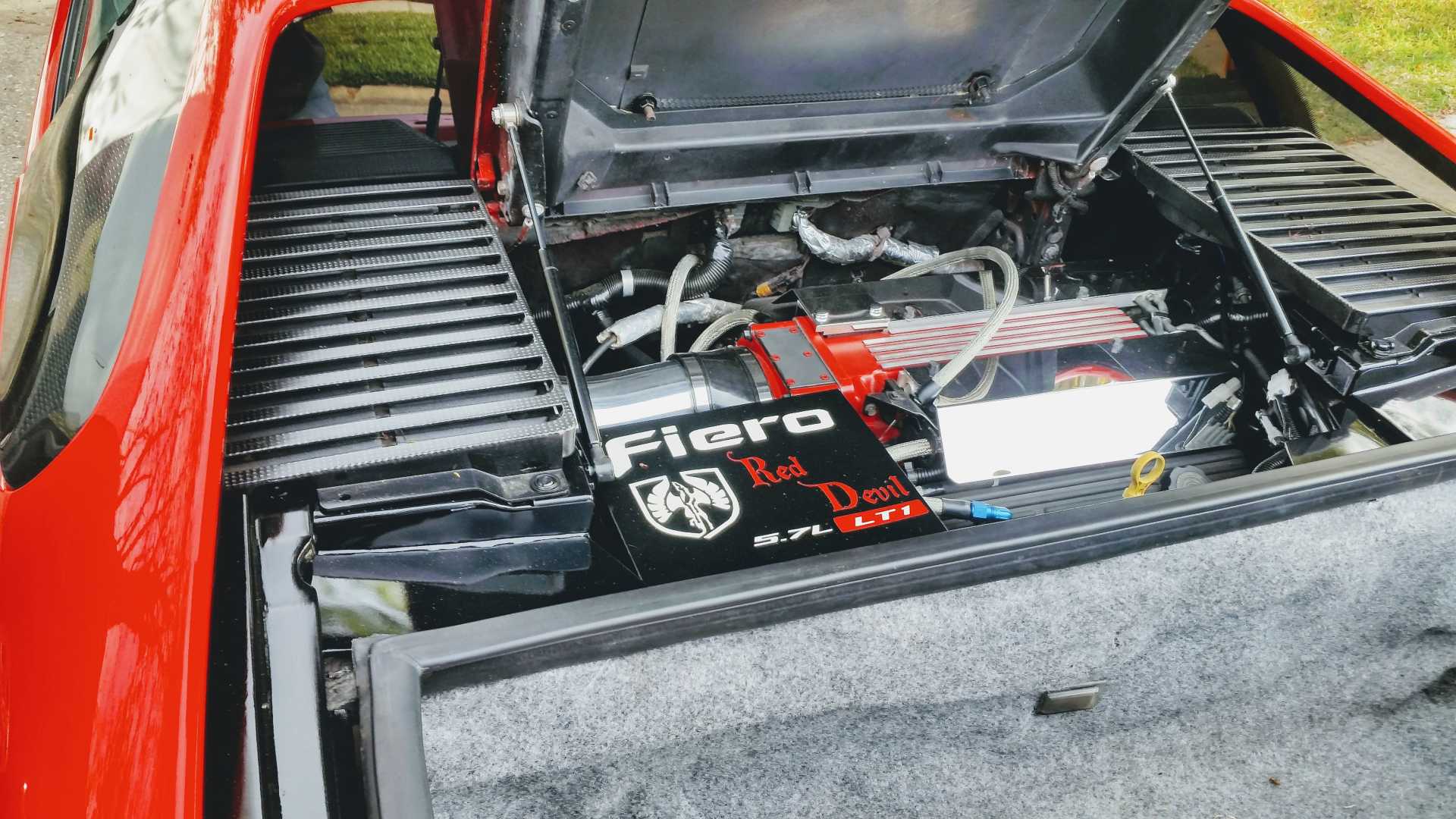

str8maxn AUG 31, 07:08 PM
Originally posted by cyrus88:
This pic shows the adapters and lack of stock WP.
If you can't make your own, shop for remote water pump adapters for LT-1 on the net. I remember seeing some, but can't remember where.
Out of the water pump blocking plates with the NA fittings how are you making the transition from an NA fitting to the stock cooling system?

cyrus88 AUG 31, 09:38 PM
Nope not that kind of adapter. See my picture above showing the remote thermostat.
1. The inlet to the water pump is from the bottom of the radiator with the usual fiero lines and custom/cut radator hose.
2. The outlet from the water pump goes to the TOP fittings of the blocking plates using AN hose and fittings.
3. The water outlet from the engine, from the BOTTOM of the blocking plates, go to the remote thermostat housing.
4. Regular rubber radior hose goes from the "goose neck," on the remote thermostat, plus Fiero lines to the top of the radiator.
5. The heater core hoses attach via T-fittings. From thermostat housing to core, and return from core to water pump inlet.
[This message has been edited by cyrus88 (edited 08-31-2021).]

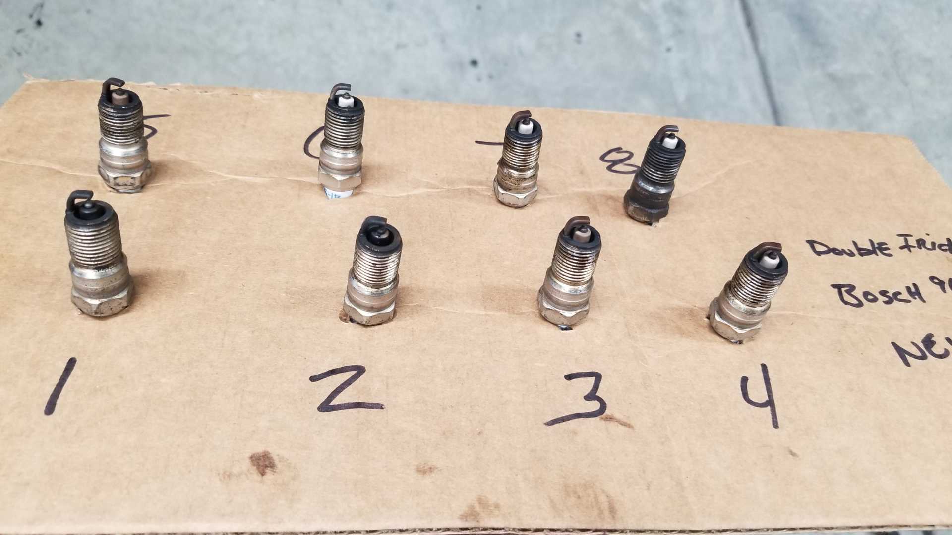

str8maxn SEP 01, 02:55 PM
Luck has been on my side so far.
Changing the spark plugs has gone pretty smooth, I was able to get to the first 4 ( closer to the trunk) by removing half the exhaust. The other 4 ( closer to the firewall with a few extensions /swivels and I had to cut down a 3/4 wrench.
Here are the plugs that were in the fiero. TB is located on the Right Side.
Please let me know If I should be concerned with anything. I replaced them with Bosch Double Iridium pre gapped at 0.055 . Old one were gapped at .045.
