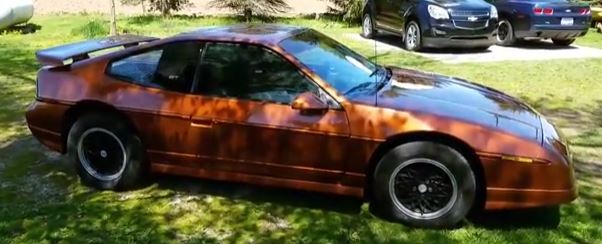

You could buy my 86'GT, I installed a crate (long block) engine and it only has about 10k miles on the engine, 93k miles on the Fiero.
