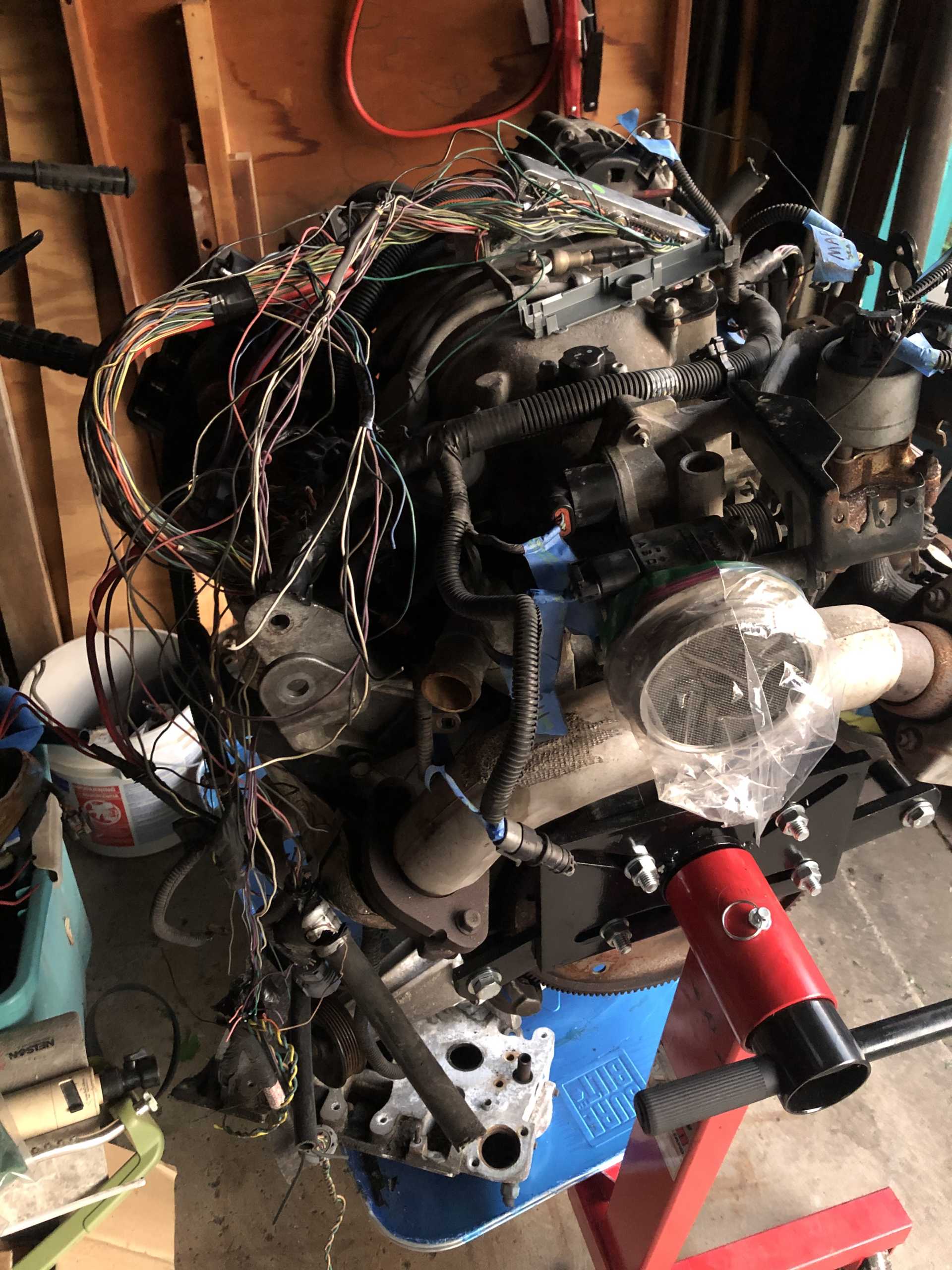

I’m waiting on FieroRog’s mounts and flywheel to arrive so I figured I’d start on the wiring.
Pulled the old wiring harness out of the Fiero. Had to chop a few sections to get it all out but since I’m not using most of it, it wouldn’t hurt.

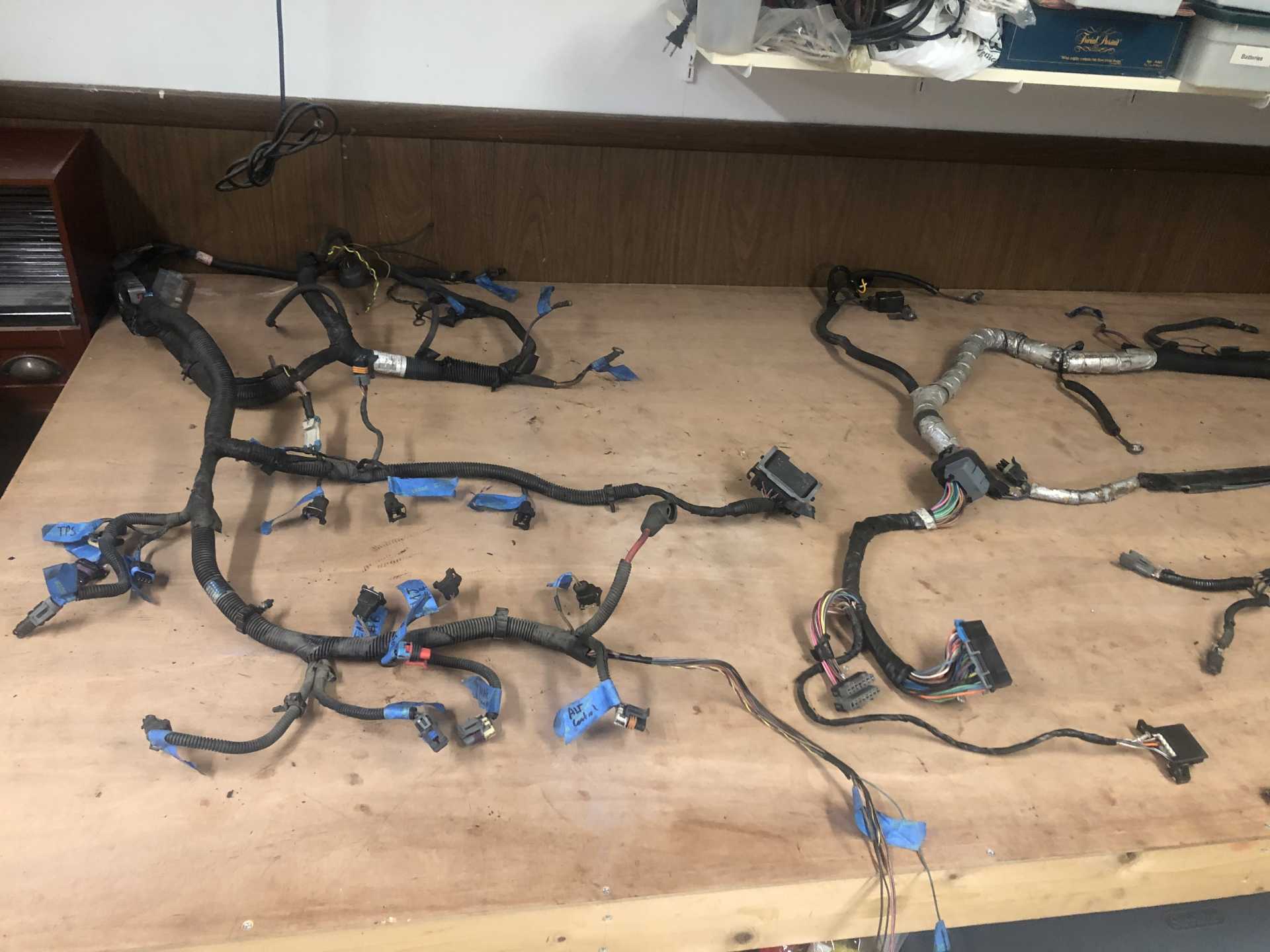

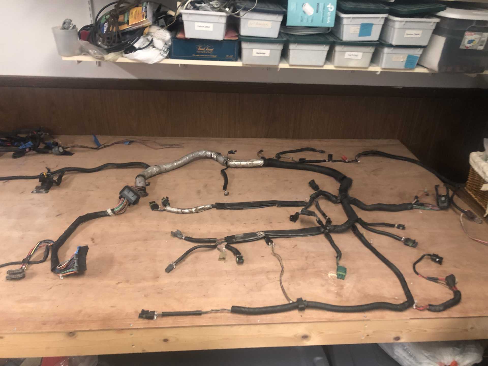

Previously I decided that I was going to lay both harnesses out on an old model train table I have. Original plan was to compare wire routing, copy the routing of the original Fiero harness, and where to extend wiring to be able to use the new ECM in the stock location. Also the plan was to be able to do all the wiring inside because it’s now hot outside.
Laid out the Fiero harness. Securing the harness to the table with thumb tacks
Here are both harnesses on the table. 3800 harness is not secured
After laying them out and realizing that my “jig” I have may/may not work (I may get confused or mid place some wires with the whole loom off the engine)
I’m thinking I may have to keep the harness on the engine while I do my trimming and routing. Just so I can be satisfied with the cleanliness of everything. Going to have to ponder some thoughts on how to approach it.

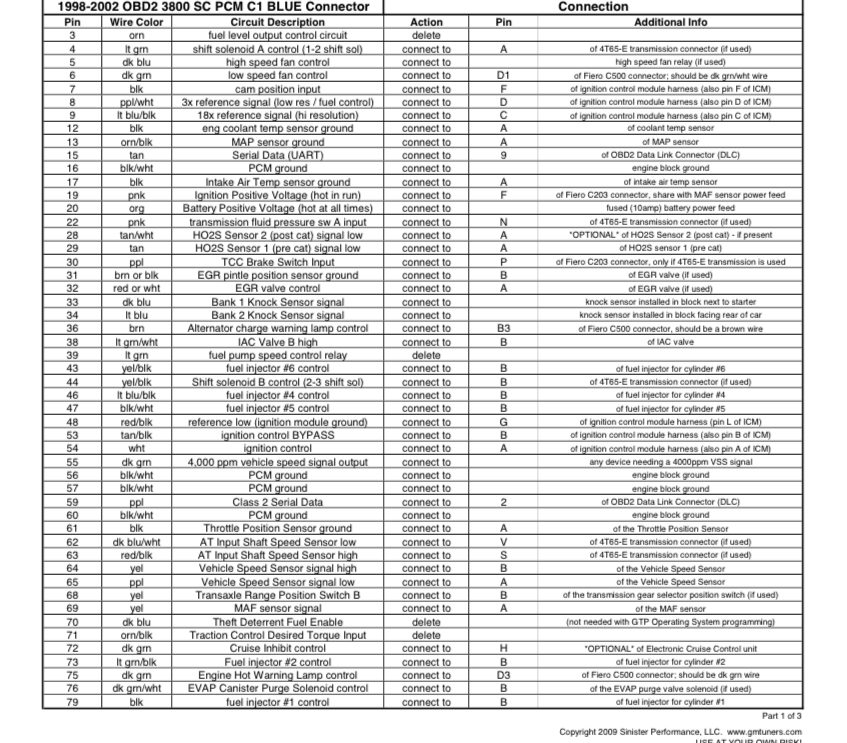

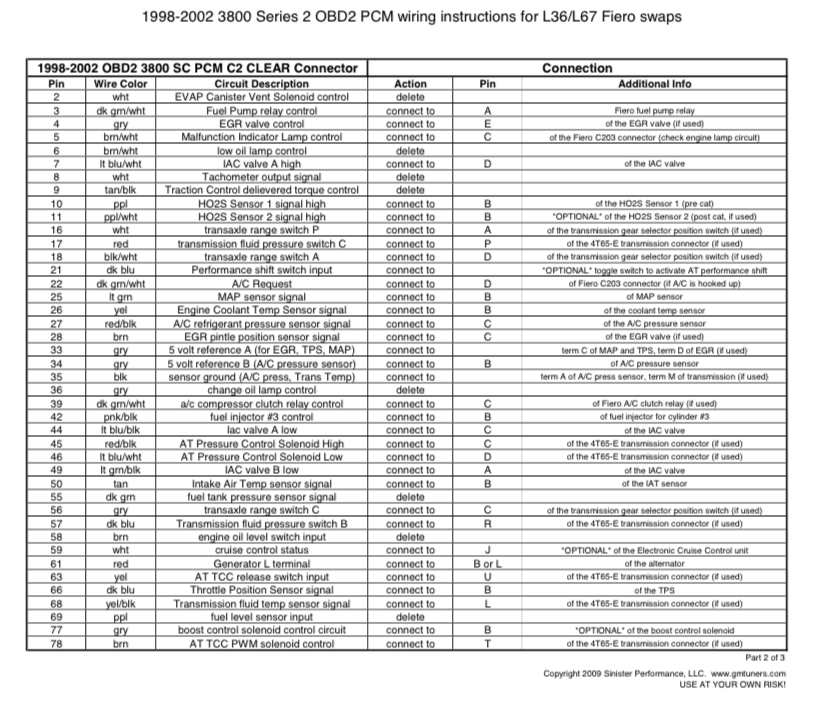

I have started the process already. And I’m using the connector Pin outs provided by the Gmtuners website
Now you guys might be wondering why I’m using the 1998-2002 wiring pin outs for my 04 engine harness and ECU. That is because I ended up using and ECM from Fast Fieros out of a 1998 Bonneville due to tuning incapability.
I took both of the wiring pin outs from the 98-02 and 03+, put them side by side and compared. Luckily the only difference really was the amount of transmission wiring. And since I’m keeping the stock 4 speed, that’s all getting deleted anyway.
(Also I talked with a man named James Brown on Facebook who builds these harnesses for advice on the matter a few weeks prior. He also stated the same. Also another very helpful and pleasurable person to talk to)

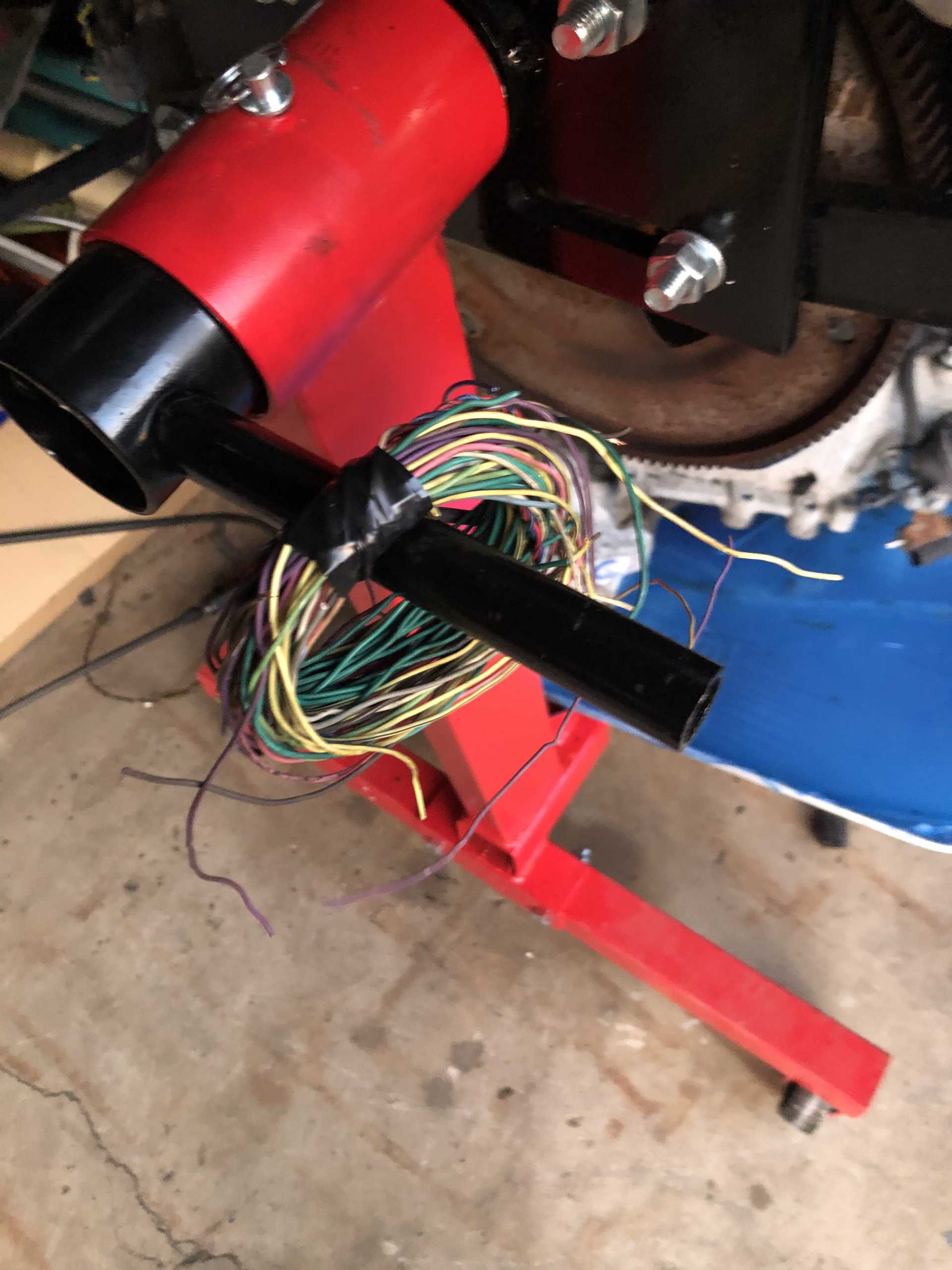

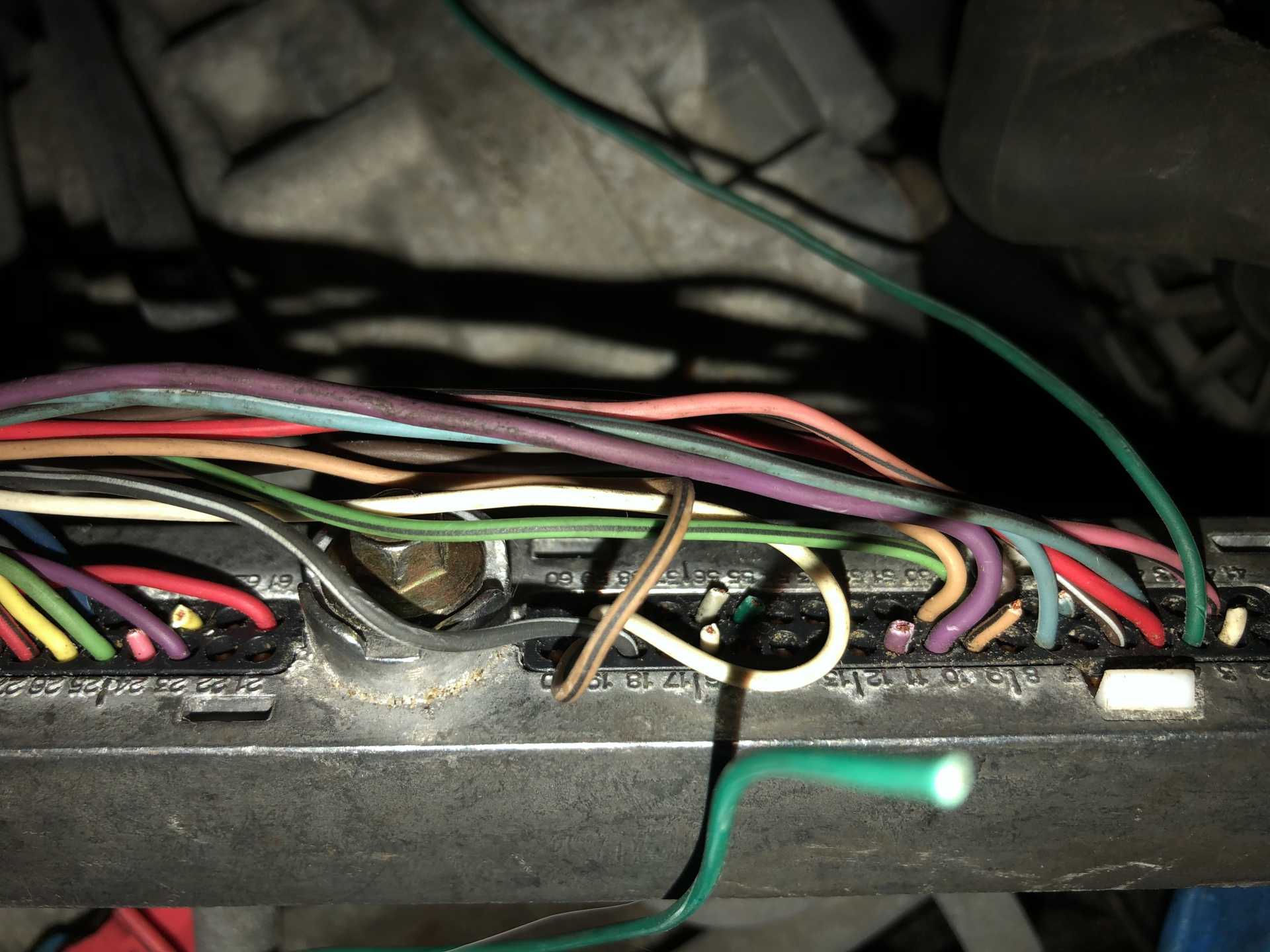

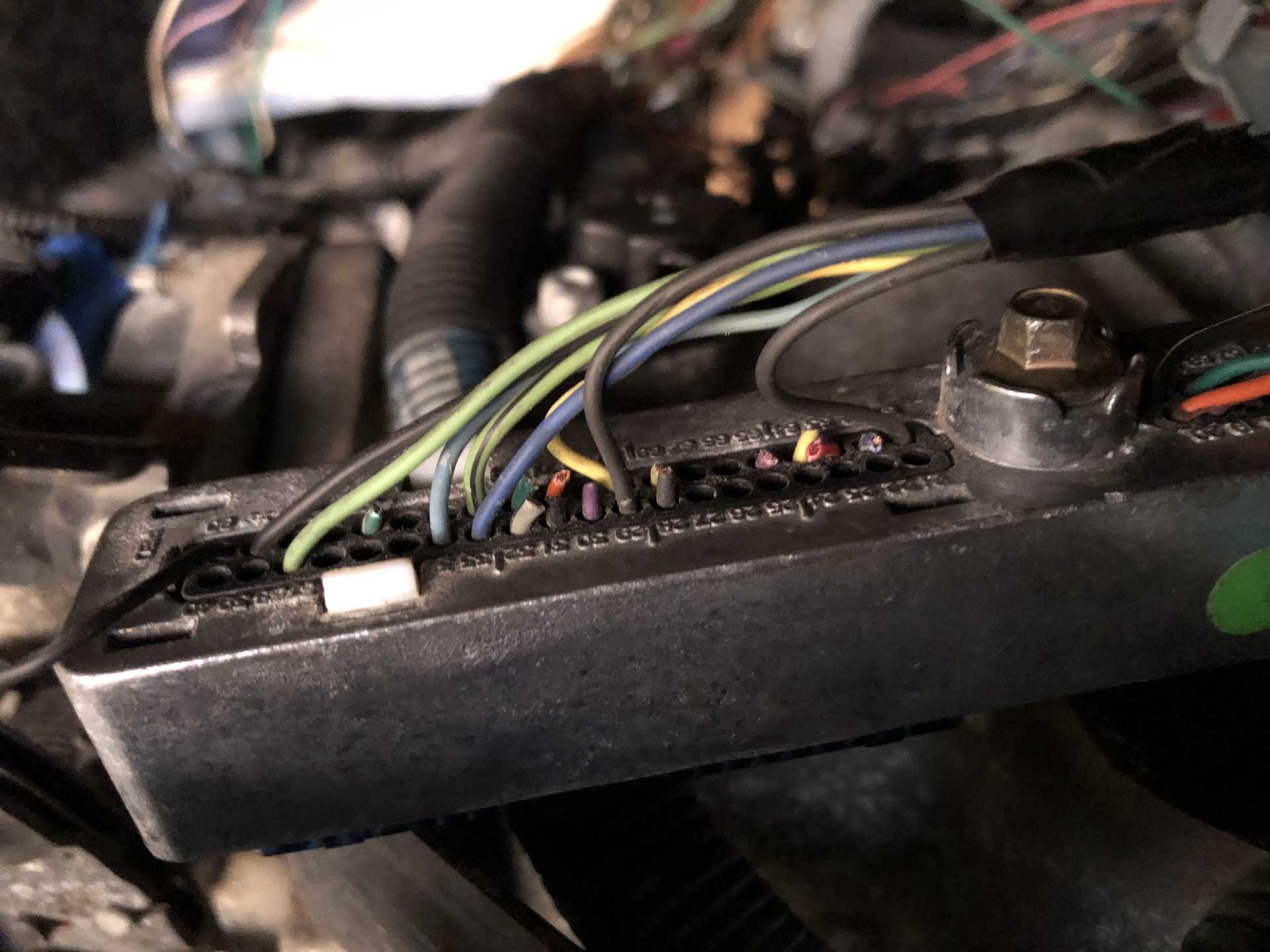

So as I went though the list. I started cutting each wire at the ECU blue and clear connectors. Just so I can start clearing wires out of the way.
I do realize that the wire and pin are still located in the connector. Those will be removed and the hole sealed off at a later time near harness completion
as fast as the work goes today this is where I’m at. It really is an organized mess, along with the wires I’ve removed so far. Mainly transmission control

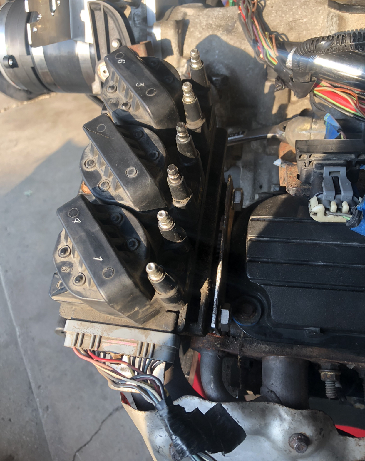

One of the challenges was mounting the ignition coils. Me being stubborn, I wanted to have a stock look, and the common coil relocation places didn’t look appealing to me. I found a location that I really enjoyed.
I found that from Brianlloyd.com and his builds.
I thought it was perfect. I didn’t have to spend ungodly amounts on custom length spark plug wires and since I deleted the EGR, the bolt holes there were no longer used. I went to the junkyard and pulled that style coil mount from an N/A 3800. Then i learned that it would not fit.

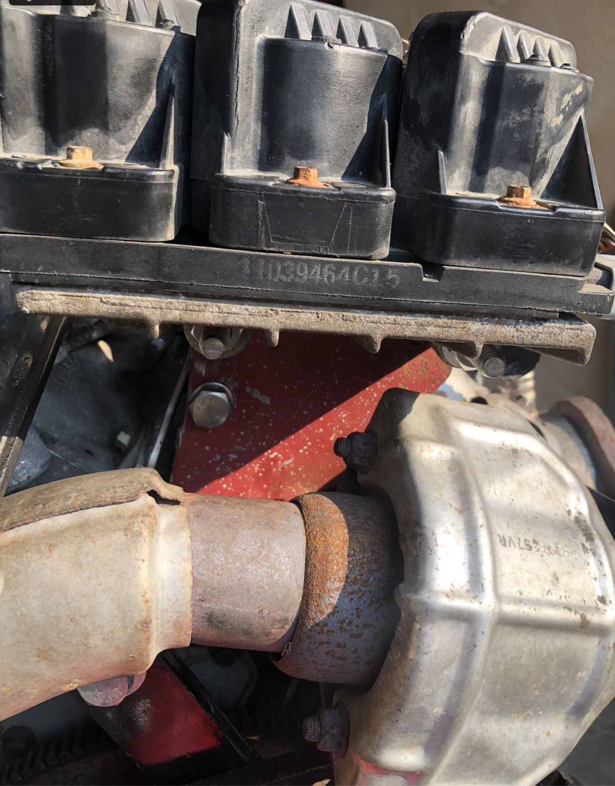

The exhaust crossover and header flange was in the way. I decided that the way to keep it was to actually raise the coil up just enough to clear with a bracket.
I took a pieced steel plate (previously as a friends dump bed on his semi) with some elementary engineering skills, traced the two mount holes with the old EGR valve bracket
I am unable to use the third bolt hole closest to the exhaust manifold, due to the EGR blockoff plate blocking the hole. So I just made sure to include an indent to clear the plate.
With that I traced the two mounting holes for the ICM ~1.5” higher than they were to effectively “lift” the coil the needed height
The final picture are with the coil mounted in place
Keep in mind the bolts that bolt the coil to the plate also had to clear the valve cover. I installed the bolt head toward the valve cover to have a cleaner less garbage lookin look.

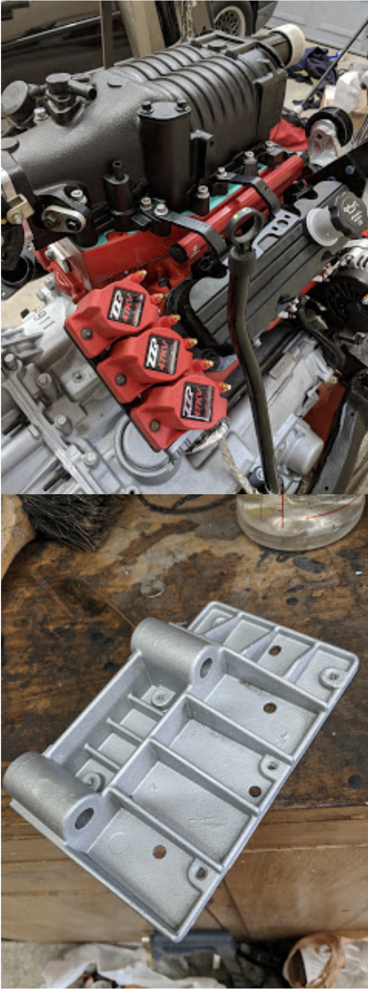

Where the post was left off was with the coil pack mounting. After that was completed, i started with resealing the engine. I noticed a large oil leak coming from the top of the engine, I suspected valve cover gaskets.
hard to see in that picture, but when I relocated the alternator, I found that the mounting bolts were swapped around for the original alternator mount, and one of the bolts punched a hole right through the valve cover. Looks like i found the main culprit of the oil leak.
I ordered a rear valve cover for it.

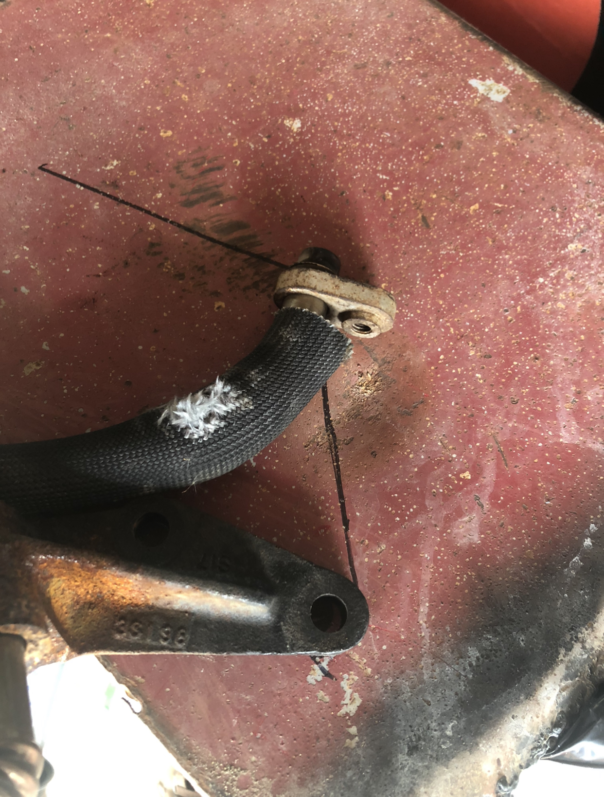

While there, I made an oops. I had to cut one of the bolts on the passenger side control arm, and I clipped the coolant tube with the cutting wheel
I cut the tube all the way, slid a piece of radiator hose over both ends and secured with clamps. currently looking for a passenger side coolant tube but I'm also not in a rush
