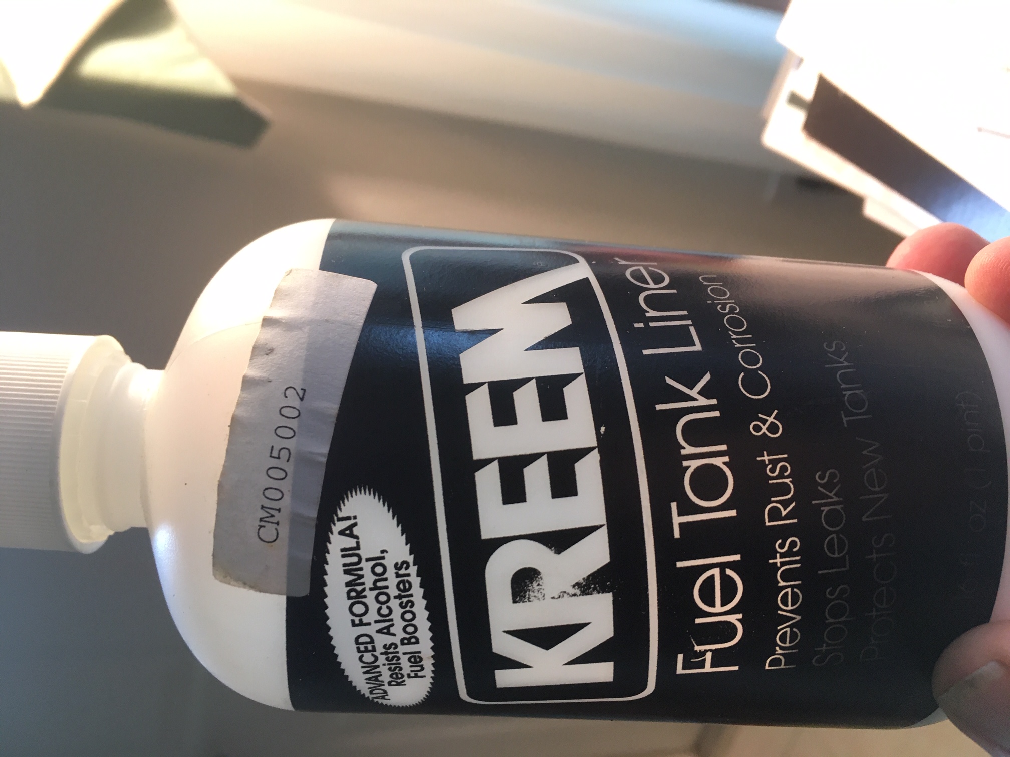

My friend talked about some product that coats the inside of the tank with a paint/sealer type coating. Patrick’s link talks about an acid cleaner, but it doesnt seem to be a coating. Any ideas?
Edit: i reread the link, and it looks like what i need.[This message has been edited by fierobear (edited 07-14-2020).]

Your friend is probably talking about a sealer known as "Kreem," or something similar. I've used it and do not recommend it for old, rusty tanks. It's basically like an acrylic paint. It does NOT remove the rust. It only paints over it, and surface rust is a poor foundation for paint. Over time it loosens up and the paint flakes off. It performs little different in an old, rusted tank (although it might be just fine inside a new tank). In comparison, phosphoric acid reacts with the ferrous metal to remove surface rust and, in essence, create a phosphate coating on the surface of the metal. A phosphate coating is very rust resistant. In the gunsmithing world this is basically called "parkerizing." I use phosphoric acid exclusively. Don't sweat it.
Ernie Here's a photo of the stuff I no longer use...Kreem...it's just a acryllic/latex-type paint/coating:  ------------------ '87 Fiero 4.9 5-speed
