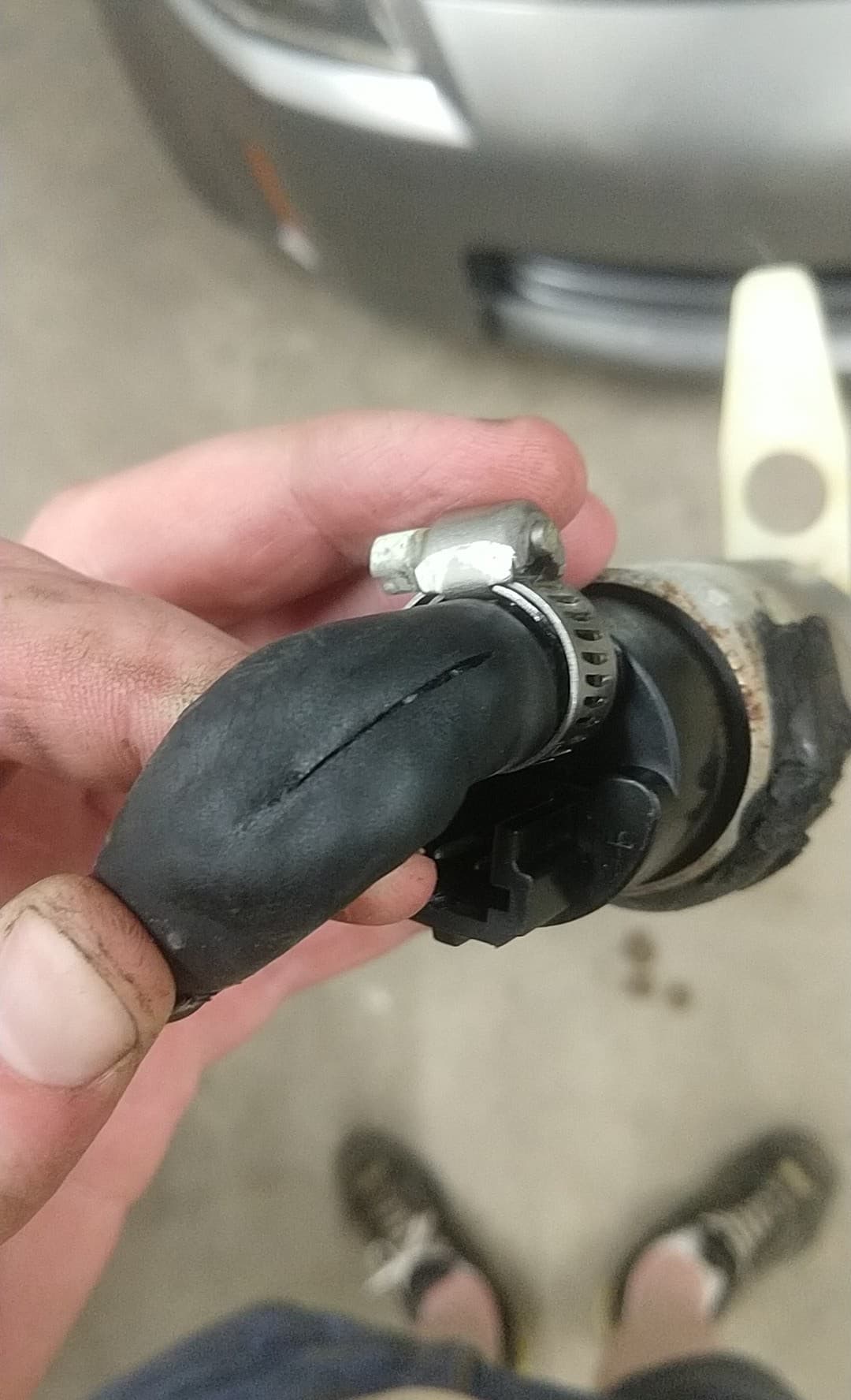

Fuel problem was found last night, likely the source of all my engine related problems... I cleaned the aftermarket fuel filter out and found a ton of junk which prompted the fuel tank drop. I knew I should have done this from the start but I tend to be overly lazy until stuff starts to really line up as the problem. 100% of the 3800 stuff I've done with fieros would shown absolutely no chance of even running at all if I found this in the tank. Pretty amazed to be honest.
"fuel pump jacket" melted onto the fuel sock, which also turned to goo.
Ruined pressure line
