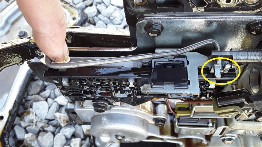

EDIT: Taking off another car's valve body to swap on pointed out something I didn't do. This probably explains my auto park brake and backup sensor inops. Wonder what happens regarding shifting if I didn't link that lever in like this one is? Because I didn't and wonder if that's all my trans problems.

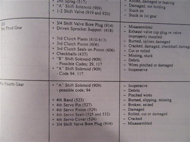

THIS WAS THE ORIGINAL POSTING: I compared the channel plates before assembling the new setup and they were the same. Separator plate too, from my untrained eye anyway. Only found 1 separator plate avail for my year. My vin 9 trans is a 2001. The replacement trans is almost lost in memory, but was def a vin 9 and pretty sure it was a 2001, but only used the channel plate, so. Waited a long time to find correct trans and it is. Vin 9 is DTS/STS. The valve body and other pieces weren't exchanged. With new solenoids I was surprised to have this. Decided to pull a complete valve body assembly from another trans I just located and will stick that in to try. I expect this will fix my shifting but not my auto-brake release issue or the backup sensor inop issue.

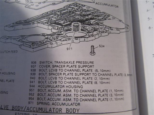

Stopped at a different trans shop yesterday to pick brains and found he had a ATSG tech manual for a 4t80e he said he would never use and bought that from him. Based on the troubleshooting bits and both gears being inop it looks like maybe "misassembled". I'm going to replace the wiring harness too. The schematic also shows a spring under the 1-2 accumulator that I don't remember ever seeing. Maybe what I heard fall out when pulling valve body assembly is what is causing the parking brake auto release issue.
So with the shifting issues, valve bore plug? Debris? Wiring problem? But with the replacement valve body I can't change the solenoids without removing the valve body to get at the retaining clips (maybe accumulators--can't remember now, so...what to do? Just swap it as is and later change solenoids once it's cleared as working?
971 was not installed under 1-2 accumulator if it was a loose spring.

Been a while since working on these, but if you didn't link up the IMS right that could be it. Not sure it will fix everything though. The ATSG chart lists all possibilities. Hard to sort out without a working knowledge of operation. Hydraulic charts mean more to me. Mismatched parts are probably not a problem. I wouldn't be concerned about the missing 1-2 accumulator spring now. It's a trim spring not used on all models. When you install the replacement VB, just make sure everything is hooked up right and let us know.

I'm thinking my alternate channel plate didn't have the trim spring when I took it down. The two plates have a different date ink stamped on them. The one I just found has the earlier date too.
