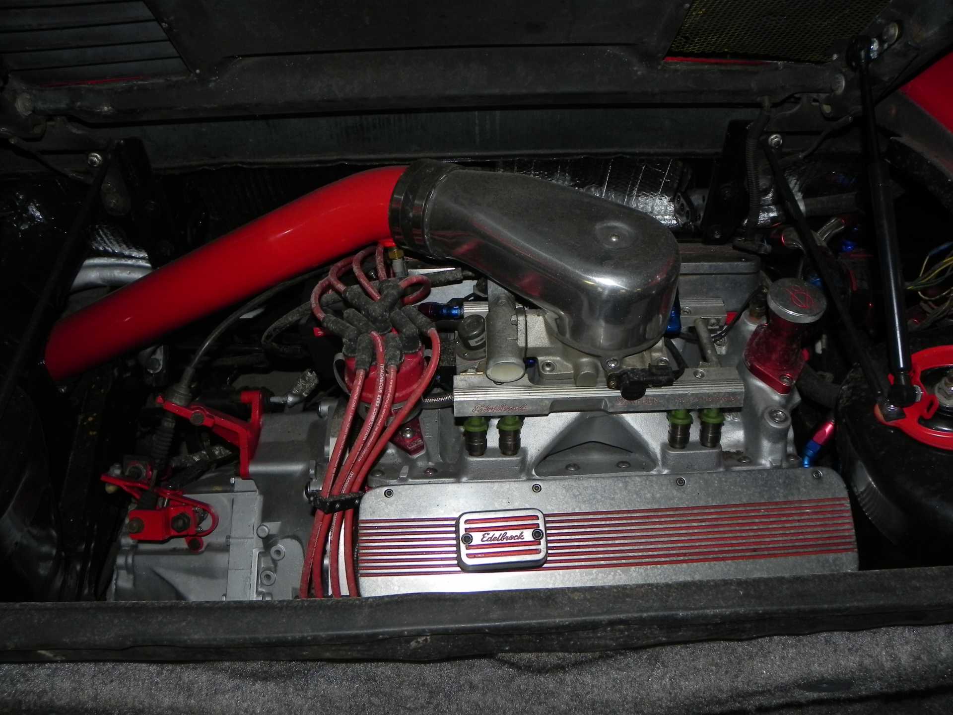

| quote | Originally posted by DimeMachine: Nice looking swap. Have you had the chance to run the 1/4 with it? |
That particular engine is in my primary show car. I am not really into drag racing and have enough invested in this restored 88 Mera that it is unlikely to make a timed quarter mile run.

This is another 88 Mera project car that I might consider running a quarter mile after the engine is tuned. The exterior is ugly but paint will eventually cure that.
Nelson
