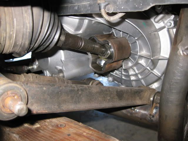

Even if the axle setup has been used before, placement of transmission could be different, so it is always good to cycle and verify no binding or over extension. Ideally I like to do this with the tripot boots removed. To do this, install the drivetrain with the suspension, but leave the springs off the struts. Then you can raise and lower the suspension while turning the wheel bearing by hand.
Here is a sample picture of verifying this on the driver side.

This is true. There is no way you could get an accurate measurement on the axle length/tolerance. As has been said, take the springs off of the struts and install the drive train and entire suspension. Then lift the suspension up all the way to the bump stop and turn the wheel hub the entire time as you lift the suspension. I used a floor jack and from full droop to bump stop, check many times that no binding grinding or (in the case of a short axle) make sure it does not fall out of the tripot. Do this several times on each side. And it is great advice to have the boots off aswell.
