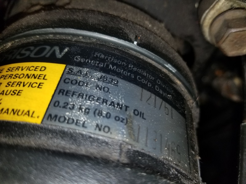

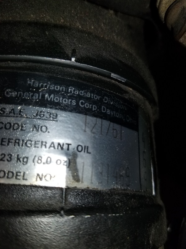

computer_engineer JUL 23, 03:33 PM
Can anyone tell which compressor this is by these photos?
From google and a few other postings on PFF, it seems like it might be a DA6, but based on the manufacture date of the car, it should be an HR6.
Thoughts?

2.5 JUL 23, 03:43 PM

2.5 JUL 23, 03:49 PM
Thoughts?
Helpful thread
Page 2 says the HR6 is an upgrade for the DA6
http://www.fiero.nl/forum/Forum2/HTML/107037.html
[This message has been edited by 2.5 (edited 07-23-2018).]
