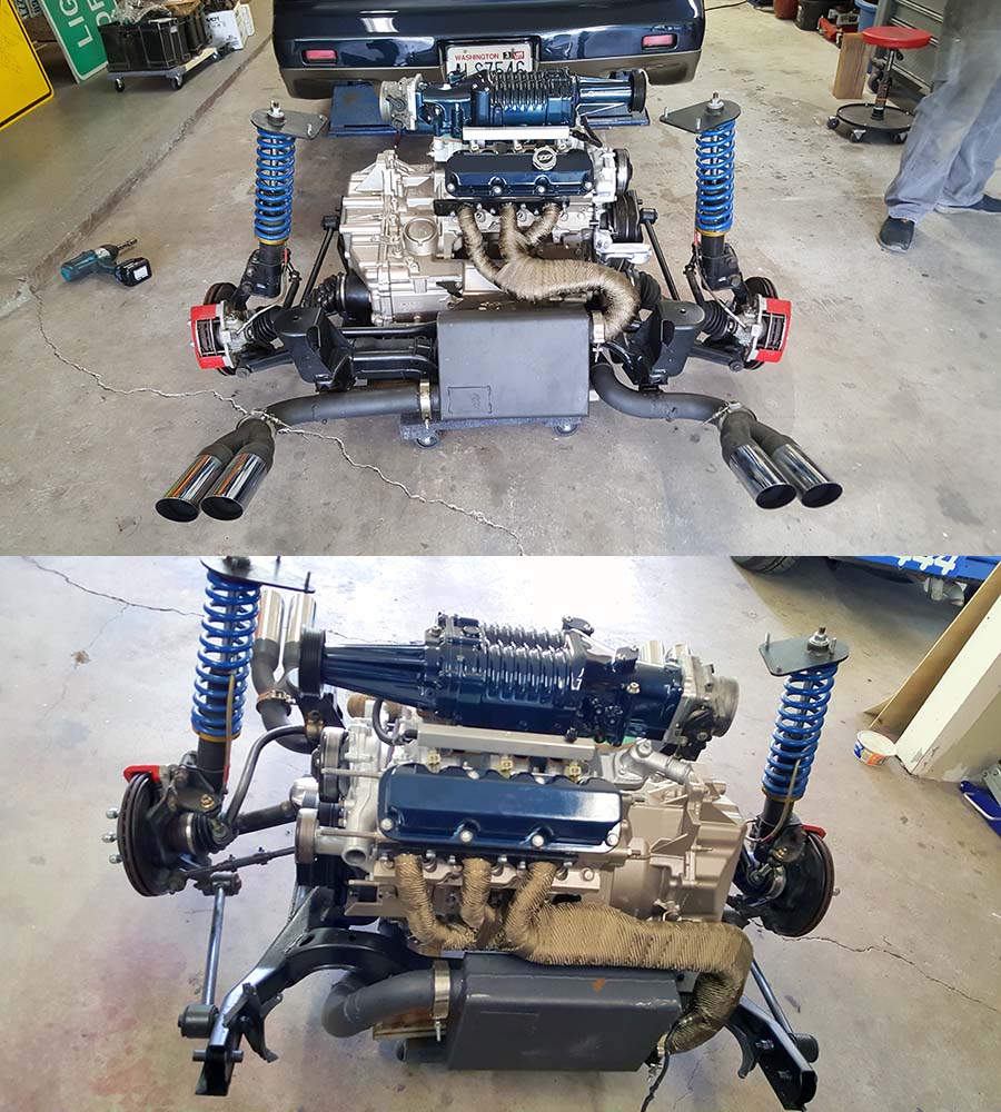

            The true-dual exhaust system on my Fiero with L32 (3800SC series III with 4T65e HD), Haltech Nexus ECM/TCM, a drive-by-wire system. L32 is an even fire engine, so does not need crossovers. Flanges are West Coast Fiero, headers are based on my design, fabricated to my spec, and mufflers are custom SpinTech. Trunk is not cut. Yes, have dual O2 sensors with Haltech gauge.

            If two head pipes diverge at the muffler is this really true dual exhaust?  I believe that a true race dual exhaust system is totally separate  containing two head pipes, two mufflers and two tail pipes. Whether a true dual exhaust system would provide any more horsepower on a 3800SC swap is an unanswered question. IMO, since the 3800 is not a high revving engine I would say that gains, if any, would be minimal. ------------------     " THE BLACK PARALYZER"   -87GT 3800SC Series III engine,  custom ZZP /Frozen Boost Intercooler setup, 3.4" Pulley, Northstar TB, LS1 MAF, 3" Spintech/Hedman Exhaust, P-log Manifold, Autolite 104's, MSD wires, Custom CAI, 4T65eHD w. custom axles, Champion Radiator, S10 Brake Booster, HP Tuners VCM Suite.             "THE COLUSSUS"  87GT - ALL OUT 3.4L  Turbocharged engine, Garrett Hybrid Turbo, MSD ign., modified TH125H  " ON THE LOOSE WITHOUT THE JUICE "
