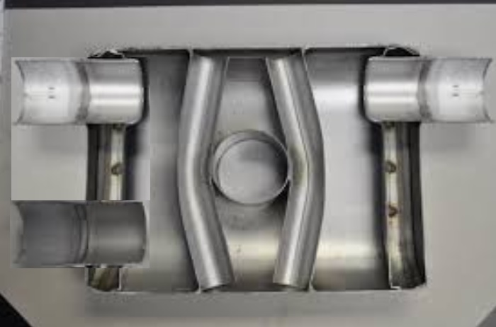

The Jones V4143T V-Power muffler I ordered arrived today. It appears to be very well constructed. Pipe connections are 16ga. It is supposed to be quieter than the Jones Deflector muffler (comparable to Flowmaster 40 or 44).
The "guts" of the V-power mufflers are all the same. I photo-edited this cutaway to show how it looks as a transverse. No flat surfaces or sharp corners inside, so supposed to be deep tone without drone/resonance. Yup - you can see light right through between the outlets.
Wow that's a different setup internally, I'm curious what it wounds like.

The Jones V4143T V-Power muffler I ordered arrived today. https://www.jegs.com/i/Jone.../523/V4143T/10002/-1
