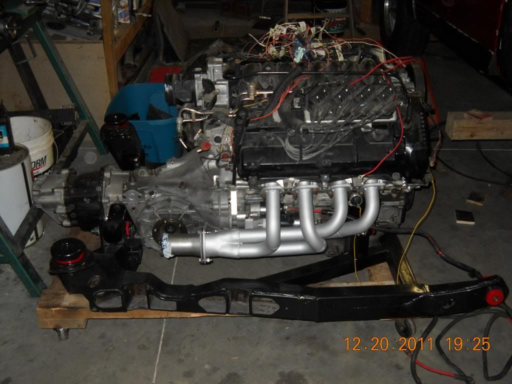

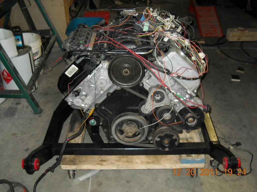

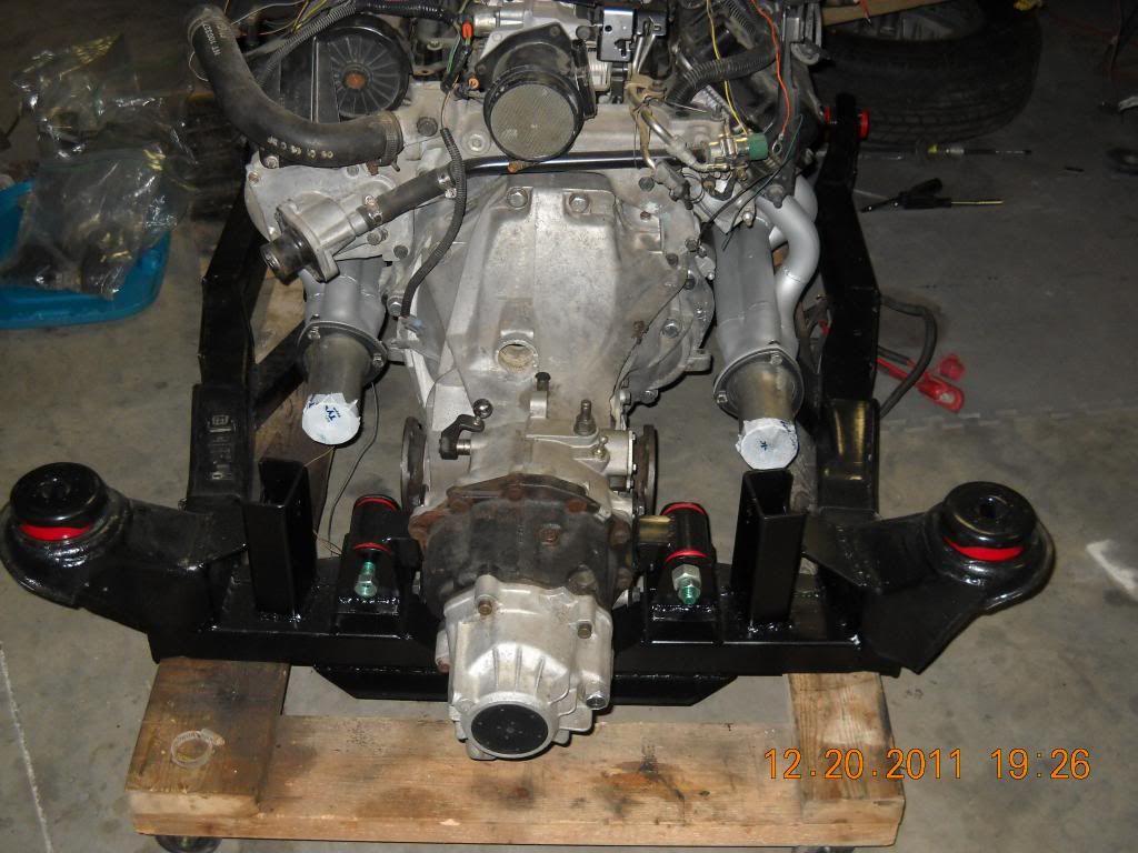

I got the engine and tranny mounted to the cradle hopefully for the last time. Here are some pics.

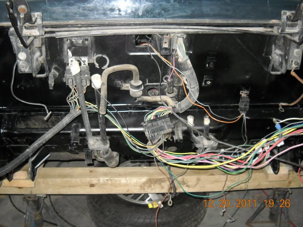

DEC 19, 09:21 PM

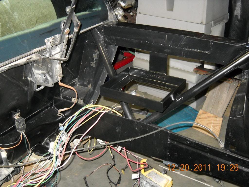

It seems like the 84 Fiero was the odd ball when it comes to wiring but I think I got it figured out. My goal is to get the engine installed and get it started. The ECM is a 7730 with Ryan Hess's tune for the Northstar. I know at will run because I had it running on the cradle earlier. Now I just need to connect it to the fiero's wiring. I also welded in a battery holder. Here are some more pics.

I have been looking at building a set of 180 degree headers once I get the engine running in the car. Has anyone had any experince with 180 degree headers on a V8 ?

dam nice job on the cradle but I would have mounted the battery in the rear for more space around the engine still love the true rear engine design

Now for my opinion: The only thing I would change would be the battery, but unlike Bubbajoexxx, I would move it up front.

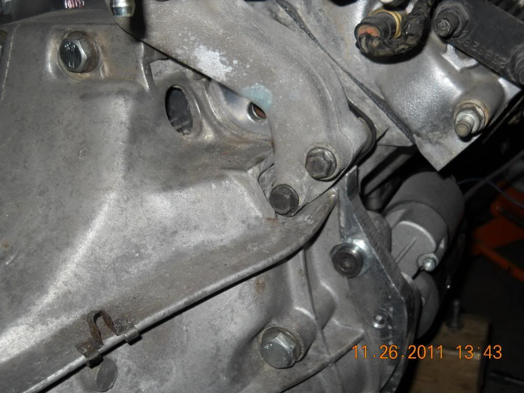

Nebraska
DEC 20, 07:02 PM

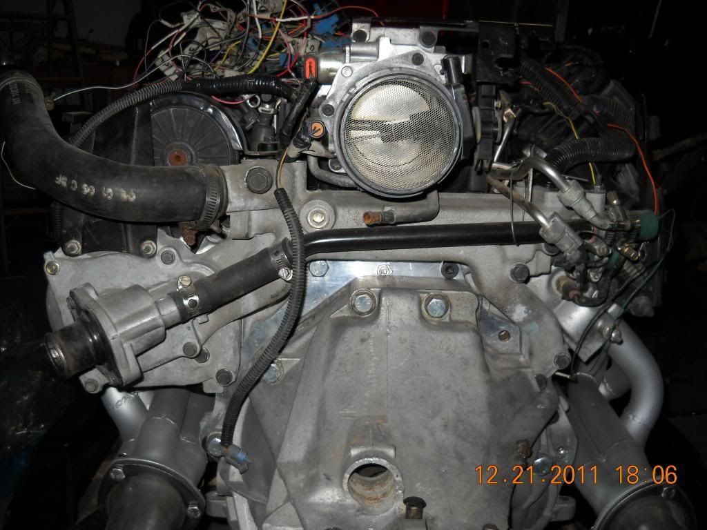

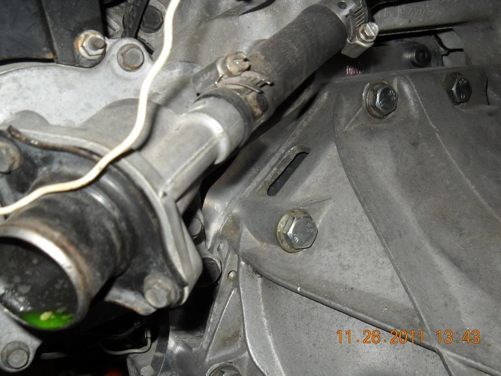

Adapting the Northstar to the Audi trany was tricky. I spent many, many hours trying to figure out the easiest and least expensive way connect engine and tranny together. I don't know how much everybody knows about the Northstar but the water pump is at the back of the engine where the tranny mounts. Along with the water pump there is a big alumium piece called a water log the connects the two heads and the contains the water pump. This water log interferes with the tranny mount. see pic.

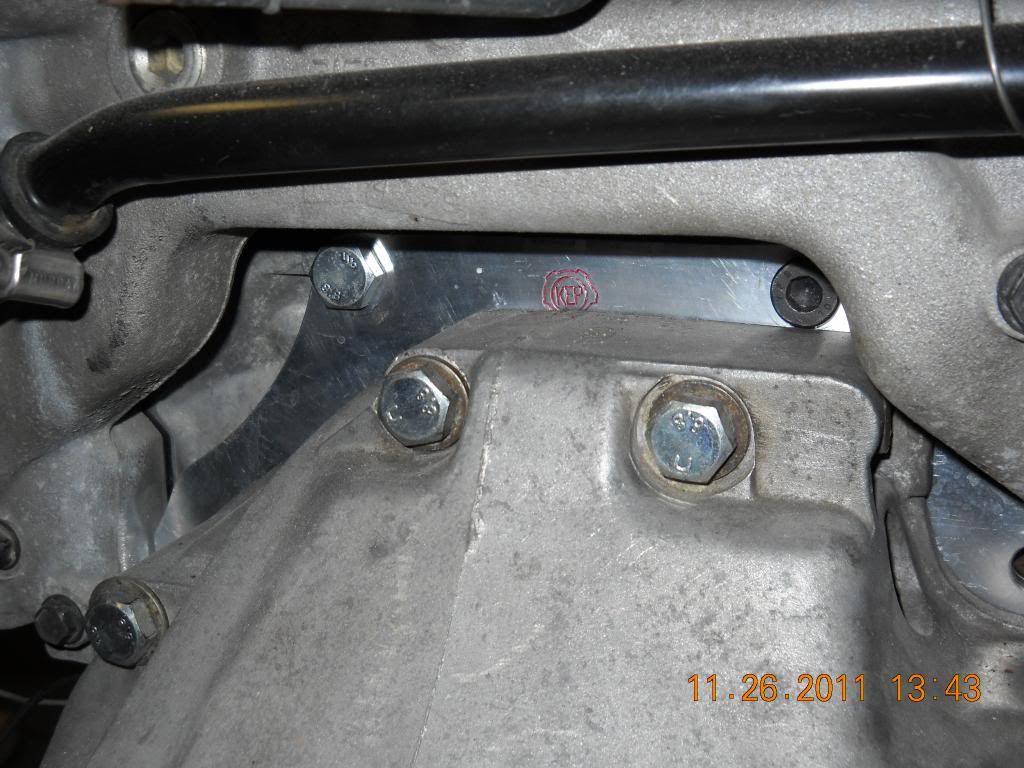

Nebraska
DEC 20, 07:52 PM
One good thing is that the Northstar has thesame tranny bolt pattern as a 60 degree V6. Kennedy Engineering sells an adapter for a 60 degree V6 to a Audi tranny. So I bought one. I figured that they did the hard part in getting everything lined up but I knew the adapter would need to be modified to fit adapter around the water log. The big problem is that where the adapter needs trimmed there is a alignment dowel for the Audi tranny. What I did was to mount the adapter to the tranny with both alignment dowels between the adapter and tranny. Then I drilled a hole through the adapter into the tranny and added my own dowel/pin. So now there are three alignment dowels. Next I removed the adapter from the tranny and cut the adapter to fit the Northstar. This cut removed one of the original alignment dowels but I sill had the other original dowel and the one that I installed to keep the tranny lined up to the adapter. Next I had to notch the tranny bellhousing to match the adapter and fit around the water log. I had a local welding shop weld in a braceon the belhousing just for extra protection. I don't have any pics of this procedure just the finished product, tranny mounted to the engine.
