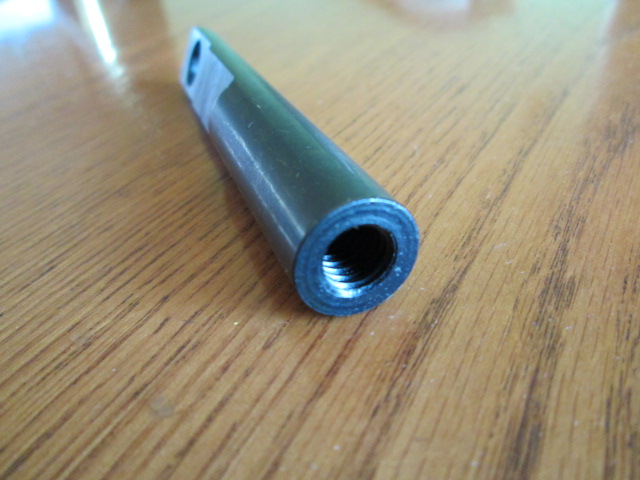

I posted earlier in this thread,that I put together a rod extension that attaches to the end of the "Tuff Stuff" booster,available from Summit Racing.Though the extension worked,it was not very pretty. This upgrade has been made more professional looking and is now very easy for anybody to complete with the brand new booster from Summit and an extension rod kit from Rodney Dickman for a total cost of just under $155.I removed my home-made rod extension and installed one of Rodney's extensions.It fit perfectly and looks good,matching up to the robust 5/8" diameter of the Summit booster rod. Here are a couple of pics of the install.

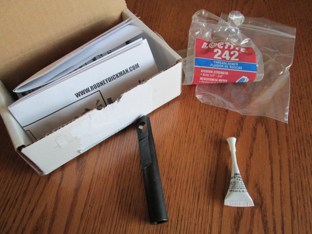

The rod extension kit arrives with the rod and some loctite for the threads
The extension is hardened and threaded to fit the Summit booster.

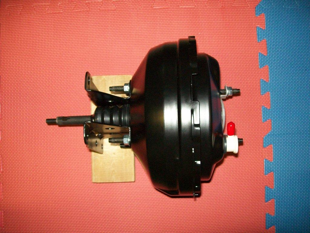

This is the Summit booster installed with the Fiero oem bracket (bracket has to be tranfered to the new booster).Sheetmetal has been adjusted to fit booster .

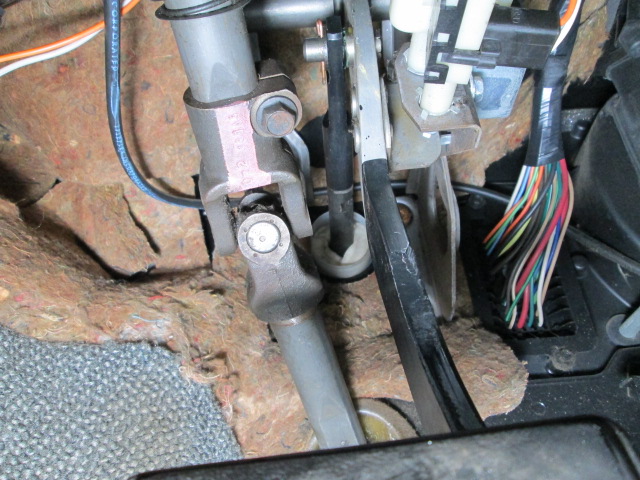

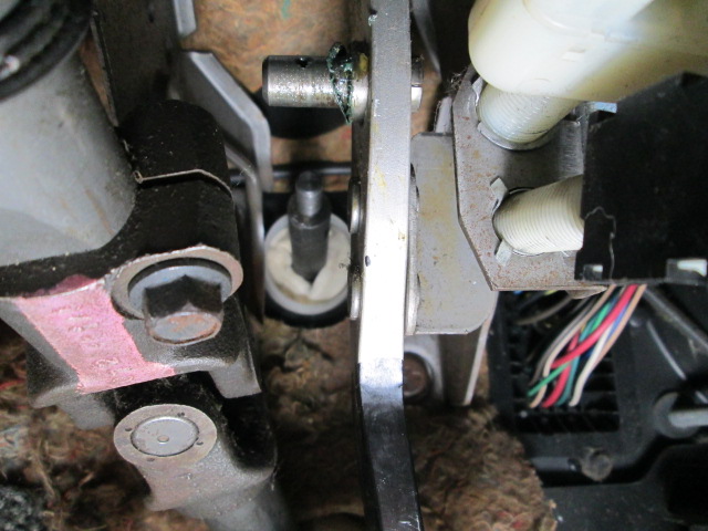

Here is the Summit booster rod as it sits with no extension,close to the brake pedal arm

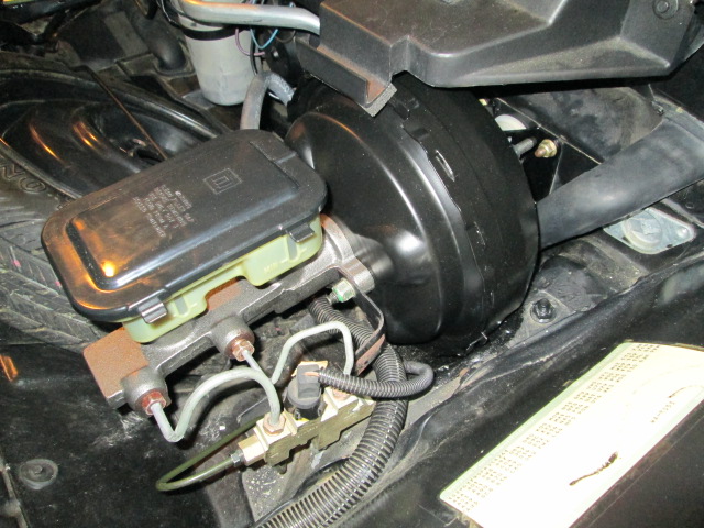

Here, Rodney's extension arm is installed with some loctite on the threads.

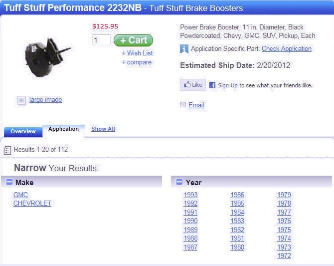

While looking for a new booster to modify, I came across this item from Summit racing.
It looked familiar so I went to the Tuff Stuff website for more info and found this
Both sites showed that these boosters would fit 1973 – 1993 GM trucks. That sure increases the number of boosters that might be available in wrecking yards! But I was looking for a new/rebuilt booster.

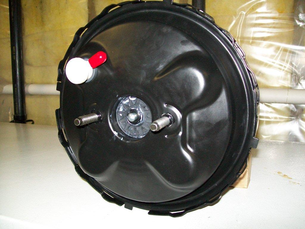

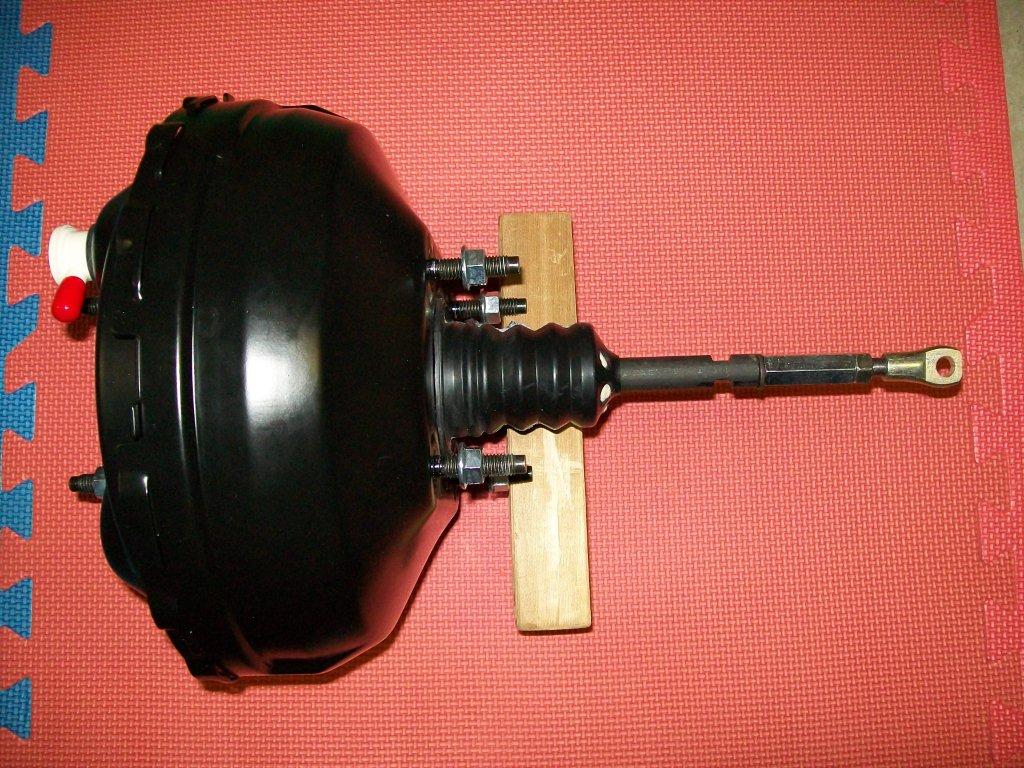

Well, long story short, since the booster looked like a match for the upgrade, I ordered one of these from Summit and it arrived yesterday. It is the exact same size booster as the one I used from a 96 s10 on my booster upgrade. Here is what it looks like:
The only differences are not bad ones. The pushrod is a whopping 5/8” diameter, is much longer than the s10 pushrod, and it has a 3/8”NC thread on the rod end.
The bolt patterns match and a new booster to master cylinder rod is included
The pushrod is closer to the correct length to fit the Fiero. An extension to the rod end is still required. My extension uses a lock washer, a 3/8” NC coupling nut, a homemade adapter bolt (coarse to fine thread),a jam nut and a rod end I had that was 3/8”NF thread (will likely need to drill the rod end 3/8” hole out to fit the brake pedal pin).
The mounting bracket that came with the new booster is unusable on the Fiero, and must be removed. Here’s the new booster with bracket removed and the pushrod all together.

While not directly plug and play like Rodney’s was going to be, I think this booster offers a rugged upgrade option with a minimal amount of work required. The cost of $125 from Summit does not require a core to be sent back.
