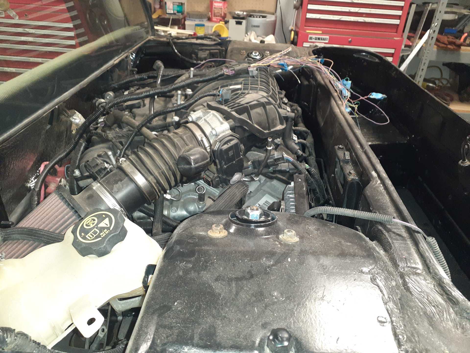

New question for you sharp people. Since the coolant flow on the LFX is reversed from the 2.8, I am trying to work out coolant flow. I am getting a custom radiator that has the flow from the engine to the radiator on the passenger side. One of the heater hoses connects to that metal line going to the radiator. Can I just run the other heater hose that comes from the heater core, directly to the water pump fitting on the LFX? (See photo)
