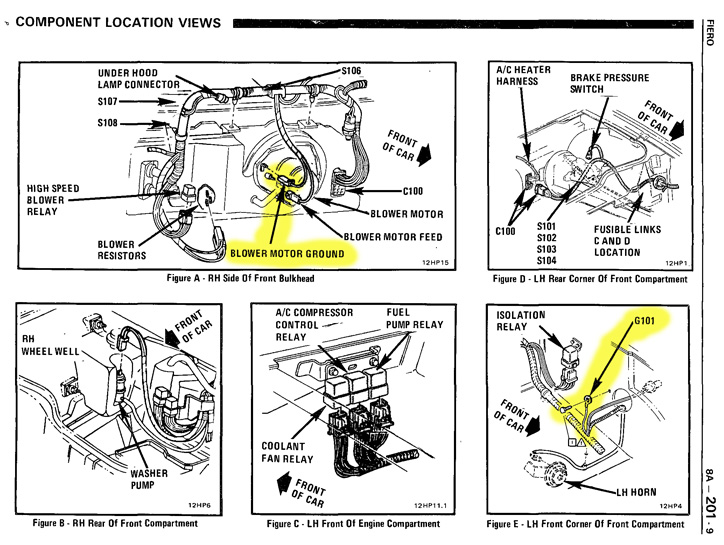

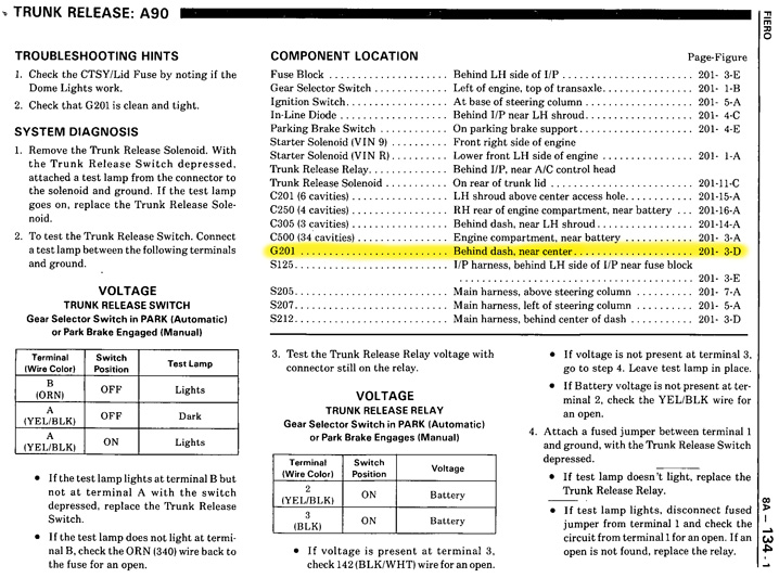

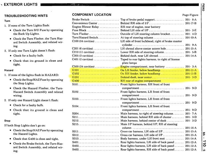

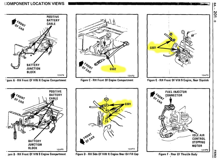

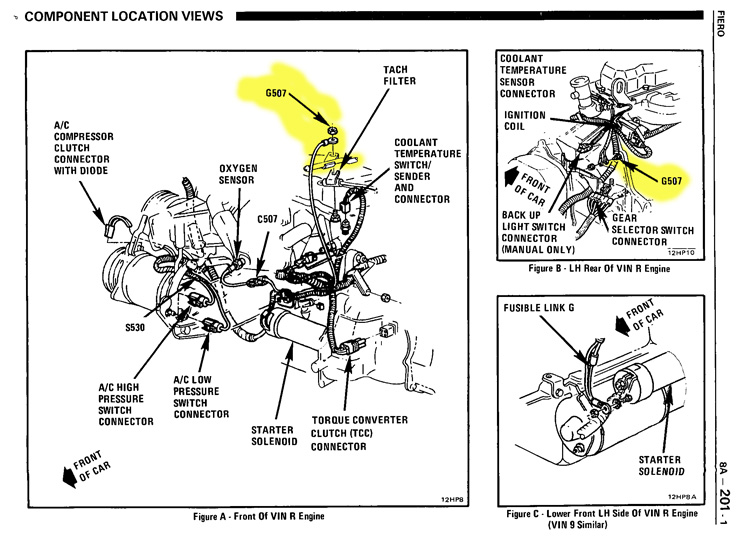

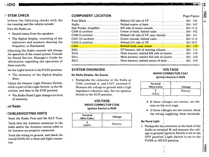

Jim_Martin29 JAN 27, 01:20 PM

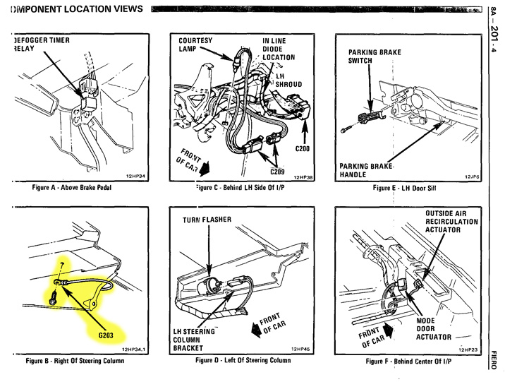

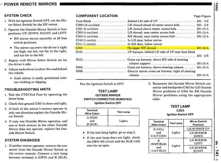

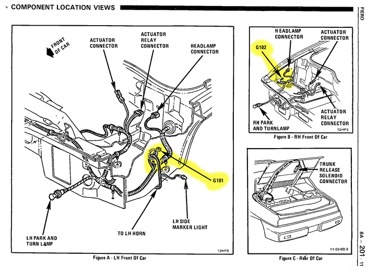

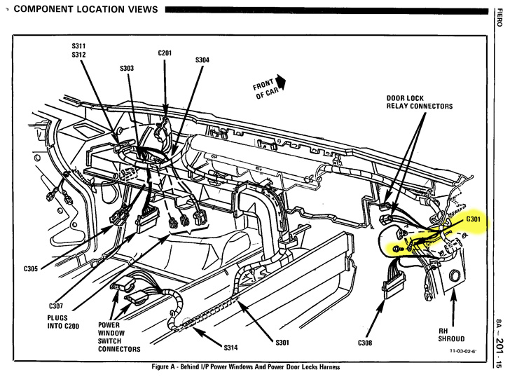

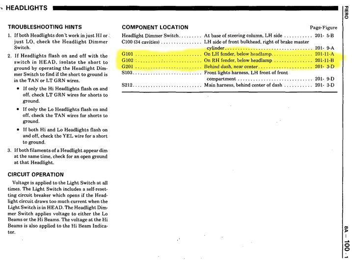

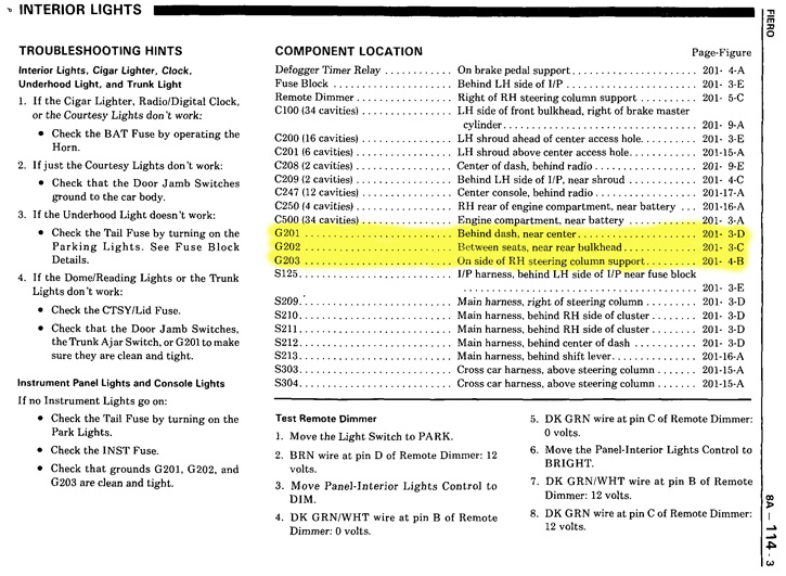

This is a great thread. I'm going to check all of my grounds this weekend, and replace what is needed.

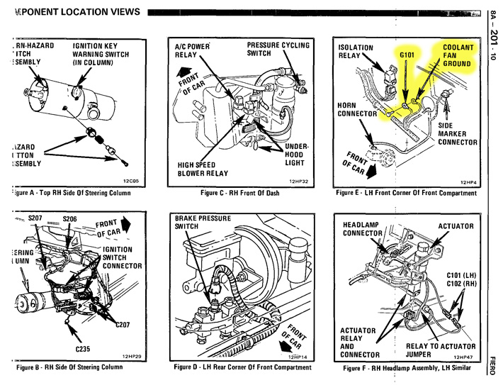

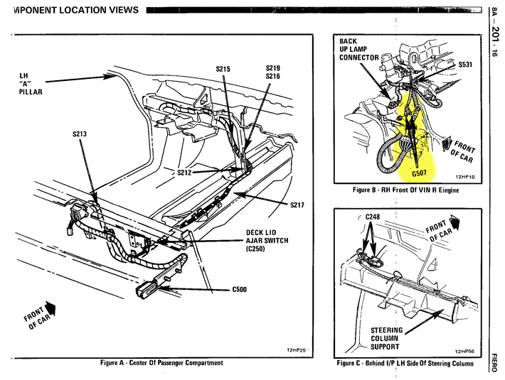

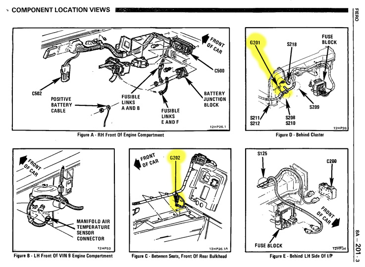

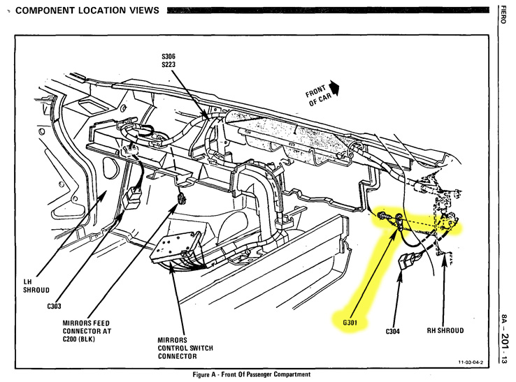

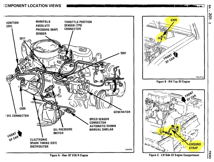

I've already changed the main, braided ground strap from the engine to chassis and it helped a bit. But I think there may still be some bad grounds (very slow electric windows and the headlights are not so bright).
This is for the new guys without manuals (and to help me focus on the grounds). It helps to find the stock grounds and confirm that they are in functional and making good contact.
I hope this helps people.
Jim Martin
White '86 GT
California
