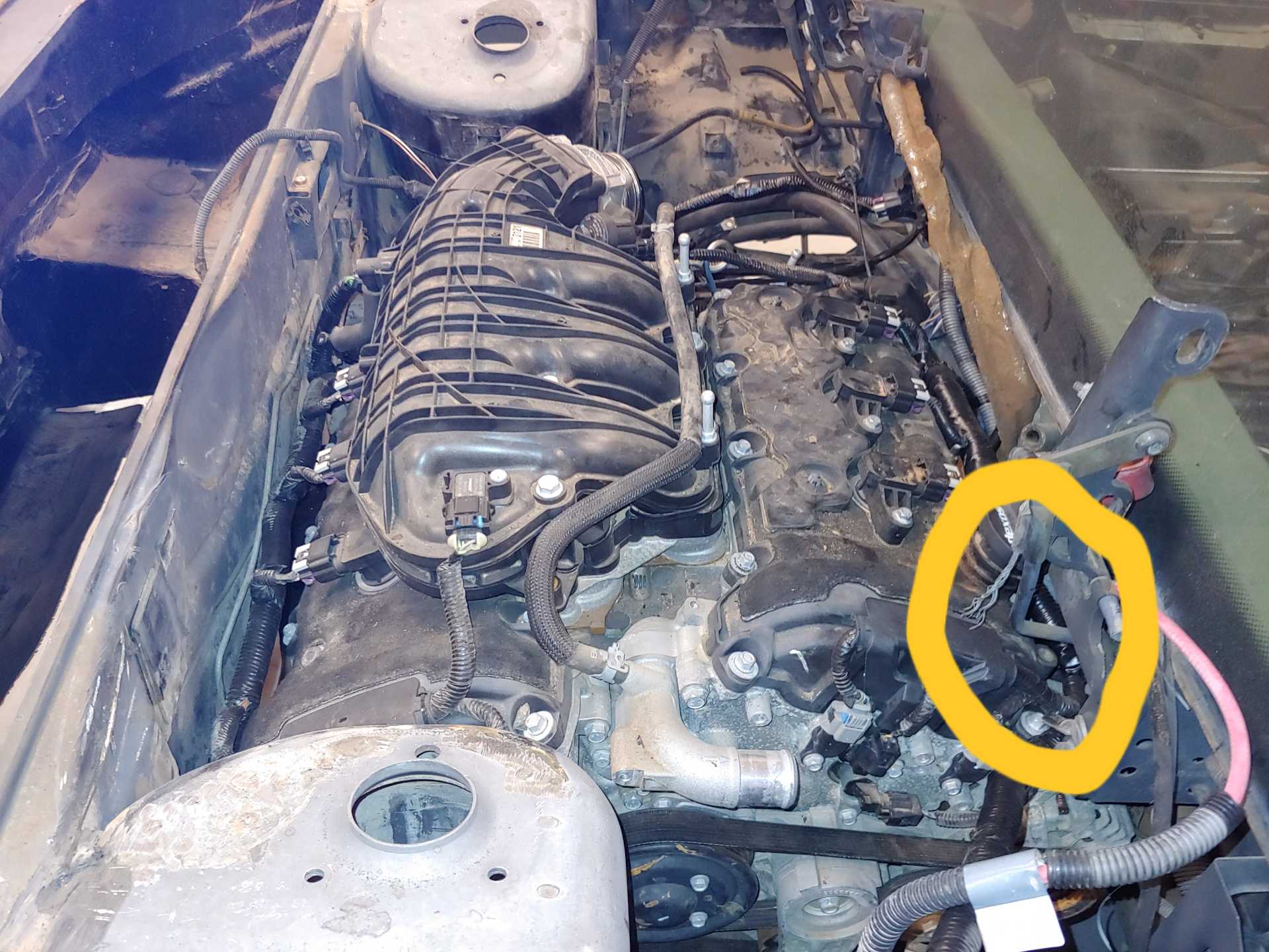

I might have "found" the issue you missed. The decklid spring; when you close the deck lid, will the following interfere with the valve cover?
I was comparing your setup to my current. I bought some mounts from linsells and they seem to position the motor about an inch FWD from where yours is sitting, Which is why I started looking at clearances...
Daryl M
MAY 01, 02:33 AM
Yes, the spring was close. It didn't actually touch, but it was close enough for me to decide to make a change. Considering a gas tube lift setup. I'll see what I can come up with when I get back to work on the car. Building a SheShed for my wife right now.

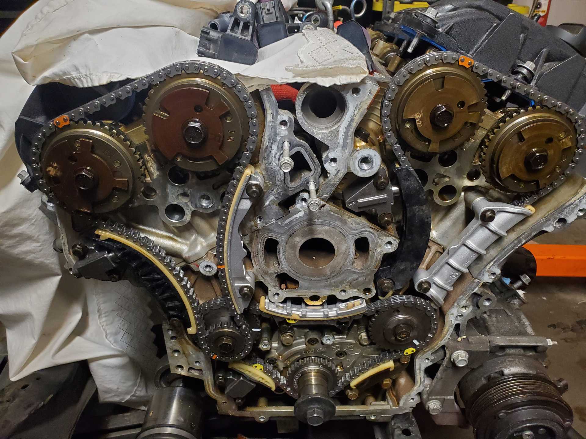

Good deal! I took that one off. I *might* take both off, but thinking that through. I'm catching up to you though... decided to replace the timing chain just to be on the safe side.

Cool. They went with a two stage timing drive like the Northstar, but because the engine has split crank throws, the bank offset is much larger than the Northstar's allowing the one-in-front/one-behind relationship of the secondary chains to the primary chains.
It's also pretty wild how intricate the front cover casting for that engine is.[This message has been edited by Will (edited 05-05-2020).]
