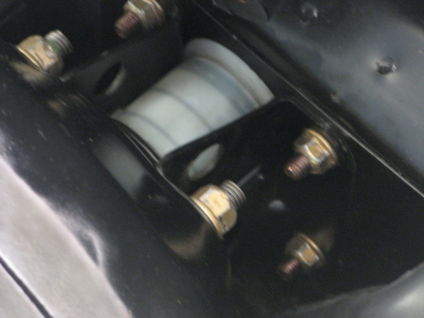

I put mine in on Wednesday and I could tell a difference. I didn't think it was "night and day" different but it was better. I wasn't disappointed but also wasn't thrilled. Then the next day, I was talking to another Fiero guy and he brought up the subject of rear calipers and the need to use the parking brake periodically to keep the brakes adjusted. That got me thinking.....
So, I went out and pulled my e-brake and let it back off again. I had not used it in a while because I didn't want the brakes to freeze up through the winter. Then I went driving and that is when the magic happened! Now I see what everyone was talking about! Now I agree, "night and day" difference for sure! Very glad I did this mod!
I did have a few problems. Nothing major really, just me not doing everything in the right order and remembering stuff. I did cut down the four bolts on the booster that point toward the firewall as installed. They would have made tightening the mounting nuts EXTREMELY difficult if I had not done it.
