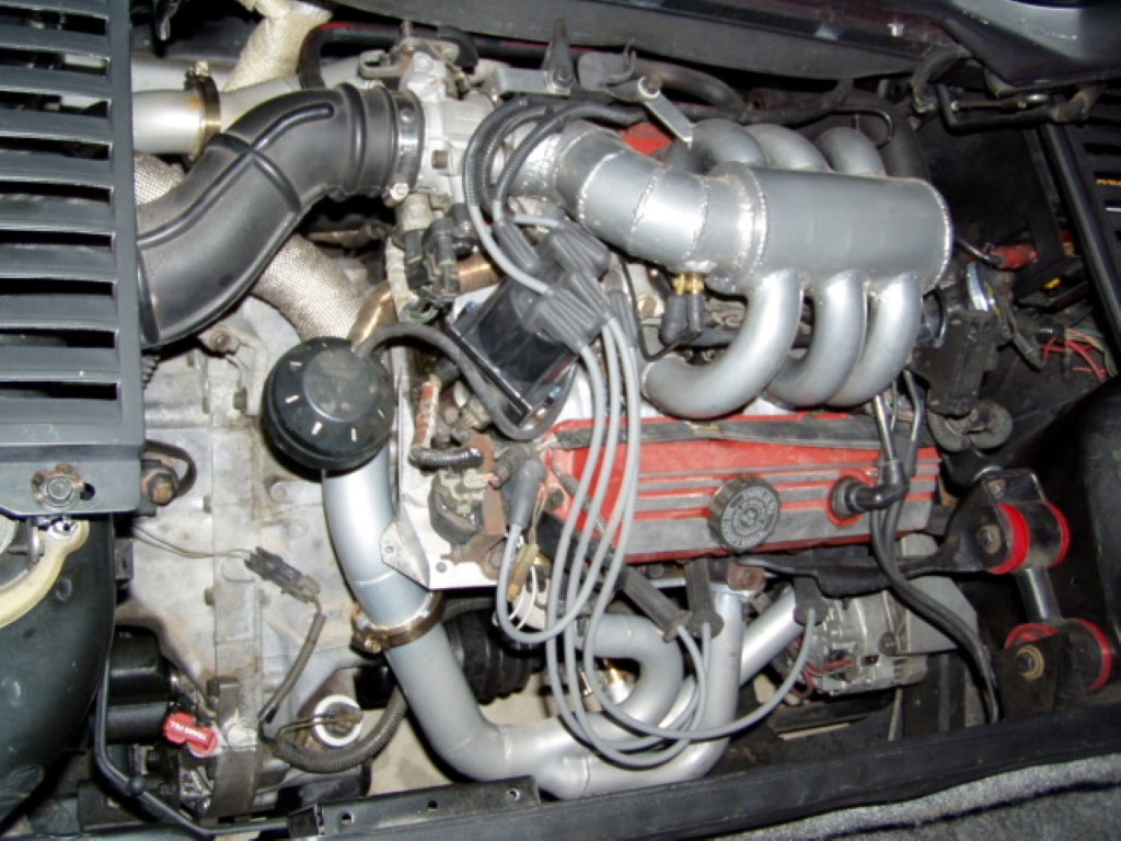

FOCOA headers are really good, if you can find a set. They've been out of production for a long time, though. Trueleo headers (pictured above) are probably as good, but are not as pretty, IMHO.
This was my setup. 3.4. 272 cam. FOCOA headers. Trueleo intake. Ported lower intake and heads. Had as much "stones" as my 4.9.
