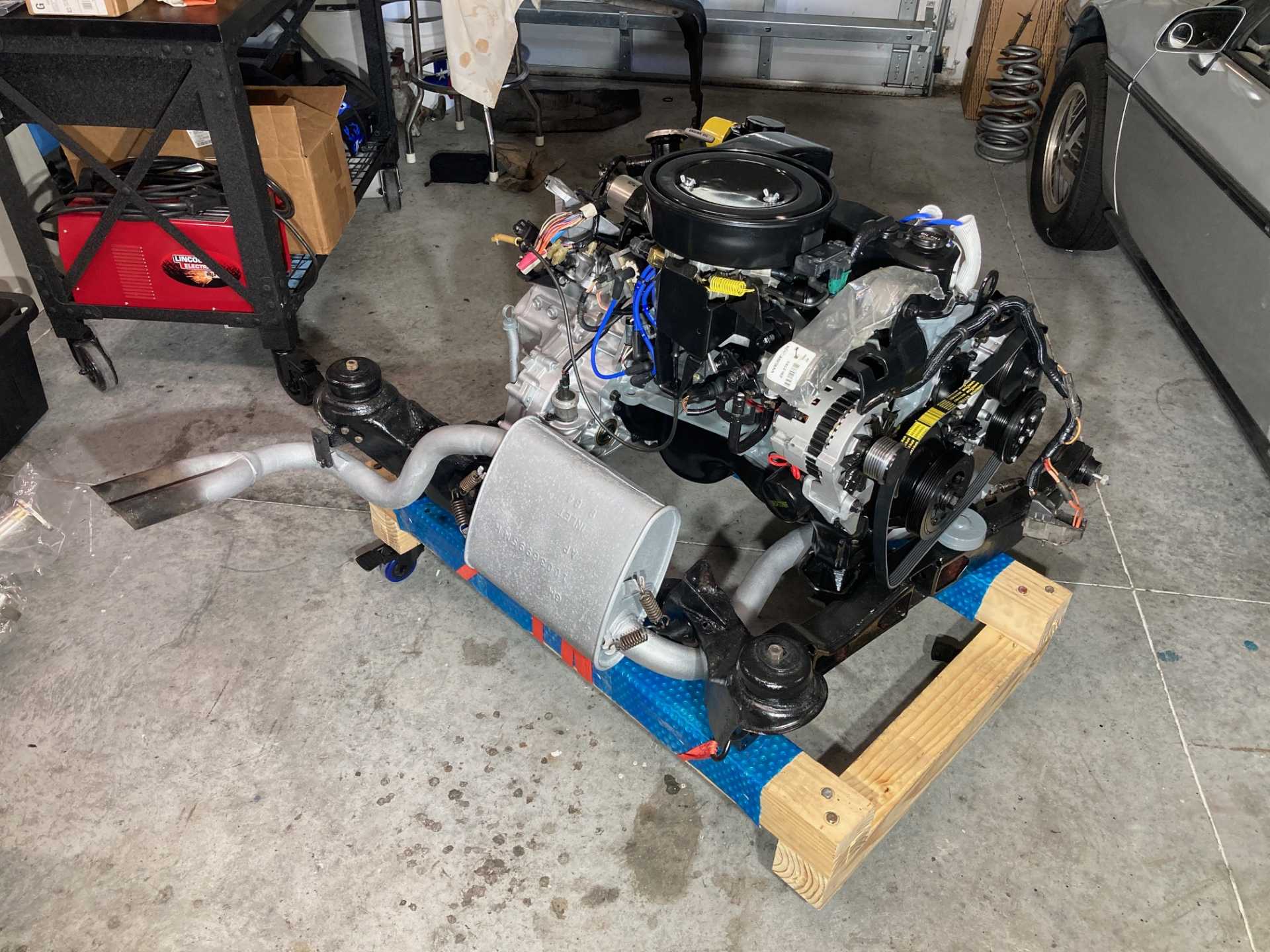

Also, off the cuff, but if you're going to build a new motor... my recommendation is to get yourself another cradle, and build an inexpensive cradle dolly. You can then build the engine on the cradle while you still have your car complete and ready to go. It seems like most people don't really consider this, but it dramatically improves the efficiency of your time and efforts, and limits the down-time of your car being out of commission.
Imagine being able to calmly build your perfect engine swap on a cheap yet super sturdy engine cradle dolly, as you continue to enjoy driving your Fiero every day. Exhaust, turbos, suspension, you name it... all installed and ready to go on the cradle ... so you only have to spend an afternoon swapping it out (Note, may require two cradles dollies for obvious reasons).

| quote | Originally posted by 82-T/A [At Work]: Also, off the cuff, but if you're going to build a new motor... my recommendation is to get yourself another cradle, and build an inexpensive cradle dolly. You can then build the engine on the cradle while you still have your car complete and ready to go. It seems like most people don't really consider this, but it dramatically improves the efficiency of your time and efforts, and limits the down-time of your car being out of commission.
Imagine being able to calmly build your perfect engine swap on a cheap yet super sturdy engine cradle dolly, as you continue to enjoy driving your Fiero every day. Exhaust, turbos, suspension, you name it... all installed and ready to go on the cradle ... so you only have to spend an afternoon swapping it out (Note, may require two cradles dollies for obvious reasons). |
Yes and no... what you say is definitely true for bolting together stock parts.
However, when making custom parts, then the cradle needs to go in and out of the car to verify fitment.

That's a really good point that I totally glossed over. I still think the extra cradle can be a good idea, but I wonder if it would make sense to design say... a cardboard or fiberglass "box" that you could use for measurement purposes. Something that you could loosely build and measure in the engine compartment and then be able to place (at pre-defined points on a stock cradle) where it would go so you could ensure your complete engine system fits within those dimensions.
Height is always the one that I forget about too. Even the Iron Duke comes within an inch of the decklid... they had to notch out space for the air cleaner on the 84's grill.
