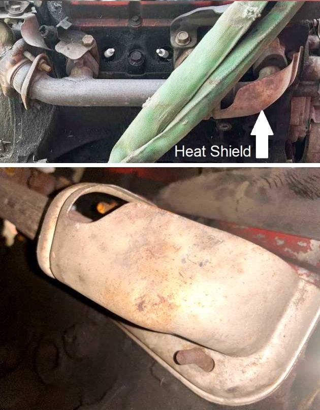

Vintage-Nut
JUL 11, 03:21 PM
| quote | 82-T/A: If you can't find it {heat shield}, you might be better off just upgrading to the CS130 alternator. |
| quote | theogre: Alt Heat Shield Missing maybe because has upgraded to CS130 & didn't fit. |
IF you upgrade to the Delco CS130 alternator; look for a used '88 alternator heat shield which it is mounted on the head cylinder and covers the exhaust manifold.
'88 Alternator Heat Shield / GM 10065518
JUL 11, 04:12 PM
| quote | Originally posted by Vintage-Nut:
IF you upgrade to the Delco CS130 alternator; look for a used '88 alternator heat shield...
A couple more images of this heat shield.
JUL 11, 04:23 PM
⚠️ Alt Heat Shield Missing maybe because has upgraded to CS130 & didn't fit.
Look @ side plug. 12SI plug only take 2 wires & nothing but only grease/oil if lucky to keep "water" out of it. CS130 have space to take 4 wires in "water proof" plug.
The opening post includes an image with what looks like the older style 12SI alternator.
