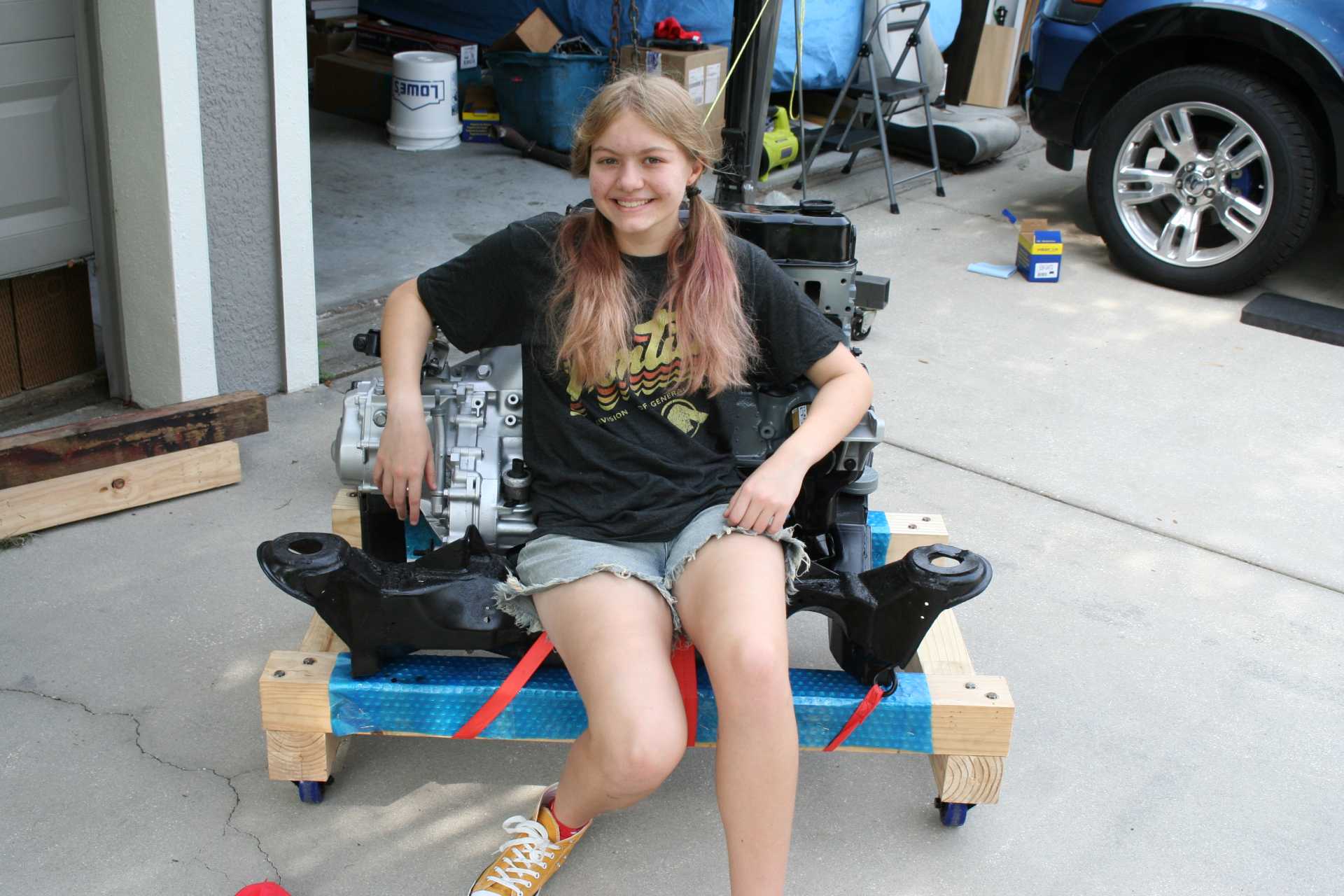

I'll document it once my daughter gets to that point. This weekend we're pulling heads off the 3.4, and then putting the intake and exhaust manifolds back on the Iron Duke.

Here's a quick status of where we are on the engine... I'm cheating... my daughter is like 3 videos behind... but never the less...
