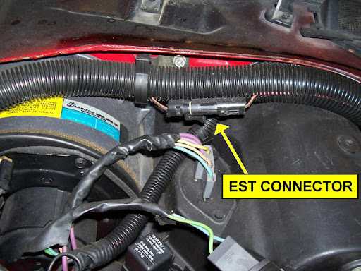

you aren't wrong. It's gonna be closer to 50 later this week, I'll go fight with it then! Until then, does adjusting timing work the same way as it would stock? Unplug the connector, jump the aldl, and move the dizzy until -10? or is something weird now with the MSD box present?

| quote | Originally posted by Additivewalnut:
Unplug the connector...
What connector? (If you're referring to the IAC harness, that's not normally unplugged during ignition timing... but in your case might be necessary just to get the RPM within the correct range.)
...jump the aldl, and move the dizzy until -10?
If that's where it is now, no wonder the engine runs like crap. Look at the specs under your decklid, but I believe it's supposed to be +10°.
I wouldn't expect setting the base timing to be any different with the MSD box present, but I don't know for sure.[This message has been edited by Patrick (edited 01-23-2024).]

What connector?
Isn't there a single pin connector I have to unplug? On my 89 camaro, same 2.8, you had to unplug a single pin connector near the firewall and jump the aldl. Called the EST wire.I guess the Fiero doesn't have that?

Nope, just short the correct pins on the ALDL
