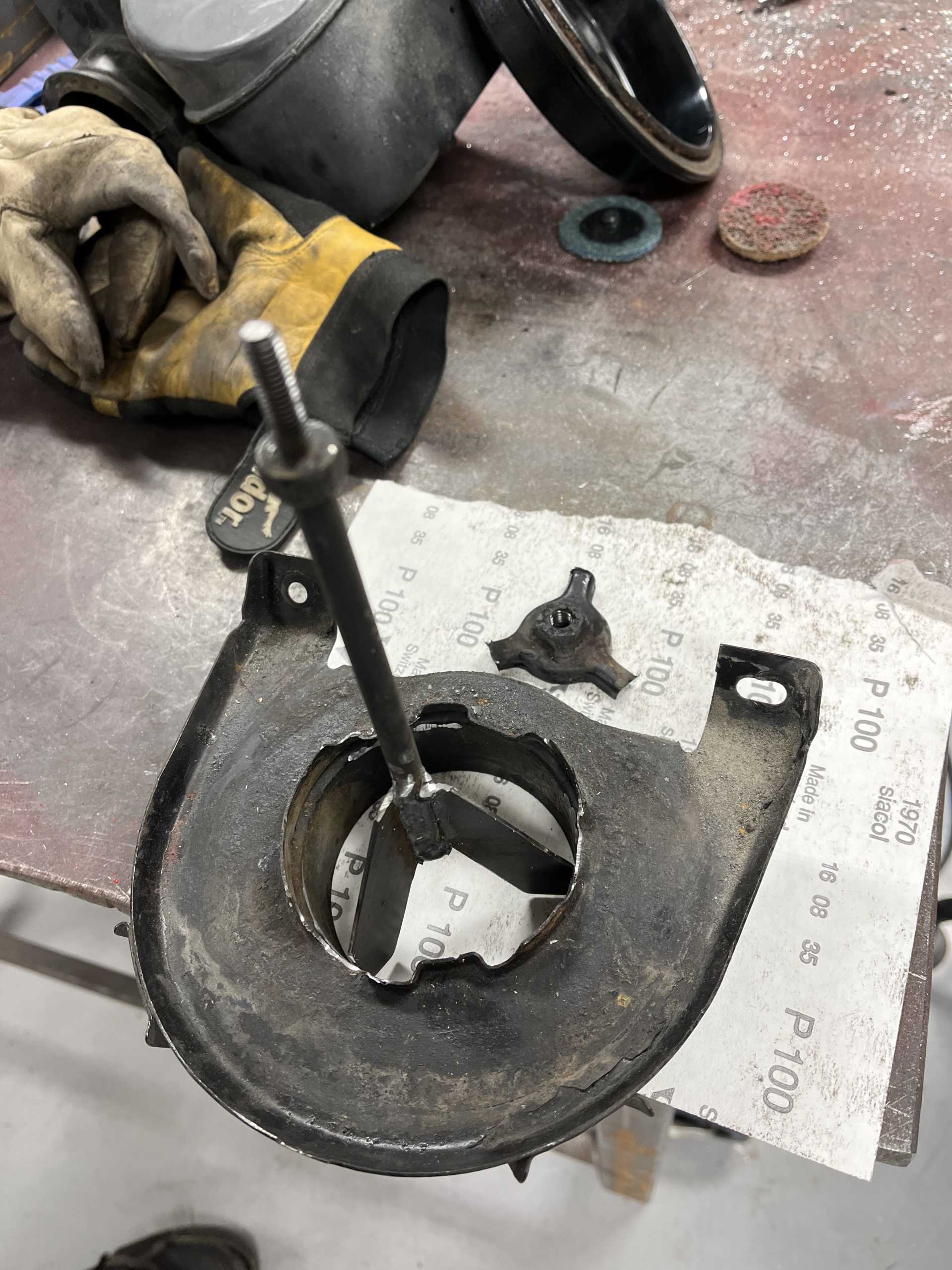

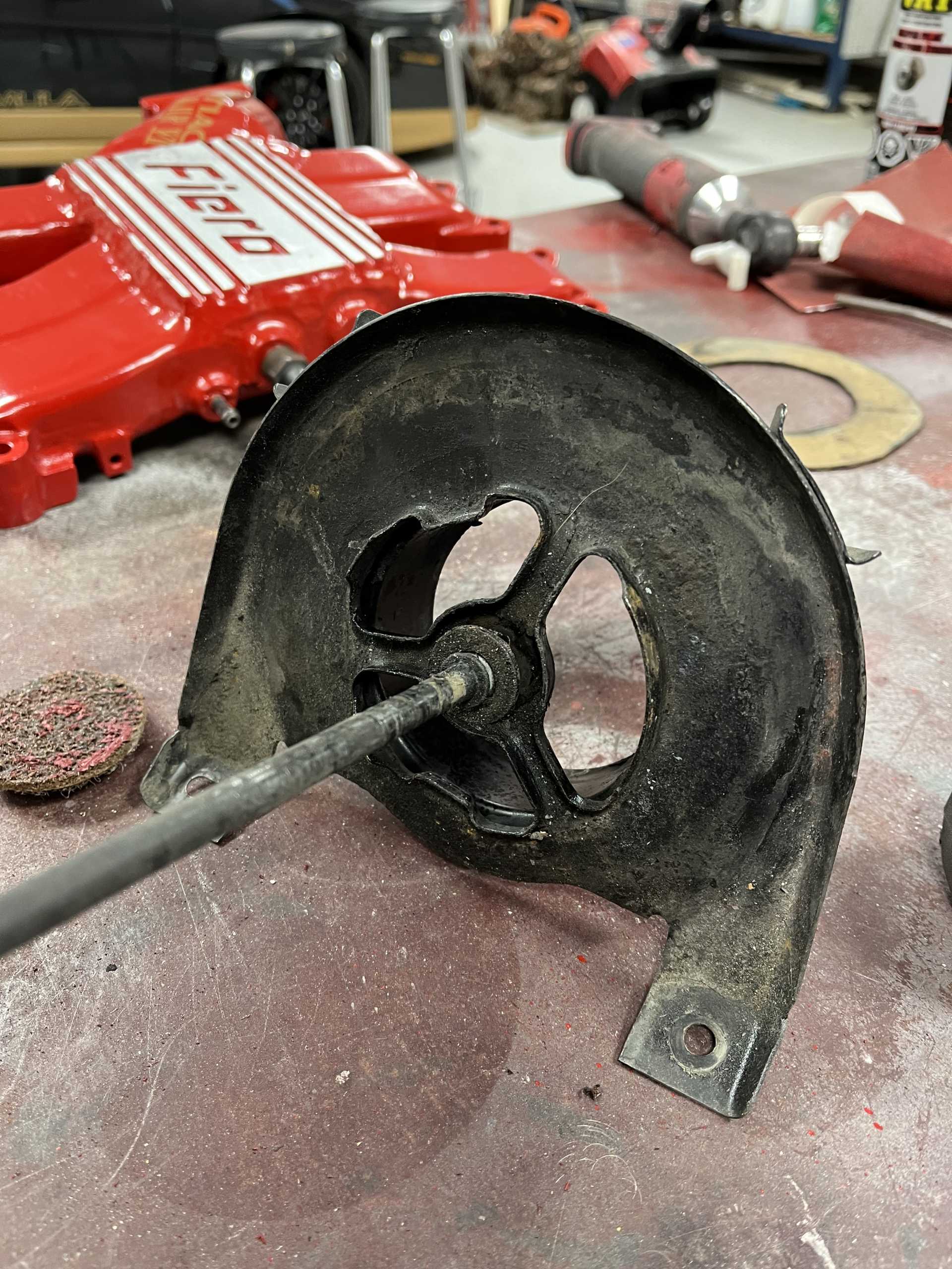

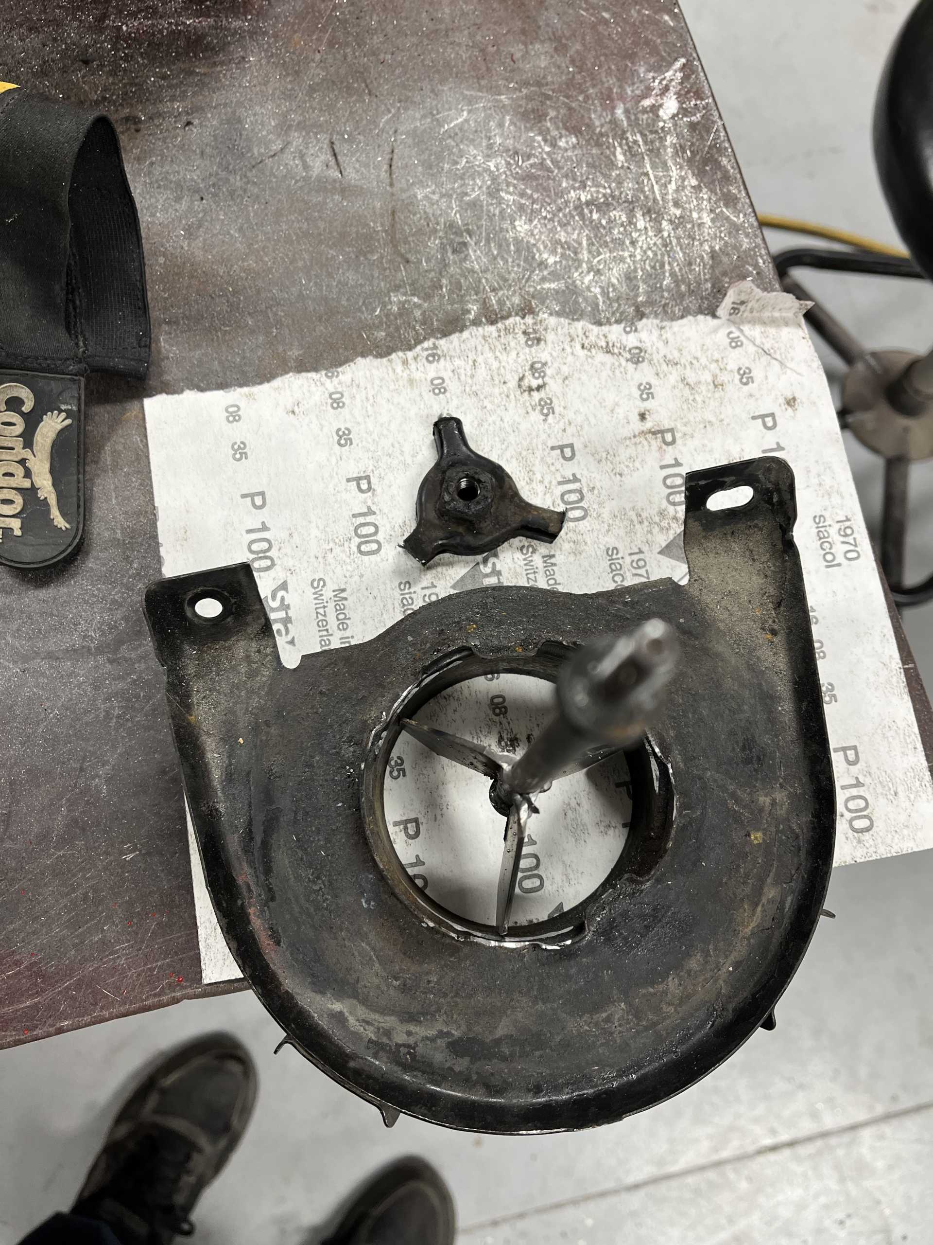

As I said I will show some more mods to increase airflow
 I am going to get rid of the intake muffler and open up the filter base restriction
 I will remove the screw rod mount and build a new one with a couple of square inches less restriction
 by doing this mod the cross section is much less and next i will work on getting rid of the intake muffler

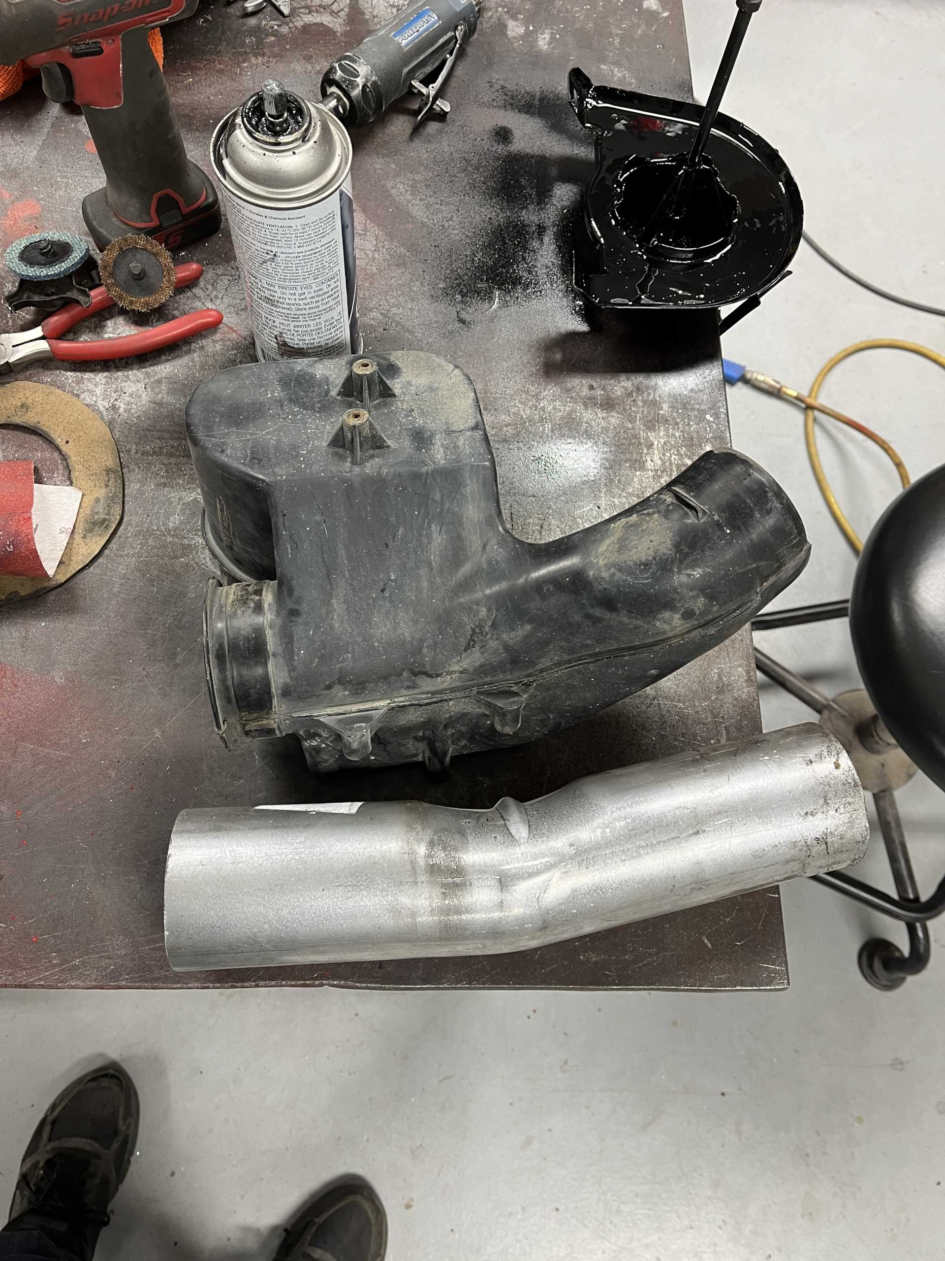

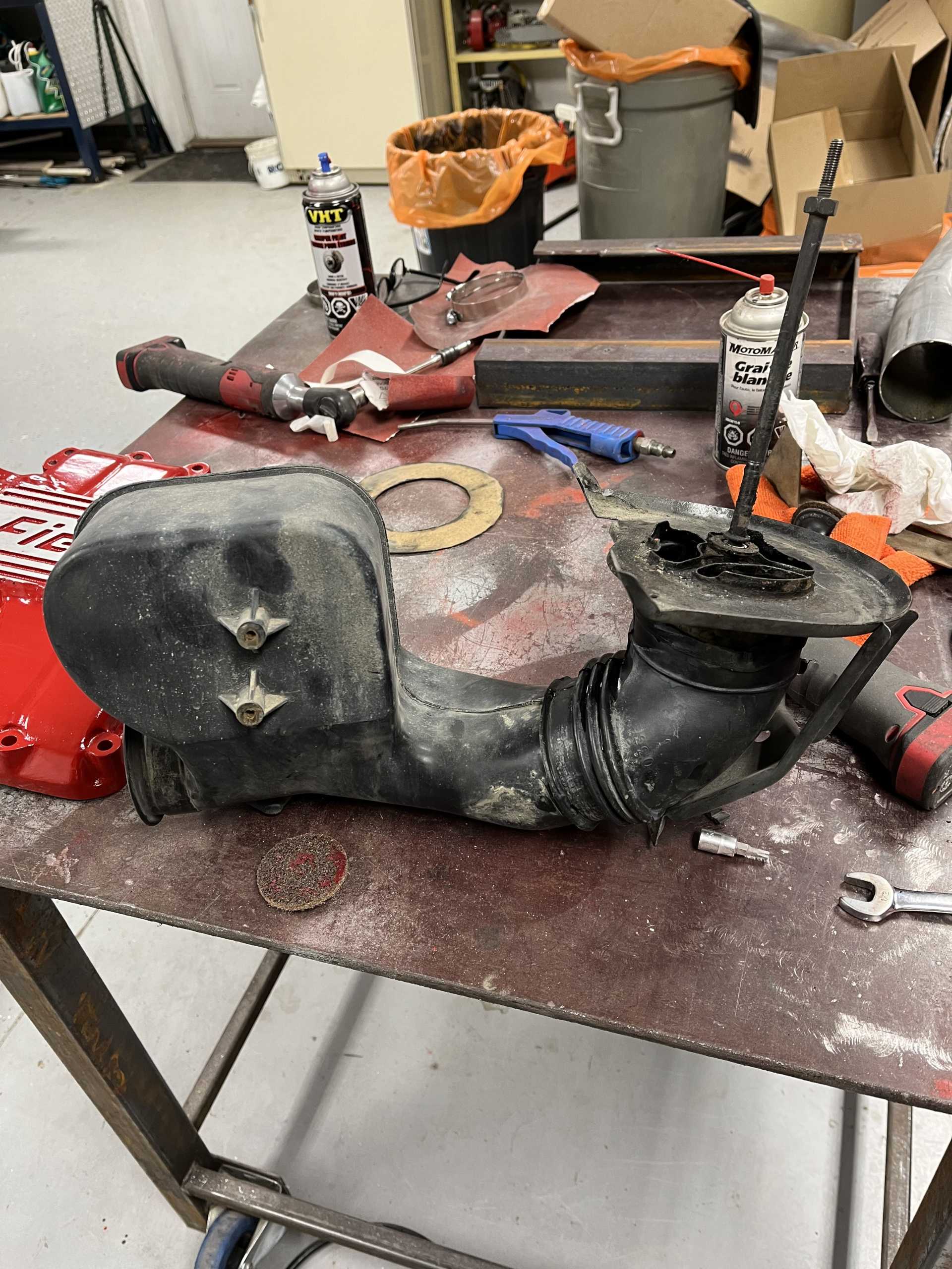

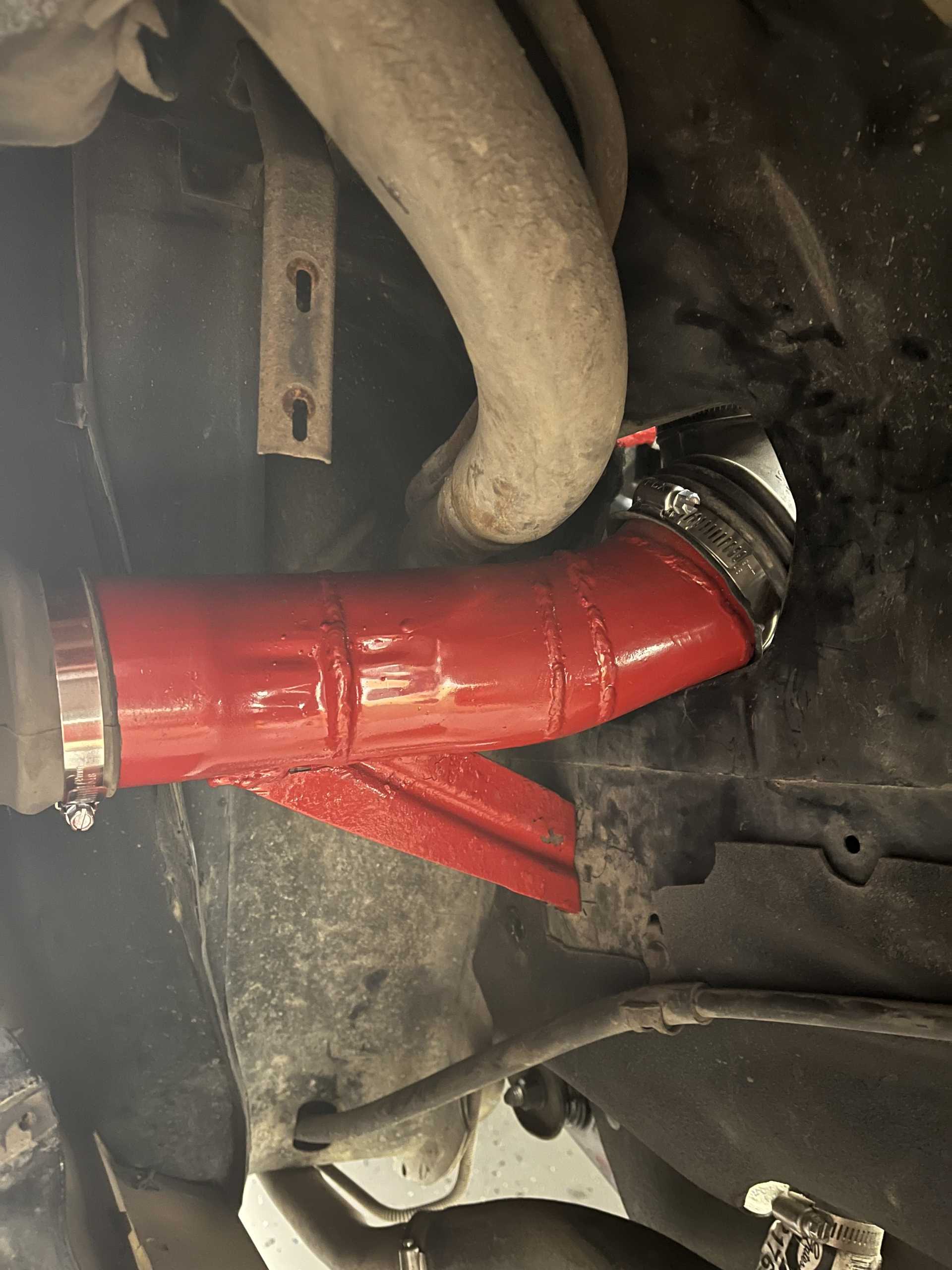

sleek fiero
DEC 17, 11:46 PM
so I got a foot of 3" pipe and had it bent a few degrees. Then I cut ,fit and welded until I got the right shape. I used the old Muffler mount and welded it in place and installed back in the wheelwell
I already have a side scoop I built before so now when warm weather comes we will see if these mods were worthwhile. sleek
