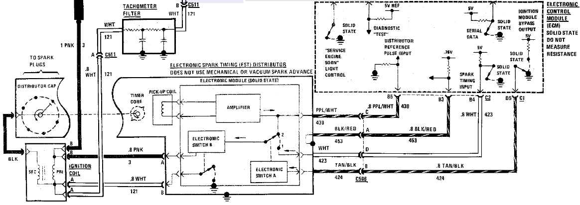

I put the scope on the white wire between the IM and the coil and it is definitely missing pulses. I see the same thing with the scope on the disconnected tach filter wire. Not sure which wire is from the ECU to IM so if anyone knows, please let me know.
Signal looks like it has switch bounce when going to ground and then spikes to around 60 volts positive. Not sure if that 60 volt spike is normal/acceptable or if it means the ECU is/has failed. I have tried a separate ECU but they are both 1988 with 150,000 miles plus.

I've checked and replaced the mini harness from the coil to the ICM with no change. I've also checked and replaced the wires from the pick up coil to the ICM with no improvement. If I'm understanding the print you included correctly, putting the scope on the PPL/WHT wire should let me know if the pick up coil is working consistently.
I did learn that the scope signal I was seeing on the tach wire is what I should be seeing. The high voltage is the spark starting, reduced voltage that I thought might be switch bounce is actually the flame front. YouTube has lots of generic info on using an oscilloscope on an ignition system. Just not why I'm missing pulses.
