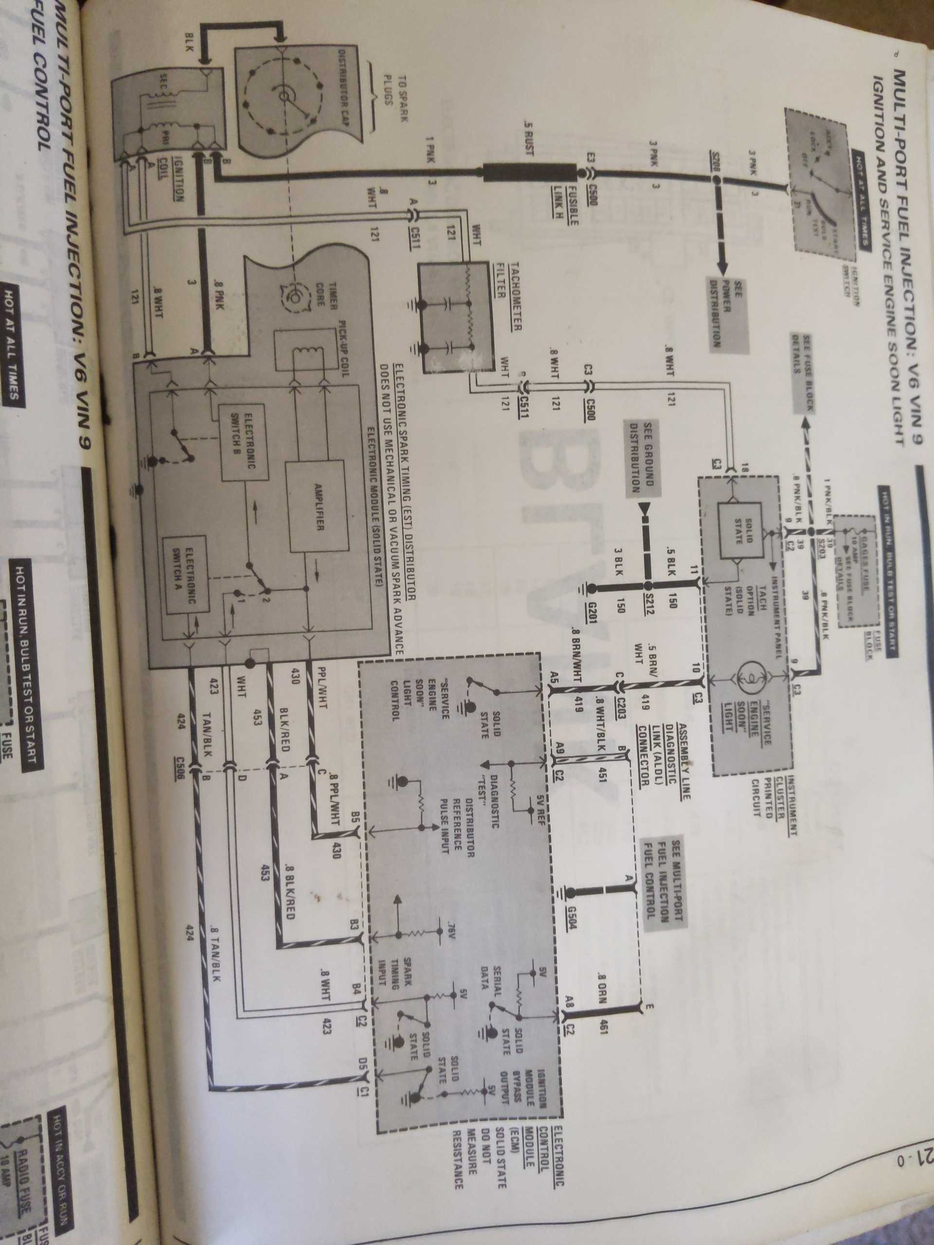

Here is the ignition system schematic.

What does that short wire do between the coil and the distributor... ?
It acts like a tether to keep the distributor from floating out of the engine bay.
The ICM instructs the coil when to fire, the same as breaker points do on older ignition systems.

Thank you Patrick. That struck me while I was away for Easter (just got back) .
The coil is not constantly firing for 6 plugs, So I deduced the firing comes from pulses from the ignition pickup, signaling the ecm in the base,and out to the coil through the short and only wire between the two.
So , had someone turn it over, ignition on with a multimeter.
Nothing.....The wire is dead.Cost of a distributor with all the parts is not bad.
So, that next. Reload shotgun : )
