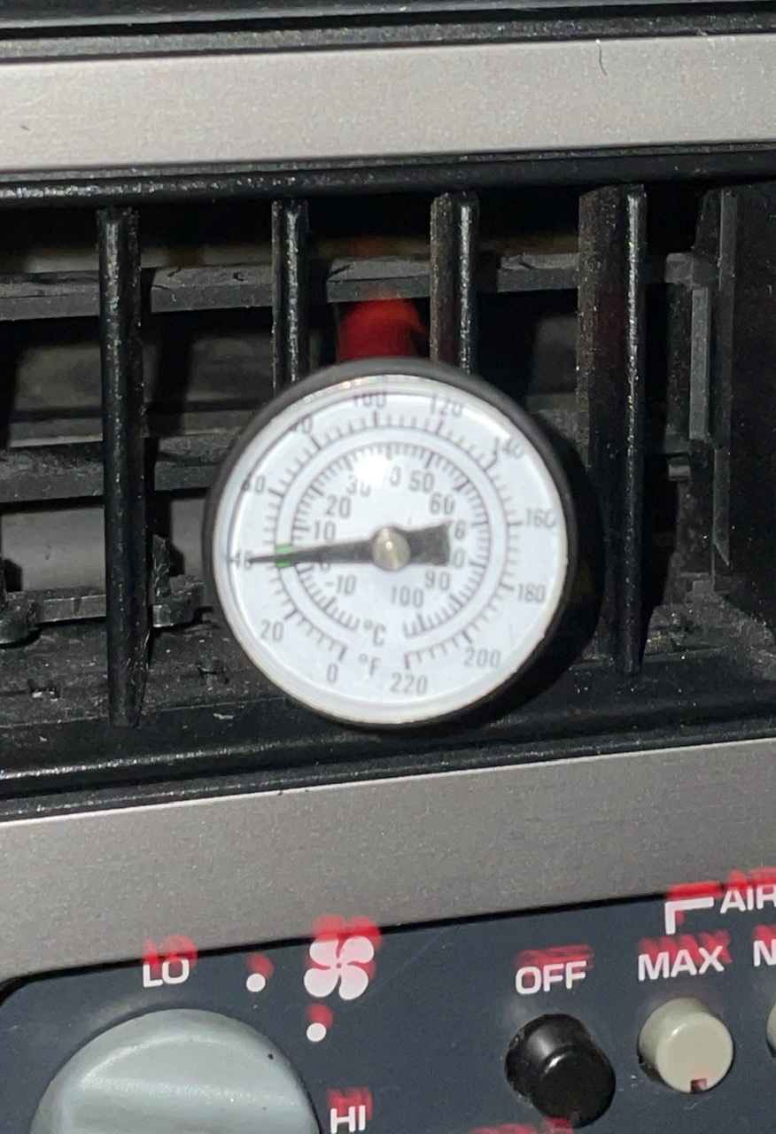

Oil on the orifice tube is normal. Looks nice and clean. 3 12oz cans will generally get the job done. Drive it around with airflow through the condenser and see if the vent temp gets down to 40 F. Check gauge readings again after a drive, high side should get over 200.
Make sure you ask the shop if they added more oil, and what type.
Xenoblast
OCT 27, 10:02 PM
| quote | Originally posted by RWDPLZ:
Drive it around with airflow through the condenser and see if the vent temp gets down to 40 F. Check gauge readings again after a drive, high side should get over 200. |
Goes down to 40 degrees at 60 mph
High side at 175psi after drive. Honestly Im gonna blame the gauge, its a rental from autozone.
