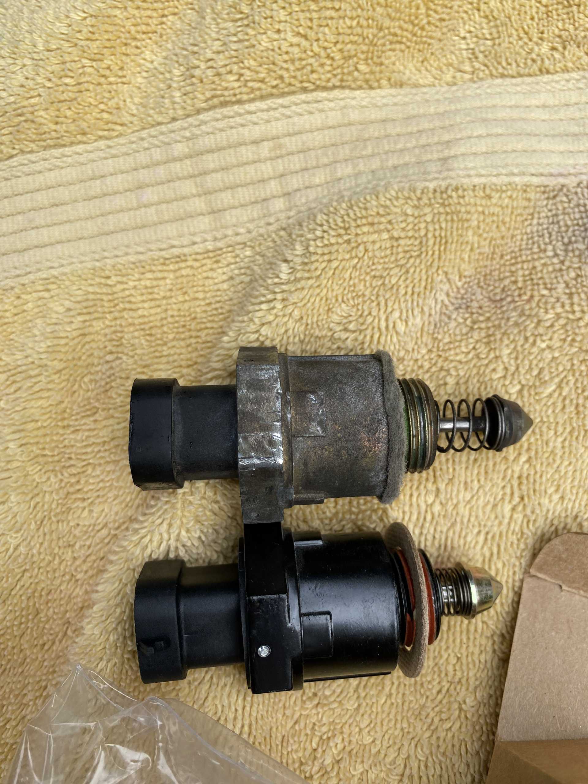

I think I see your problem.
I take it that both of those IAC"s were removed with Engine-Off/Key-Off. When key is turned off the plunger withdraws from the port to allow idle air for the next start. Just turn the key to start, no need to push on the gas pedal.
The old IAC shows plunger extended which would block idle air when trying to start the engine, however working the gas pedal at same time as cranking may successfully allow the engine to start but would kill the engine once foot leaves gas pedal.
Since neither one seems to work correctly it may be time to acquire an automotive multi-meter and check the harness connector for the IAC to see if you're getting the proper electrical signals.
I could be all wrong about this and I welcome others to jump in and set the record straight.

The top one is taken out of the car after sitting for 24 hrs, not run. The bottom new one is shown as it looks right out the box. To recap; as it stands now, car starts after several attempts, idles very high a few seconds and dies. We haven't tried keeping it going manually by the throttle linkage... yet.
Ok so how do I test it and what reading am I looking for? Steve

SEP 30, 07:55 PM
This link can help. Scroll down to "Idle Air Control Valve (IAC)".
http://www.gmtuners.com/tech/TPS_IAC.htm
ps: gmtuners is your friend...

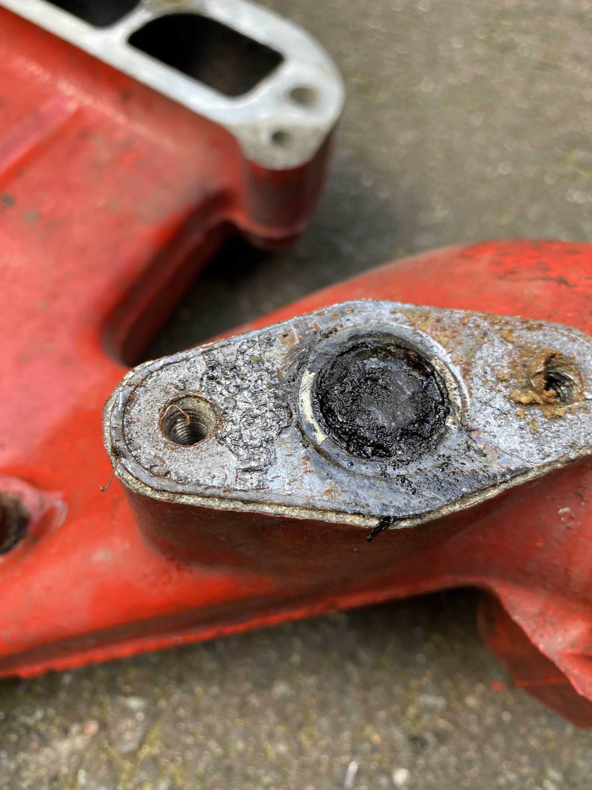

Well a replacement TPS didnt do anything. Same. Engine starts hard then idles 3 seconds and dies. So my mechanic took the intake off looking for vacuum leaks. But we did find this...

Well the latest in the saga. Cleaned out the entire plentum and EGR port (see pic above). Checked EGR tube; spotless Replaced TPS Replaced Coolant Sensor Removed cat and checked it.
Still same result, nothing changed. Car starts hard, runs a few seconds and dies. As before it can run if someone is constantly feeding the throttle. But let go and it dies.
Running out of things to replace and nothing seems to improve it.
