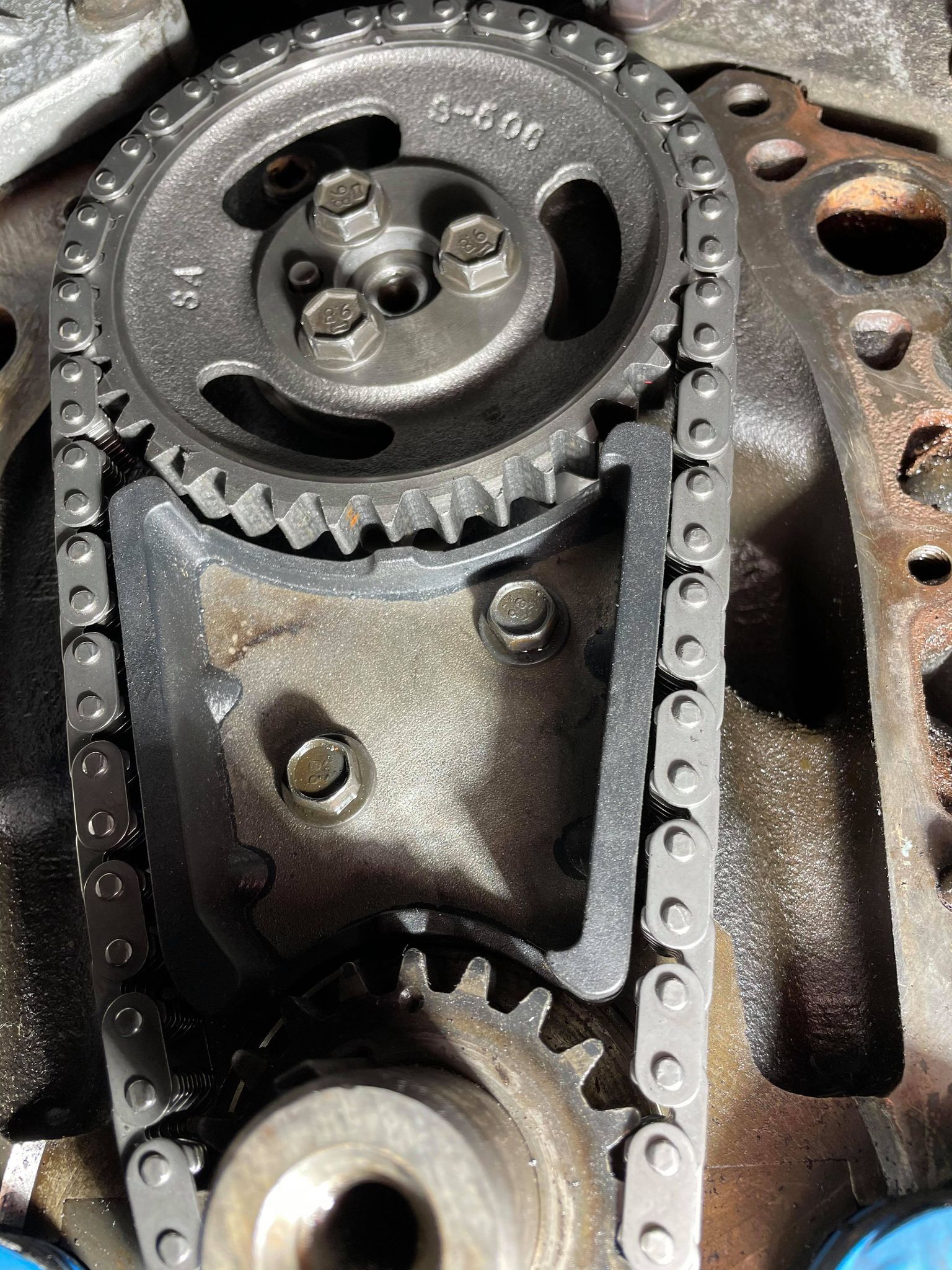

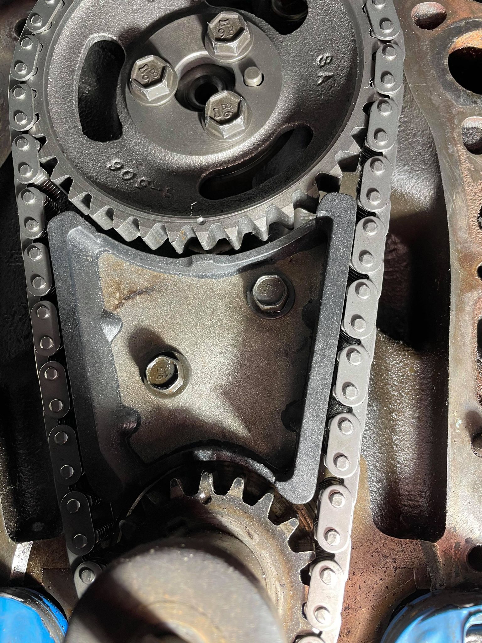

Took the timing chain cover off. Chain didn't look too stretched, but replaced it and the sprockets anyways.
It does appear that things might be 180 degrees off though. When the sprocket dots align, the distributor is pointing to the #4 wire like this:
When its at #1 TDC on the compression stroke, it looks like this:
Should I go ahead and rotate the cam around so the dots point at each other at #1 TDC, or does it even matter?
Should I go ahead and rotate the cam around so the dots point at each other at #1 TDC, or does it even matter? |
The camshaft rotates at exactly half the crankshaft speed. So if you line the dots up in one direction, it will line up the other way also if you spin the motor over.
I would put it dot to dot and set your distributor to #4. Pull the plug on #4 to make sure it's at TDC. Also check and make sure both valves are closed.[This message has been edited by fishsticks (edited 06-02-2021).]
