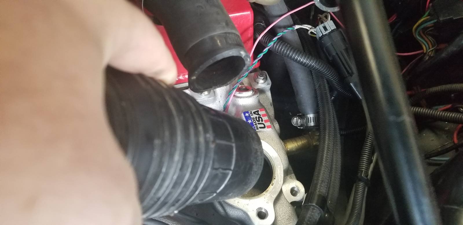

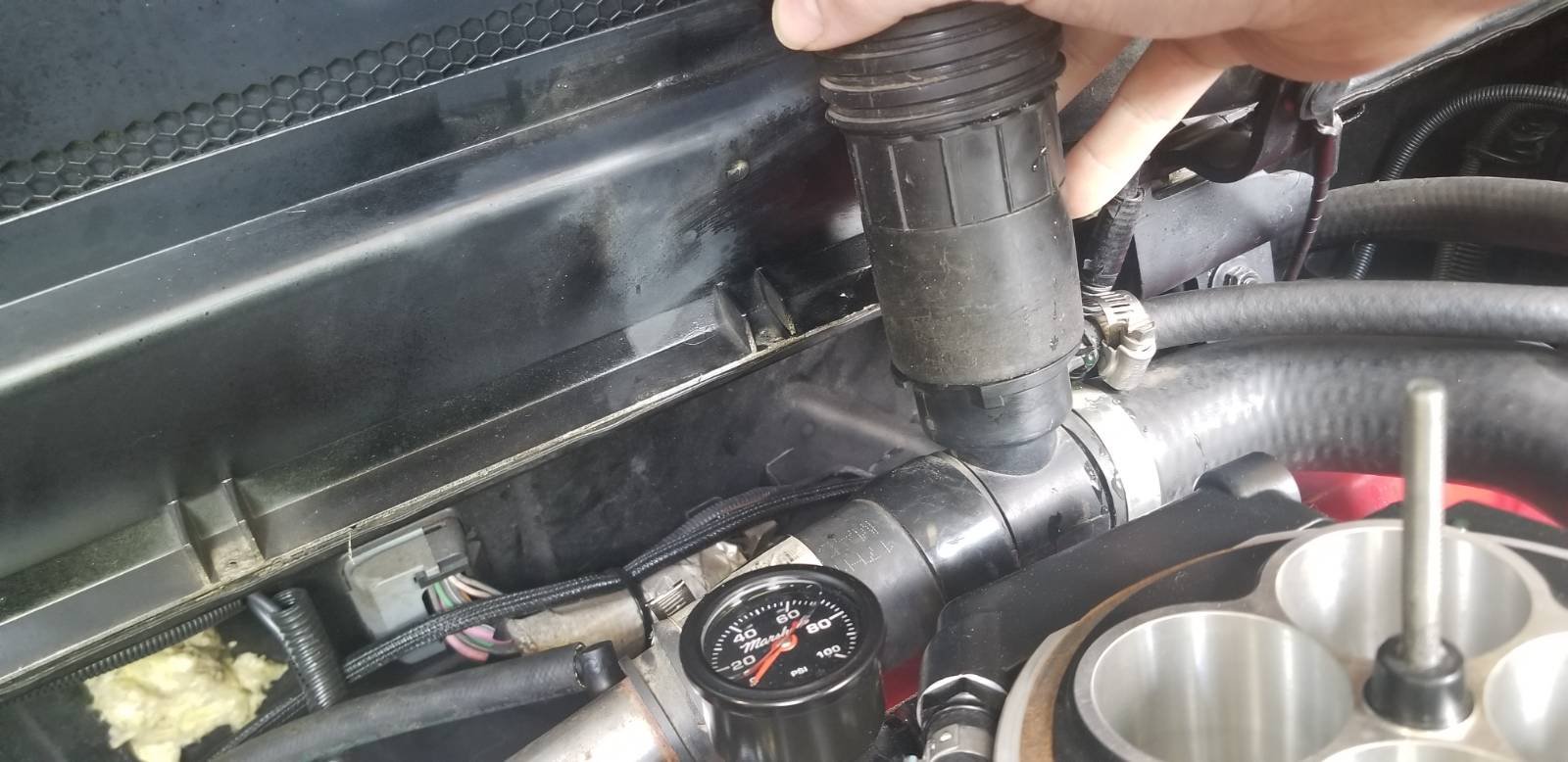

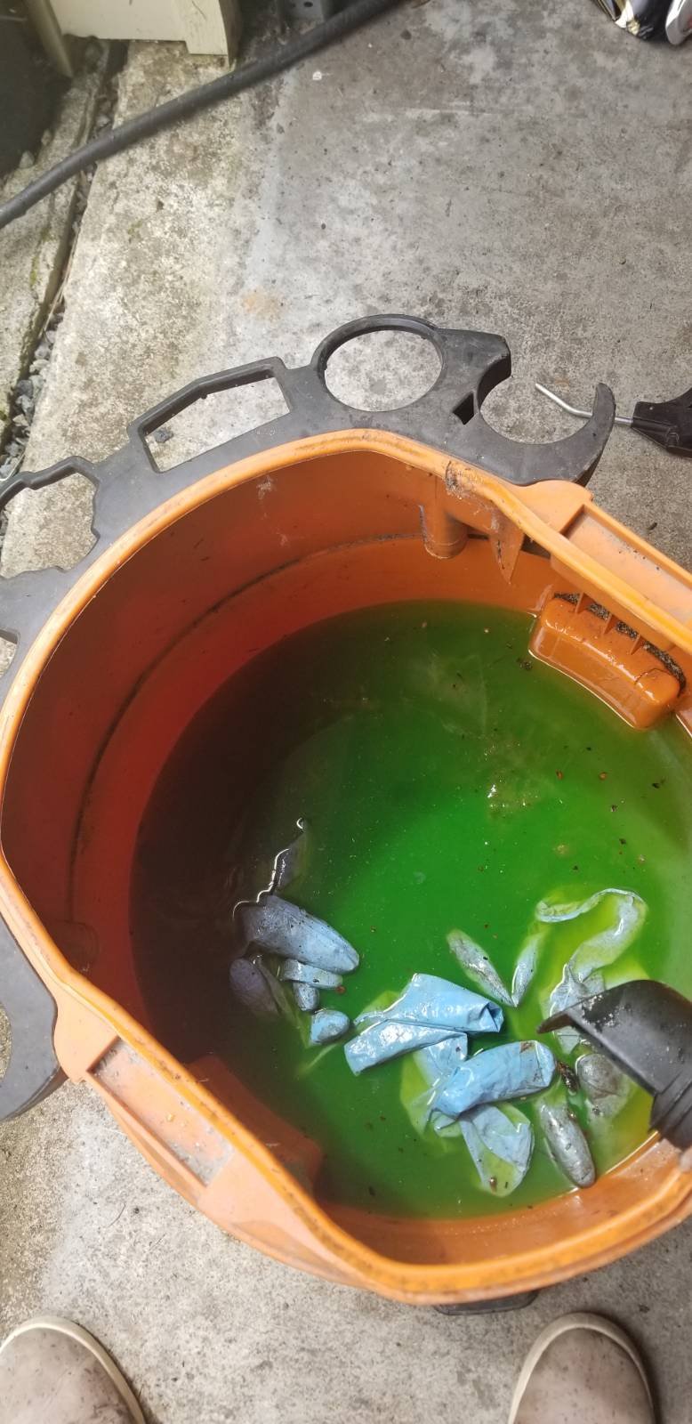

First things first... Do you hate coolant messes? I do. So we need to get the coolant out of this thing. Draining the coolant sucks. You know what works awesome though?
Ye Olde Home Depot 6hp shop vac will happily empty your cooling system for you. Just put it to the fill port and let er rip. After a minute or so, go up front and crack the radiator cap. No mess!

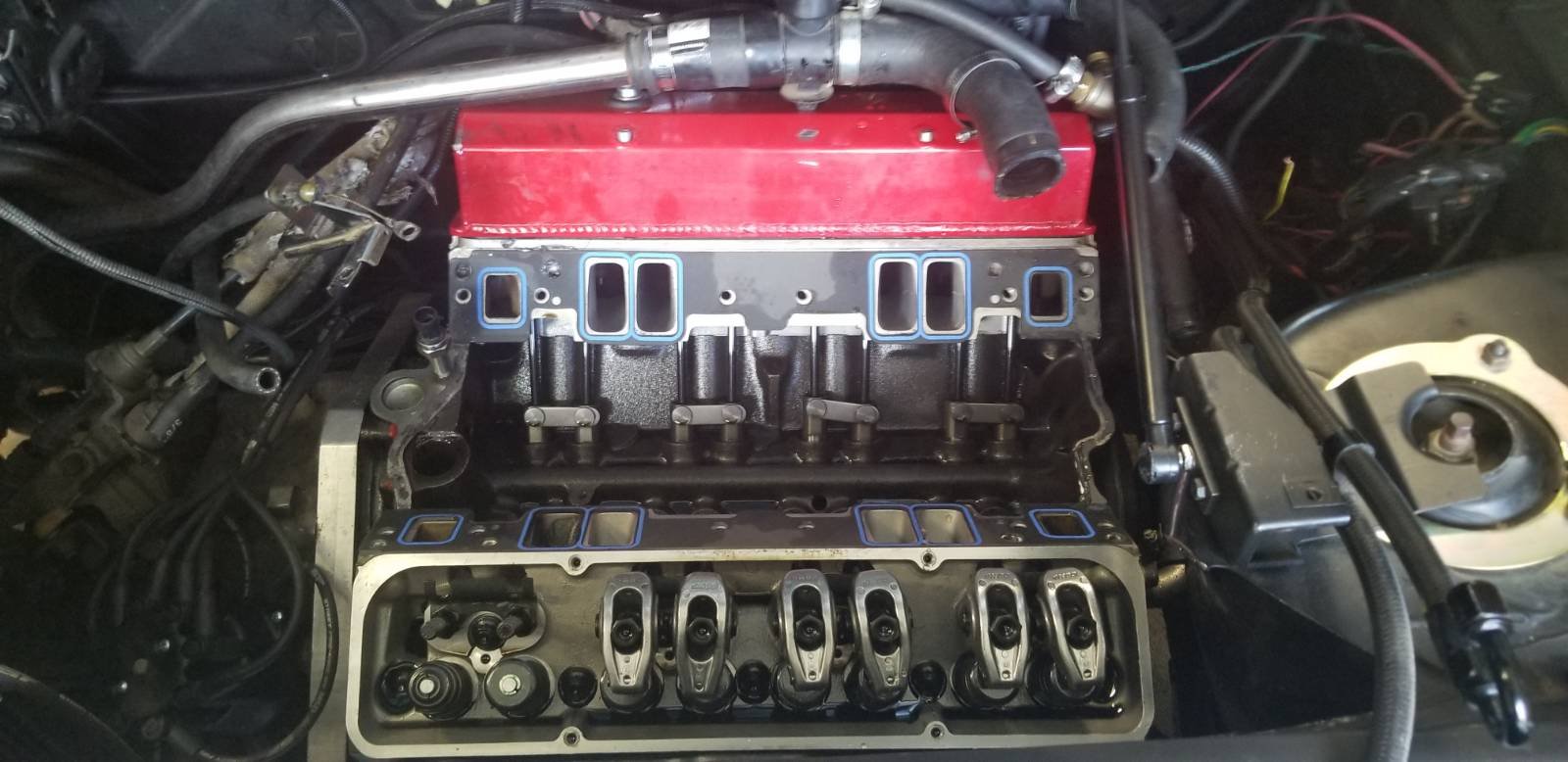

I'm sure many here know this already, but it's always worth saying: Plan your wire and hose routing ahead of time! Smartly laid out routing makes the difference in being able to take things apart in 15 minutes or 2 hours.

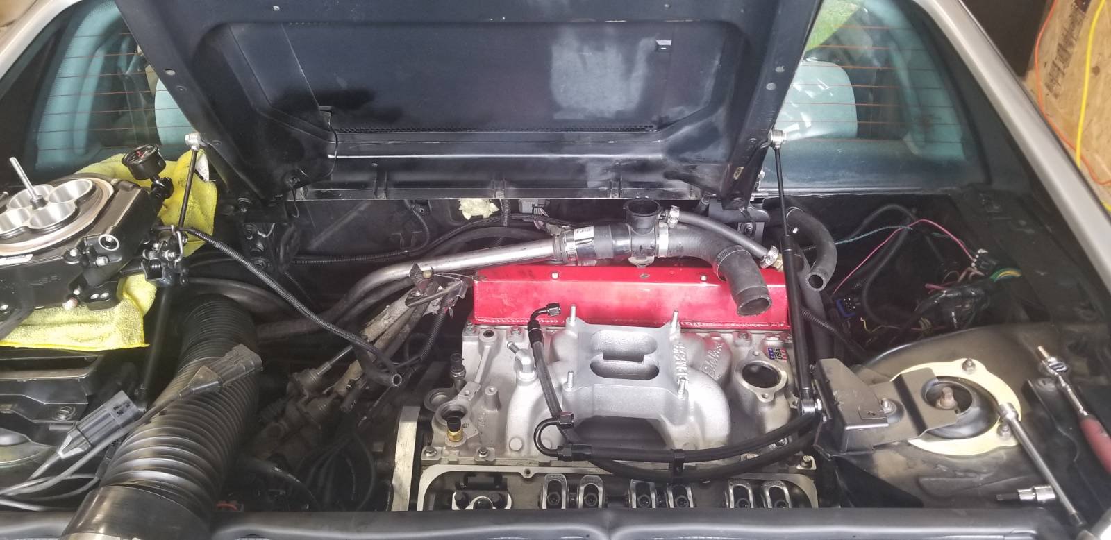

EFI Off:

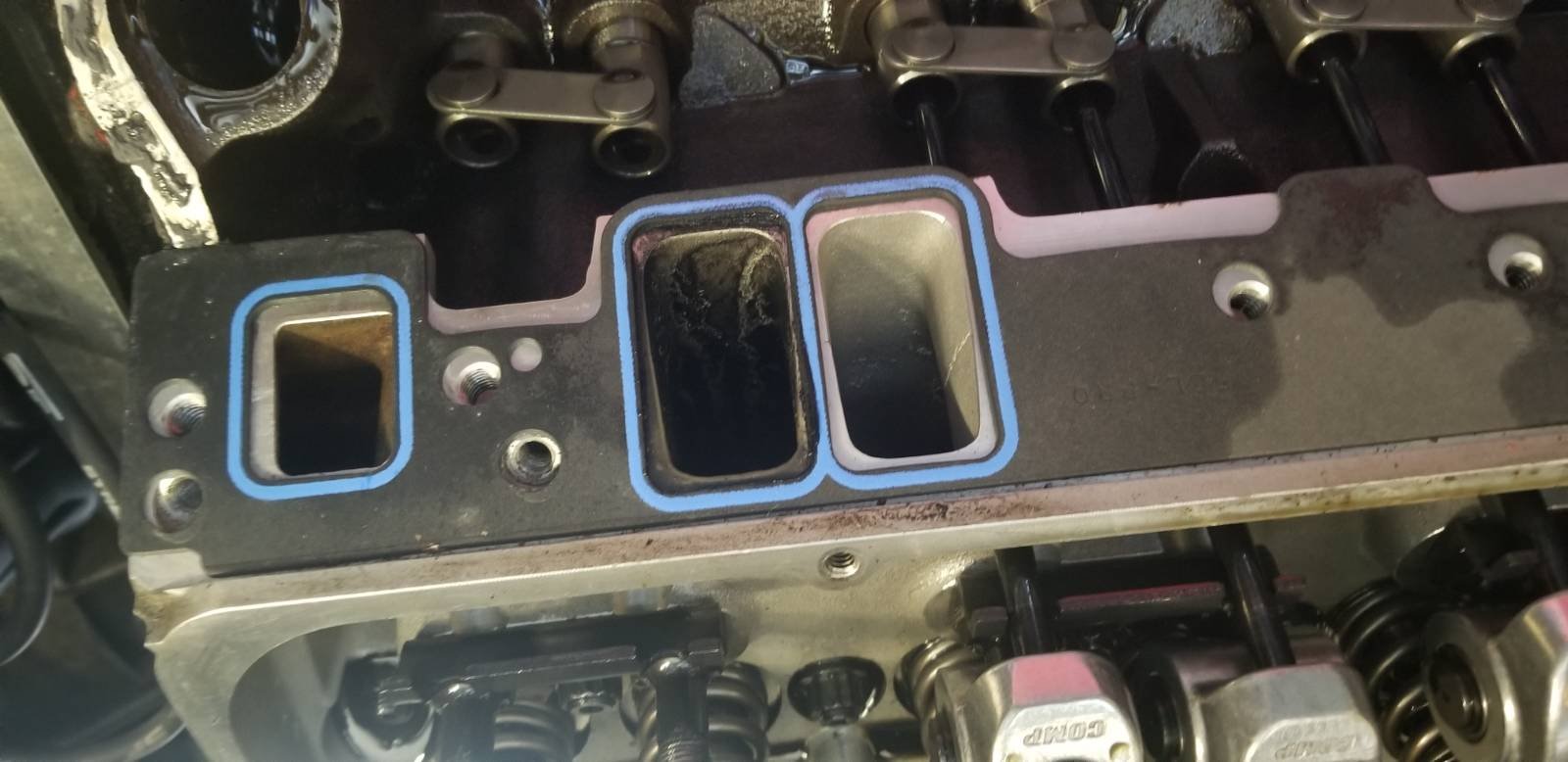

Intake manifold Off:
We can see #8 intake is carboned up from reversion since the exhaust valve wasn't closing.
We'll just leave those down there for now.

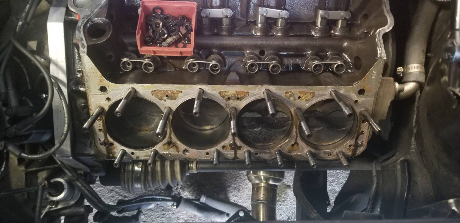

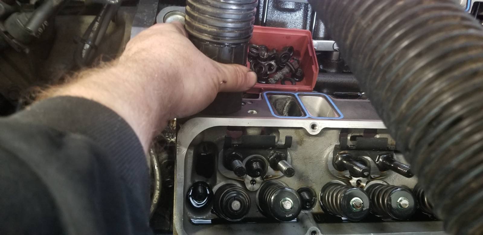

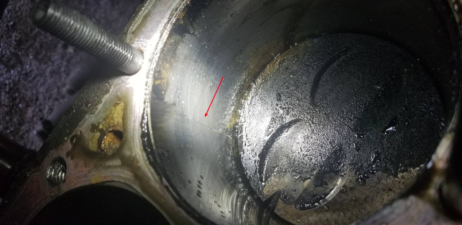

Head stud nuts off. Let's make sure we're dry inside.
Hmm, no obvious signs of gasket failure from this side. #8 doesn't look great though.
Let's look closer...
Aaaaaaaaand...
Oof.
I guess this is going to turn into a REBUILD thread now.

If I can get a quick turnaround from the machine shop, I can get this block back in service with a little more compression as well. The problem here is this block is 55 years old, and I can't figure out what caused the cylinder crack other than metal fatigue. I'm concerned this one has just lived its life.
