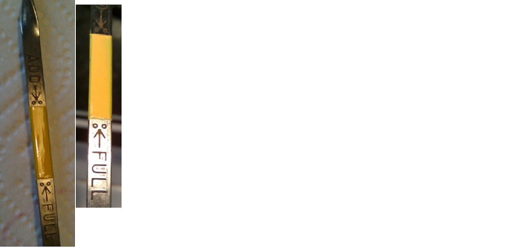

Cliff, you could try this idea. I did it when I had a 2.8 but it'll work on any dipstick. White paint may show better but yellow was all I had at the time.

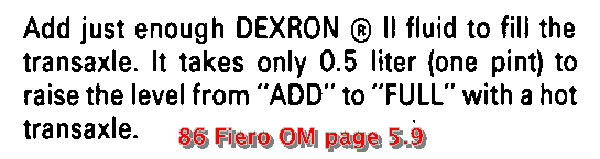

| quote | Originally posted by RWDPLZ: For future reference: Most dipsticks, between the full and low marks, is 1 Quart. |
⚠️ Only for Engine Oil. Not for GM and other AT units.
Many AT dip sticks are even Labeled "Add 1 Pint or 0.5L" (Full size is 2523x762 and is a Macro Pic of a 87 AT dip stick.)
 | | CLICK FOR FULL SIZE |
Fiero OM and says...
 Exact conversion is 1 pint = 0.473176
Note: If you drive a long time on a highway etc or have TCC problems then Oil can be Too Hot to check. OM and other says...
My above directions is add 1 pint of AT oil to a cold car until you read oil on the stick or be closer to Add zone when have above problem. In Fiero and similar... Fill cold to numbers in Add direction. (this includes refilling AT oil after changing or other work.) Depending how low could be 1 q/L or even more but only fill 1pint/0.5L then check. Should still read low but then safe enough to drive so can check and fill a hot trans.
Otherwise you overfill and cause other problems. Overfill can cause Oil Foaming and the trans will suck air w/ oil...
