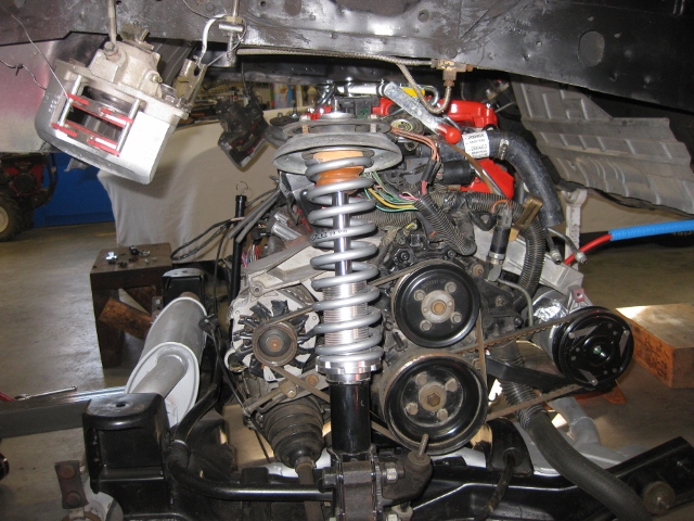

bjc 350 FEB 13, 05:24 PM
As you can see in the picture, there is a jack stand where the 4x4 would sit. Also a jack stand on passenger side, out of the view of the camera. I added two jack stands to the rear of the car as soon as the engine was positioned under the car.

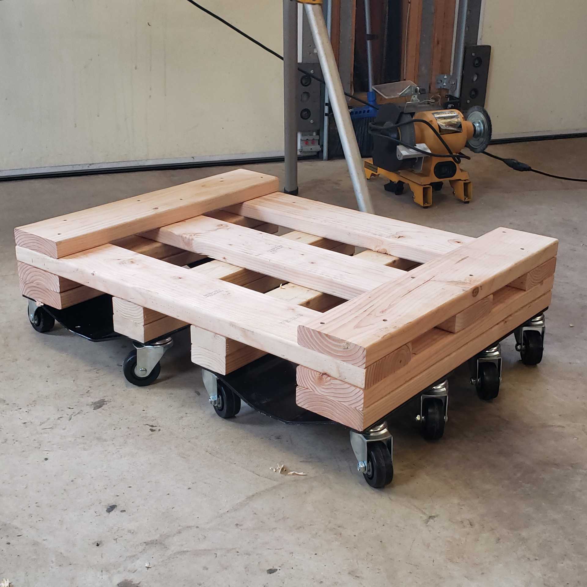

oneinch FEB 14, 02:56 PM
TODDSTER's cradle cart design sure is beefy. Just finished mine. I used car skates instead of casters. Overkill, but I'll reuse the skates under my cars as they're intended to be used. Anyone planning on building one of these I would suggest using 2x4s. They'll be plenty strong and cut the (wood) weight by 33%.
