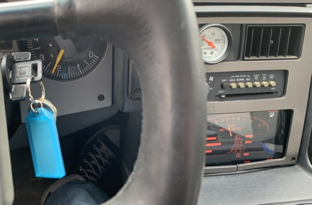

I don’t monitor egt yet, but I’m pretty religious about watching and logging afr. I try to stay cautious with it and timing, especially around peak torque.
(Apologies for the glare)

I'm enjoying that display at the bottom of the center stack - is that a shadow dash?
Honest Don JAN 14, 07:15 PM
Raspberry Pi. It’s pretty useful
