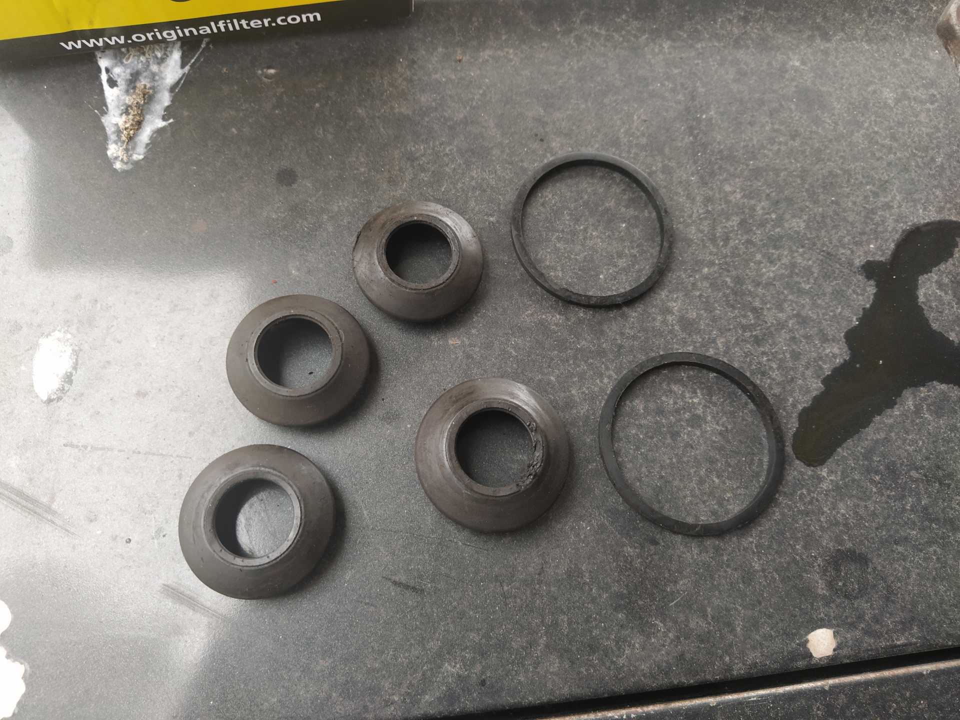

Save friends, the Fiero problems started, I need this repair kit (rubbers) for the brake caliper, some indication of how I can search, a specific name maybe. Thank you very much in advance!!!

That doesn't look to me like an original Fiero brake caliper. I wonder if the previous owner installed brakes from some other kind of vehicle.
Is that from the front or the back? The Fiero rear calipers have the parking brake, which makes them complicated and difficult to rebuild.
You should be aware that Fiero brake calipers are difficult to come by, even here in the US. One source for them is https://www.fierostore.com/ The Fiero Store can be expensive, but they have many parts that aren't available anywhere else (and are nice helpful people too
I hope that comes through the translator okay!

Hello friend, how are you? I hope well. They are the rear ones, they were disassembled for repair, but as there are no rubbers here, I picked them up again, they have the hand brake activated.

I managed to find what I'm looking for, thanks for the indication of the site. Let's see if it gets here in Brazil.

Can you post photos of both sides of the assembled calipers? Also, do you have a photo of the brake caliper on the automobile?

That is an 88 caliper with the bridge (outer half) removed.

Here is a post of how to rebuild the 1988 calipers- especially the rear with the extra seal. It has the Centric Brakes part numbers also. (Main 1988 caliper kit Centric PN; 143.62031......Extra Internal seal for 1988 rear Pistons contained in Centric kit PN; 143.62008
http://www.fiero.nl/forum/Forum2/HTML/137765.html[This message has been edited by cvxjet (edited 01-28-2021).]

Apologies, I forgot that the '88 brakes are different.
