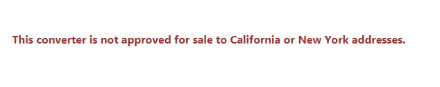

Remember, this is California. From that same webpage on Rodney's site:
