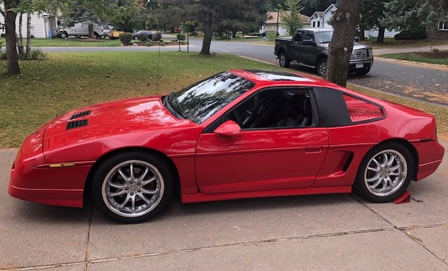

Today at the suggestion of the previous owner I re-installed the stock Eprom in the ECM. Then I started the car, warmed it up and confirmed the base timing was still at 6 degrees BTDC (EST wire disconnected). This was followed by a test drive. My V8 Fiero now runs fantastic. It lost maybe 5% of peak horsepower (butt dyno), runs 20 degrees cooler, there is zero hesitation under hard acceleration in all gears and it never back fires!
The car is now fun to drive all the time. I don't think it's worth it at this point to get a new tune. That's the latest update, thanks again for all the forum member input. DP

Nice looking car!
