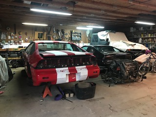

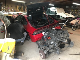

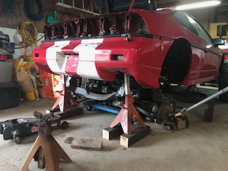

There was an incident with the car earlier. My dad and I were both home early, so we figured we should work on dropping the cradle.

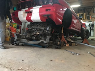

So, we had to jack it up high. Our garage is technically a pole barn, so we can't use any sort of chain from the ceiling.
Inched it down some more. Nothing was hooked up, and just had to push the harness out of the fire wall to get it unattached from car. We started to have some issues with clearance here. We had some 4x4s on the jacks to get the car up higher to clear engine. We were able to squeeze the engine out, but lowering the car would end up being the issue.
My dad and I had to try and lower the jacks at the same time from each side. Well, one let down a bit quick and the 4x4 slipped, and the car toppled. I am a) glad my dad and I figured this would happen and were out of the way, and b) glad the car toppled the way it did, as if it went the other way, it would have messed up my other Fiero. The red car does now have a cracked rear clip, side skirt, and the trunk is busted.

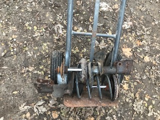

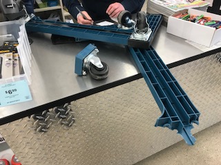

This was unrelated to the fall, and you can actually see it broken in pictures previous, but my brand new dolly broke. Harbor Freight took it back no issues.

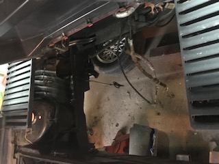

Somebody beat the crap out of the rear suspension.
She lost some weight!
Now to start tearing into some engines, and figuring out which one I am going to rebuild...
[This message has been edited by copperhens (edited 11-12-2018).]
Spadesluck NOV 13, 12:10 AM
Glad no one was hurt. A cherry picker would have worked out with better results if you had one.
