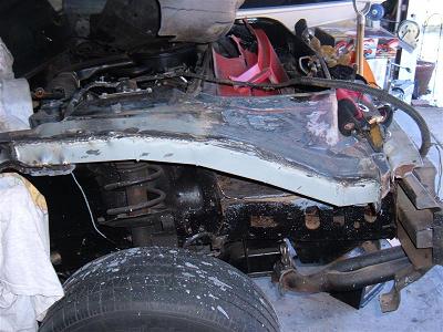

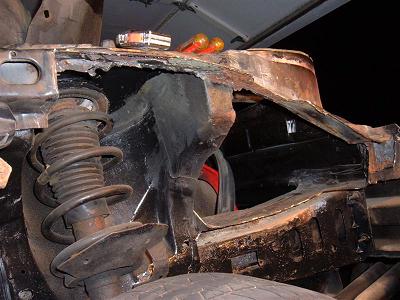

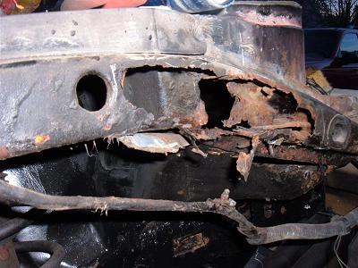

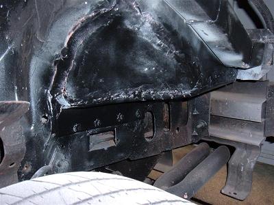

ltlfrari AUG 06, 09:22 AM

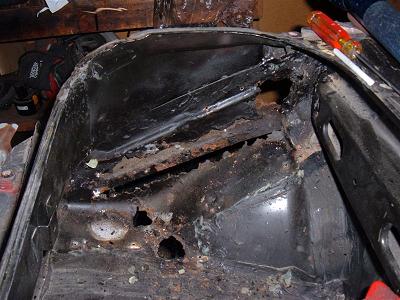

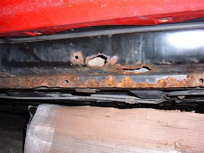

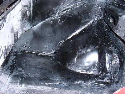

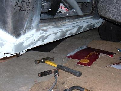

Mine was similar but maybe not tat far gone
Upper frame rail on driver's side
Trunk corner
Rockers
Cut out the rot
Make new rail from box section and weld in
Ditto on rockers, this is the pass side which was much worse then the driver's side above. I sem to recall I just patched the driver's side but this side was gone.
I used what was left of the old trunk corner and some sheet metal to replace the driver's side trunk
Overall it saved the car, or at least kept it going for a few more years. Sold it a year or so later as it had lots of other rust issues and really wasn't long for this world.
I enjoyed doing it as I'd never done that much frame/metal work before but honestly, I wouldn't do it again unless the car was really special to me.
Yours looks to be in much worse shape overall so personally I think you'd be better off finding a better starting point and parting out what you can from this one.

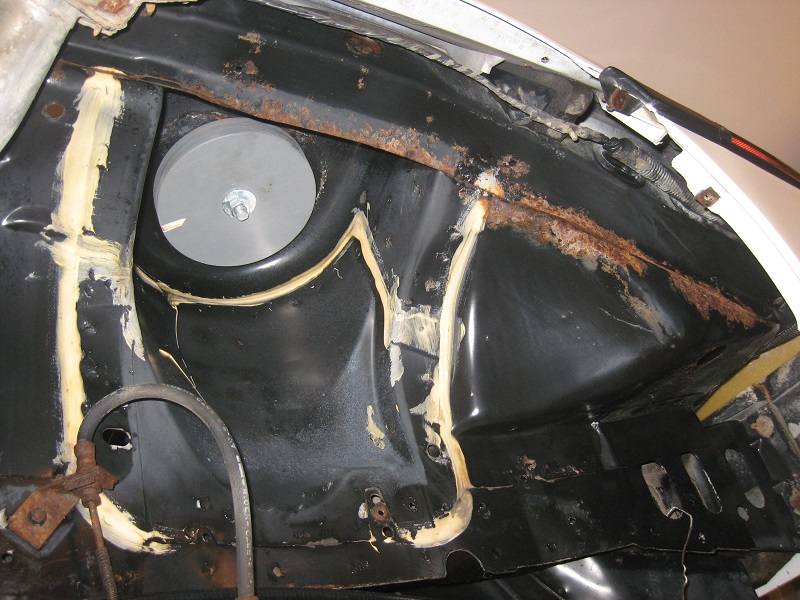

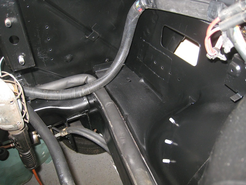

Here is my $2200 CAD Fiero (this one happened to be 1/2 hour away from my home in Grand-Mère):
Not bad, I got away with three small patches in the trunk, one patch near the battery, and a battery tray replacement. It really didn't need much.
Here we can see the small battery tray area patch I did:
You can get decent for cheap, but I can't say I fully agree with the "scrap it it's rusty" mantra we have here. If we always apply this mantra, well we're encouraging our favorite cars to be scrapped. At some point, to prevent Fieros from going extinct, they must be repaired.
