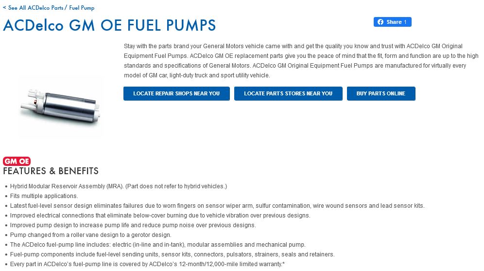

Actually, it's a fuel pump specific thing. The earlier years originally had pulsators installed as well. I forget the name of the style of pump from the factory, but a pulsator was required to reduce/eliminate pulses in the fuel pressure. The newer style fuel pumps don't produce these same pulses in fuel pressure, therefore pulsators have mostly become redundant. That's what I've read here over the years anyway.
They changed from a roller vane design to a gerotor design.
https://www.onallcylinders....t-fuel-pump-designs/

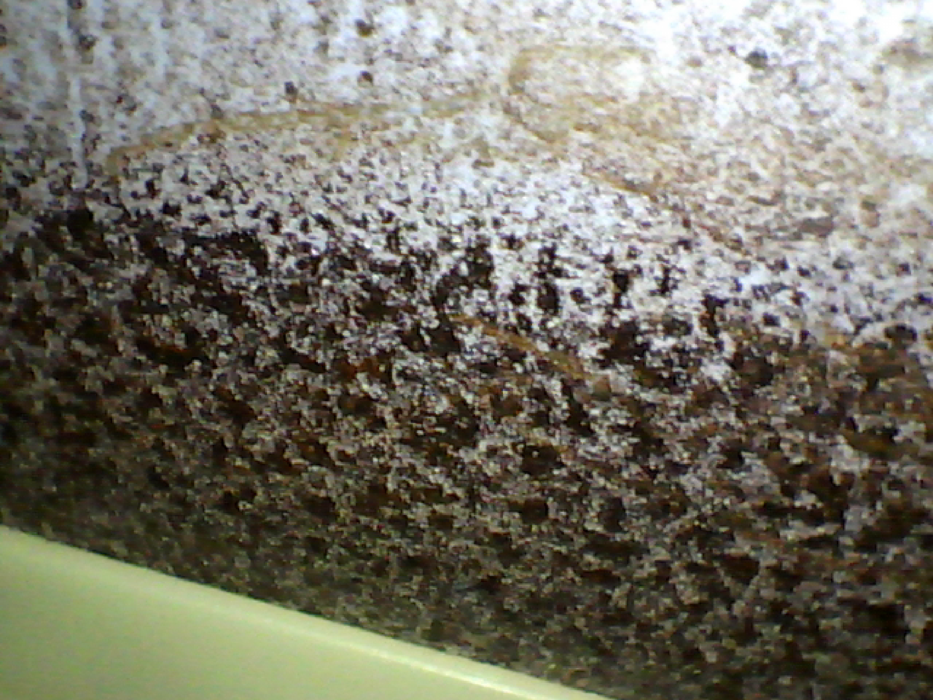

I reran the tests, still had the fuel pressure drop problem
I replaced the fuel pressure regulator with a spare used part, inspected it carefully, looked good. No change to the fuel pressure drops. I figured this left only the hoses or the pump.
I removed the fuel filter, and noticed some rust-colored gas pouring out and some rust in the filter. I finally got a borescope, and took this picture inside the fuel filter:
I dropped the fuel tank, and noticed rust on the inside of the tank, and sediment in the bottom.
I am assuming that the pump is getting clogged with that rust/sediment.
A crusty old car guy buddy suggested I use something he called "sloshing compound" to coat the interior of the tank and seal the rust. Is there a modern name for this, maybe a product recommendation?
