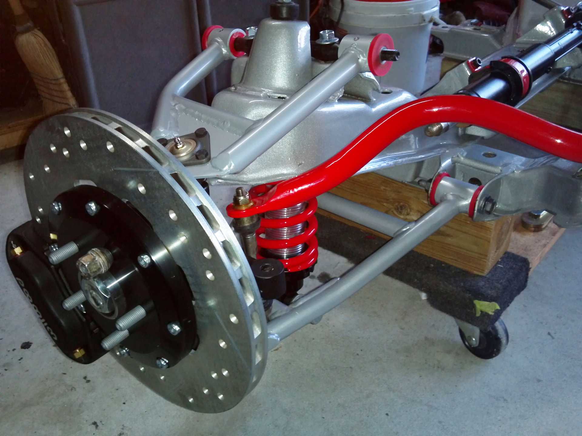

How come your 88 front suspension looks different than mine? Looks more like a 84-87 front.

Looks the same to me, but they just cut away all the old spring stuff to save some weight. I confirmed today that the front bearings appear to be OEM 88 bearings.
wftb
JUN 12, 07:34 AM
All the Ryane/Held/Arraut drop spindles and spindles from their complete front end kit used 88 rear wheel bearings. Cutting away the upper spring perch and putting the upper spring mount where it is allows the use of a wider variety of shocks. The stock shock that came with their kits only give 4" of shock travel so unless you do a mod like that you will break shocks when they bottom out. Even the sport front end kit for the 84-87's has that problem. ------------------ 86 GT built 2.2 ecotec turbo rear SLA suspension QA1 coilovers on tube arms
