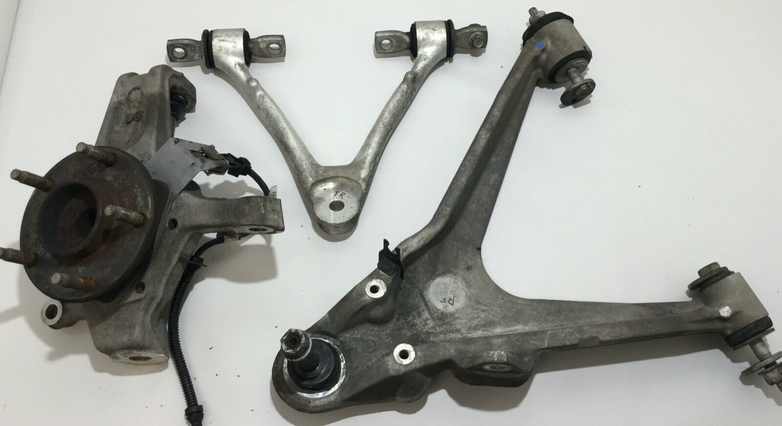

and someday i'll get my hands on this stuff and see if I can use it.

I was hoping the Buick you have been getting parts out of would have the hyper strut but not the case. The steering rack and its placement has a lot to do with bumpsteer and if it isn't right it will upset things.
Over all, the older cars as they first came out with skinny 13" rims and narrow tires did not have enough bump steer to worry about. And the early tests do not even mention it. Going up to 15" wheels and wider tires made it more noticeable, as wider tires tend to follow road imperfections. As has been mentioned, the tie rod is too long but the worse thing is it is also in the wrong place on the cradle.
The thing I do not like about using an alternate spindle is they are always from the front of a front drive car so there is no parking brake. So for now I will just stick to a stock rear spindle with my home made SLA suspension and bumpsteer bracket. edit to add link to my bumpsteer bracket thread
