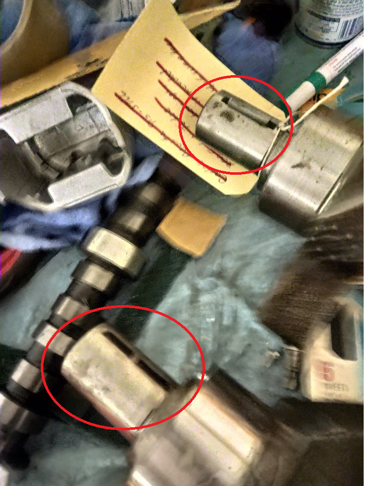

Cunnive SEP 11, 08:04 PM
Hey hey!
So I got my replacement crankshaft from this link https://engine-parts.com/pr...2-8l-crankshaft-kit/
and it looks good but I noticed something that I wasn't sure about and wanted to ask yall
The top crank is the old Fiero crank while the bottom one is the new one. It doesn't appear like that part is held in by anything other than friction so would I be able to just pull/wedge it out?
If so - anyone got tips on removing the pin from the old crank and installing it on the new one?
Thanks!
