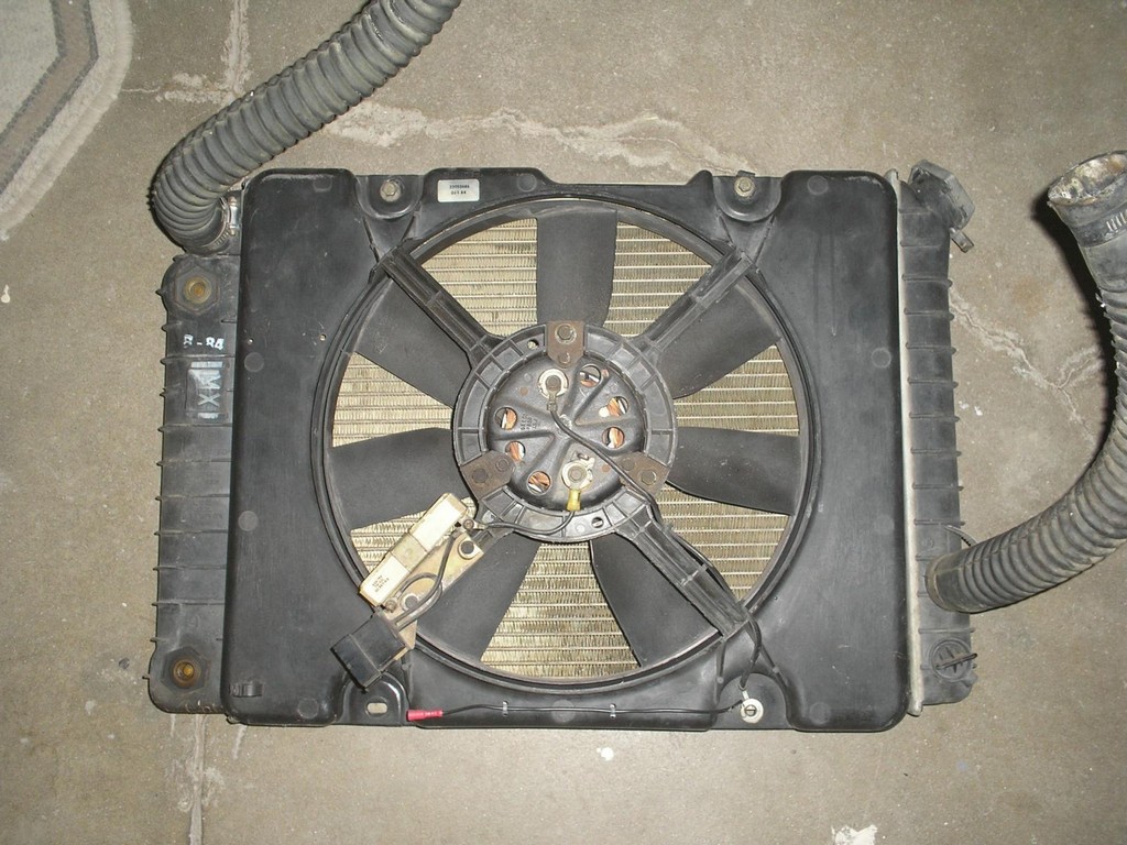

Only the 84 Fiero has a 2-speed fan arrangement.
That could be a problem. It has the fan from my 87 in it now because the stock one was seized.
olejoedad MAY 15, 11:59 AM
Not a problem.
Does your fan have a resistor mounted to the shroud?
fierosound MAY 15, 03:01 PM
Not a problem.
Agreed. Not necessarily a problem.
May just not be wired right for 2-speed fan switch on engine.
Did you transfer the white resistor to the fan you installed?

luso31893 MAY 15, 04:10 PM
From what I remember, been over half a year, the old one didnt have that on it. Maybe the old owner had it swapped at some point too. Is there a way for me to either make my own or buy one and add it to my current fan?

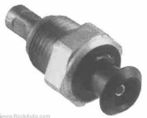

Figure out what you have for a radiator fan and fan switch on the engine. Pics?
We have to deconstruct what the previous owners may have been thinking and done.
It may have already been changed to a single speed setup using a one pin fan switch - which is FINE.
With Key On and A/C Off, if you ground the wire off the fan switch and fan comes on, wiring is OK.

Okay. I confirmed that I have no resistor on either fan housing that I have. Grounding the sensor and pics of that will have to wait till at least monday as I work weekends still.
luso31893 MAY 18, 02:13 PM
The sensor that would be for the fan that is in my car is a 2 terminal one. I take it that's for a 2 speed fan?
luso31893 MAY 18, 02:25 PM
When I short one of the 2 wires, I can hear the relay click on but the fan doesnt spin up at all.
fierosound MAY 18, 02:46 PM
Time so see what's happening at the radiator fan relay.
You want grounding of LT Green/Black wire to kick the fan on High Speed (since fan has only 1 wire to it)
Power Wire on fan should be to Terminal A on fan relay.
